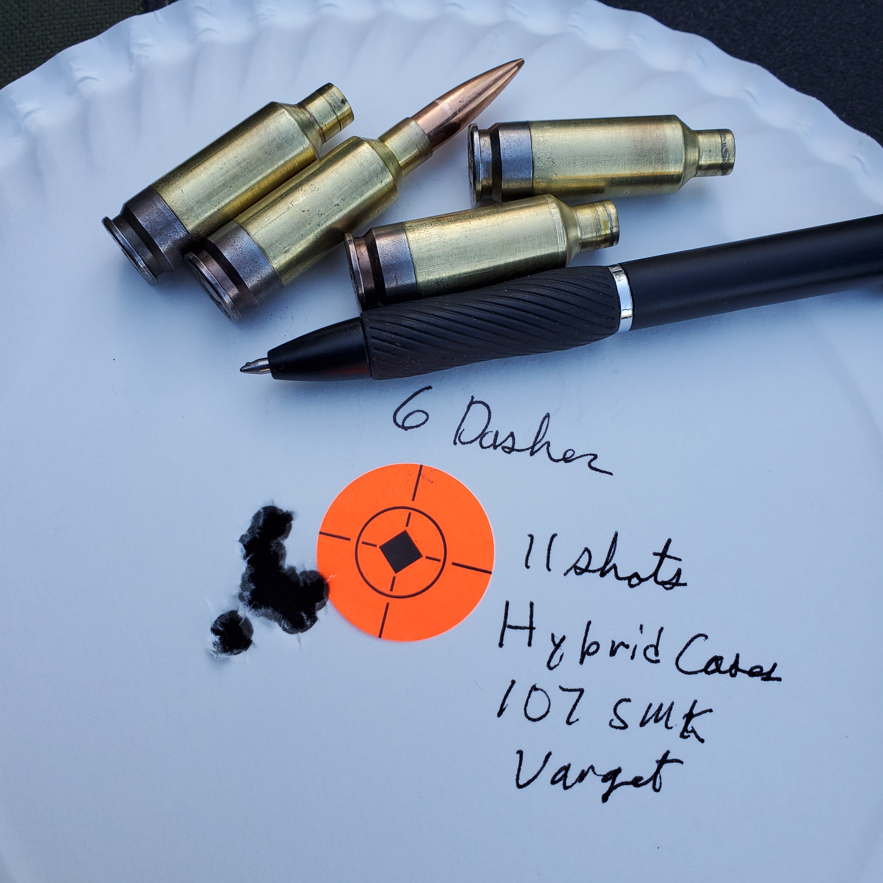

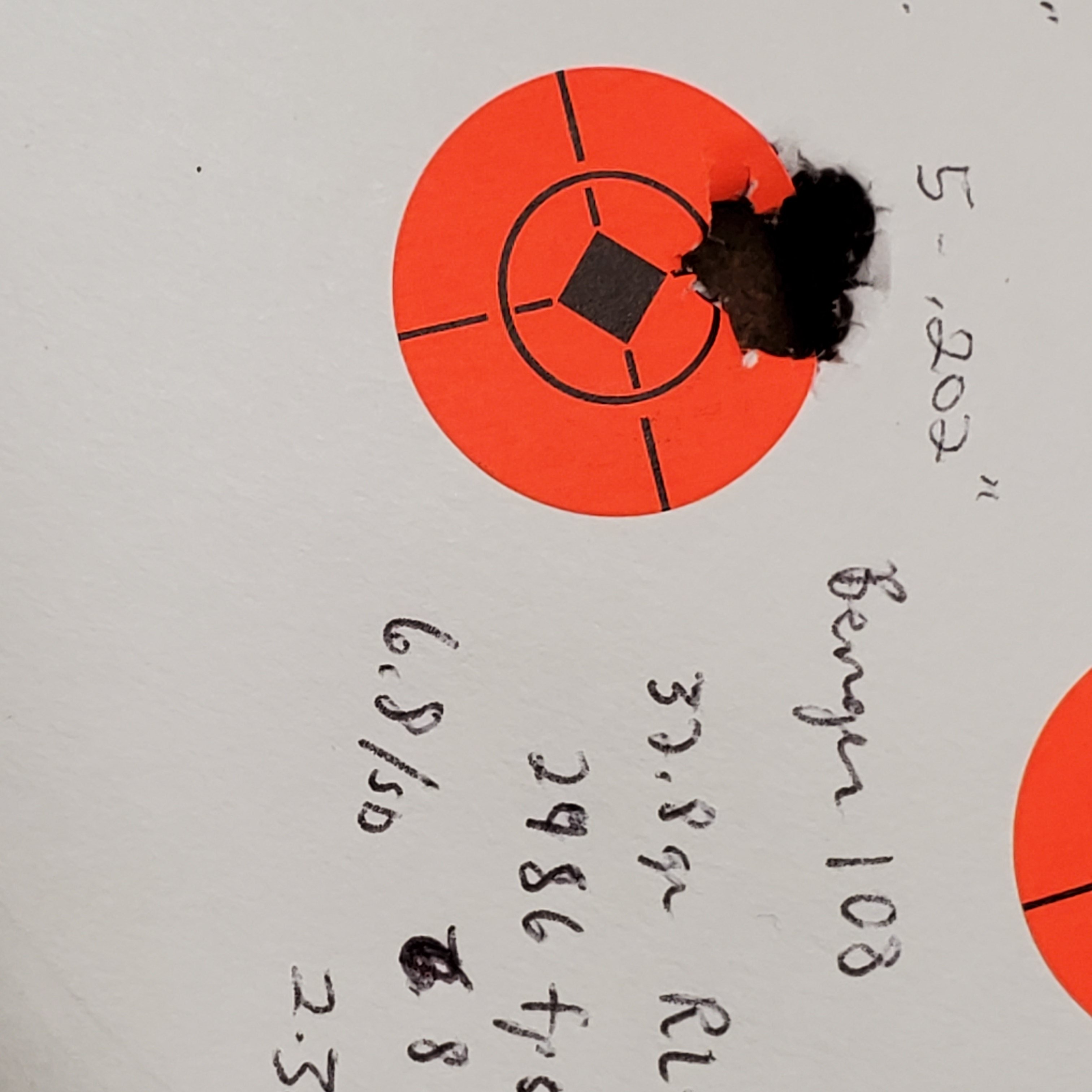

I just shot my 6 Dasher yesterday.
Fireforming hybrid cases.
107 SMK, varget, and hybrid cases 3060 fps ave. 11 shots. Change powders and it will do 3200 fps with 105 gr.
Run fast or run slow the 6 dasher is very accurate, even fireforming hybrid cases.
It's more accurate than I can shoot.
And works with 55 gr to 115 gr over 3000 fps, liking the 58 gr vmax at 4100 fps..
A very versatile and accurate cartridge, with alot of combinations.

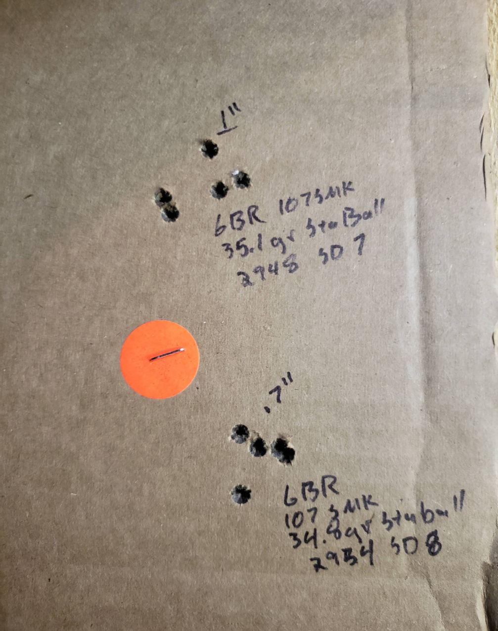

I really like the GT.. I’ve developed some fantastic rounds using my 550 Dillon and using volumetric powder throw with 6.5 Staball… no trickling for me!!! So if a round can use Staball I’m in… photo is a 20 rounds group out of a Faxon barrel on a day with 15 mph wind… minimal load development. I’m taking a hard look at the 25GT as well now… alpha makes brass and seems you can get the 135s up to 2700 fps out of a 26” barrel with Staball… or going 25 Creed. But that’s a problem for future me. ATM I’m loving 6GT. 6BR will be great as well, but I hate tricklers….
I planned on using Varget for 6 BR, but in the event that I get tired of trickling in the future are there any ball powders that work well for 6 BR?
Stabal 6.5 works for heavies, gonna be starting around 37.5 and work up to 39-40gr. I'm sure stabal match would work starting around 31gr and work up.
Ball powders are known to have high temps instability, where as the stabal line is a lot better but not quite as good as most extruded. Those are the two I would recommend trying for all weather loads.
Staball 6.5 has a very similar burn rate, but it does much better when loaded to nearly case full. It is a ball powder but I have found it to be pretty temp stable. Maybe gain 20 FPS going from 60 degree morning to a 90 degree afternoon. I would def try it out, but I do not have a 6BR atm.
