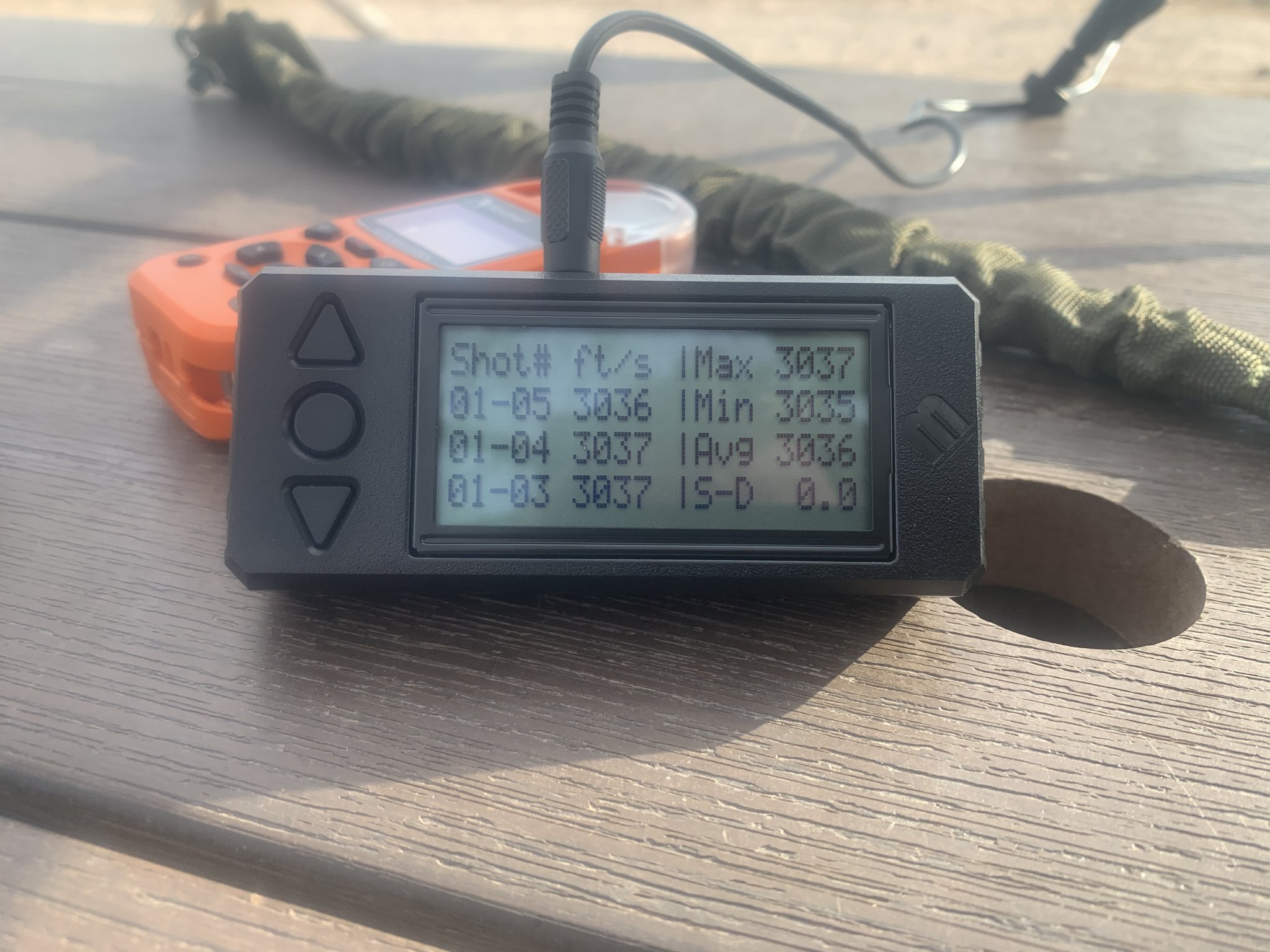

Range Report 6GT Project/Range Report

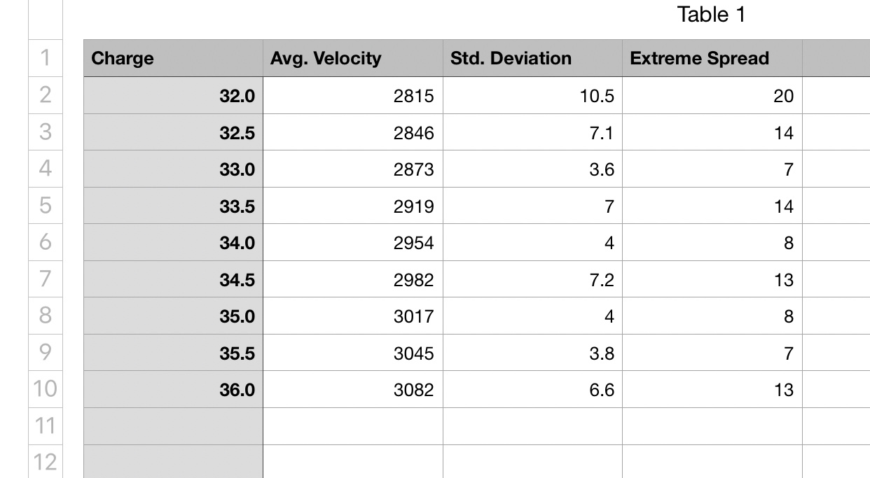

Velocity testing only. Will shoot groups this weekend to go along.
Hornady once fired. Necks were uniformed prior to first firing. 198 rnds on barrel prior to starting.
3 shots each charge over magnetospeed.
109 hybrids jumped .020
Loaded with fx120 v3 auto trickler to within .002 gr
Varget
Starting seeing ejector swipes (see pic) at 36.0.
Temp: 58
Light drizzle rain
Humidity: 82%
35 to 35.5 looks like the sweet spot.

Here is 34.0 with virgin brass and barrel.

I’ll have some virgin alpha brass velocity data with 109’s and varget tomorrow. 32.0-36.0 in .2gr increments. Normally I stick to .5’s, but I need to get about 250pcs fired for a match next week. Might as well break the data down further.
Just in brass prep, I’m seeing pretty noticeable consistency differences vs hornady brass.
Alpha neck thickness is more consistent and not tapered like Hornady
When prepped the same I’m seeing about half the seating pressure ES in alpha vs Hornady. Alpha ~10-12psi and Hornady ~20-25psi
Alpha seems a bit harder than Hornady. I have to go a little slower in my Giraud when initially trimming to uniform length.
I’m getting low two digit and single digit ES with hornady brass. Worst being 20fps ES.
Based on what I’m seeing from brass prep numbers, Alpha should at least be that good.
Reactions: Tx_Aggie

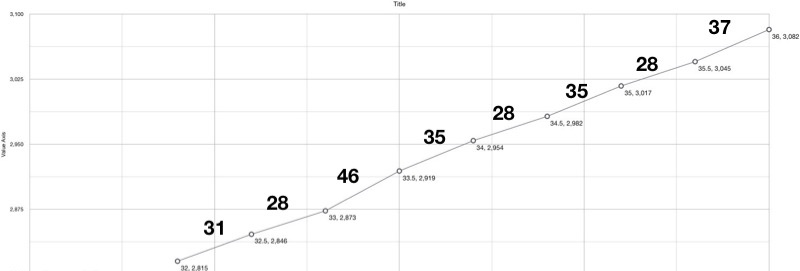

What was your ES like? Here is my once fired hornady data. But I take brass prep further than I need to.
Large numbers on graph is the fps difference between charges.
10 rounds with 34.4, 2878 avg, 2885 max, 2868 min, es 17 and sd 5.0. I did my latter test with less than 100 rounds and decided to go with 34.4 as the charge weight. I now have 280 rounds down the tube and its moved up a little in speed to 2891. All done with virgin brass. Strelok pro says my BC is .31 and I'm at 715 yards with 4.5 mils. Barrel is PVA with no pressure signs, bolt lift remained the same and brass looks fine.

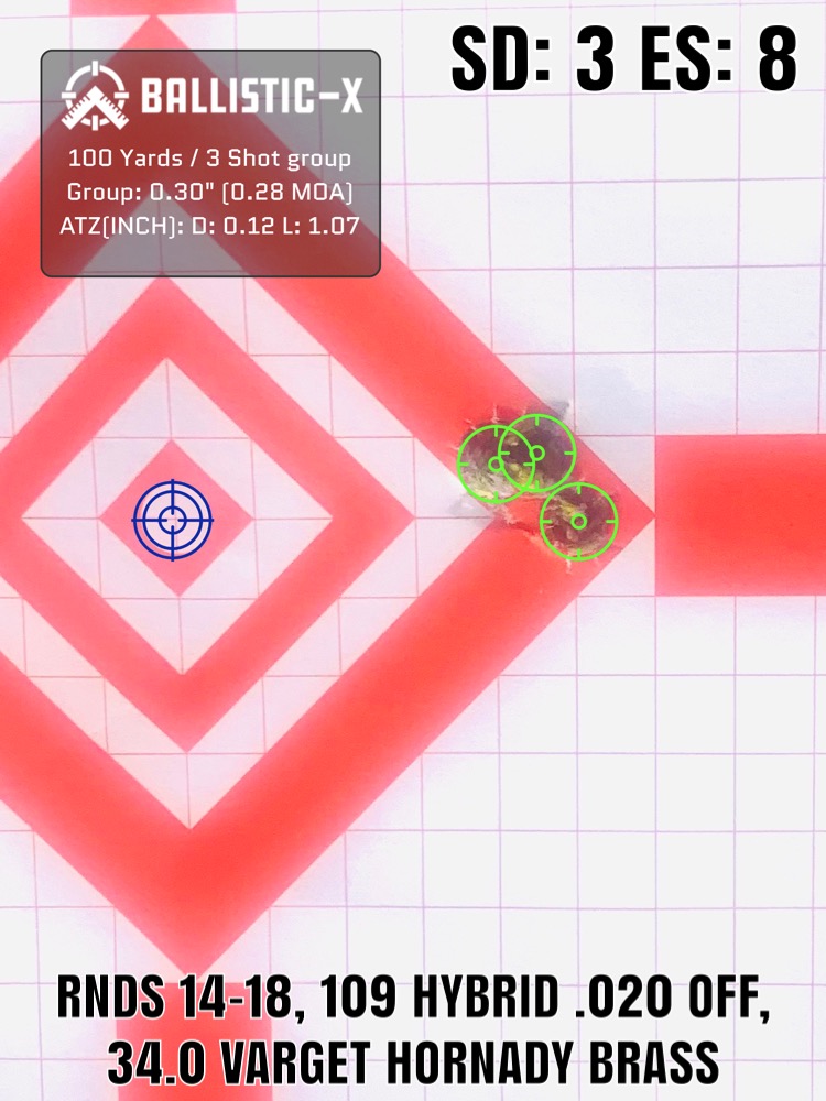

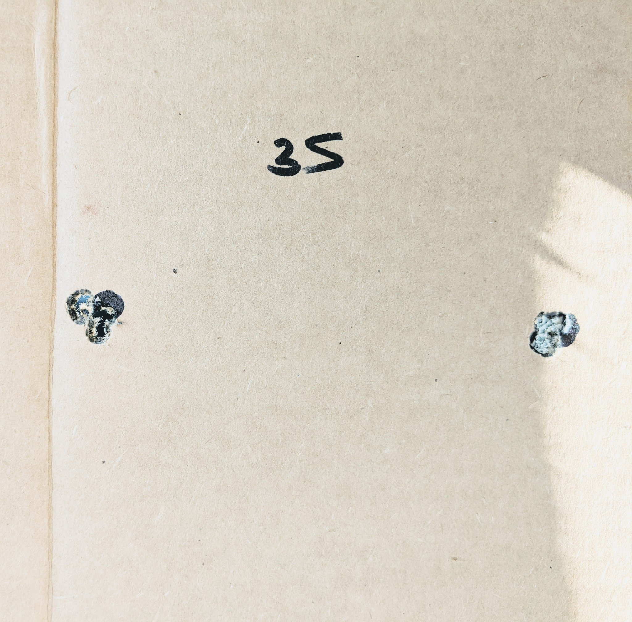

5 shot groups at 100yd
Im liking it
Here is virgin alpha brass. I need to get brass fired for brawl. So did 5 shot groups in .2 increments since I was gonna be shooting them all day.
26” 1:7 bartlein chambered by Enrique at Masseys Gunshop (@trophyhunter
All with varget and 109 Bergers .020 jump

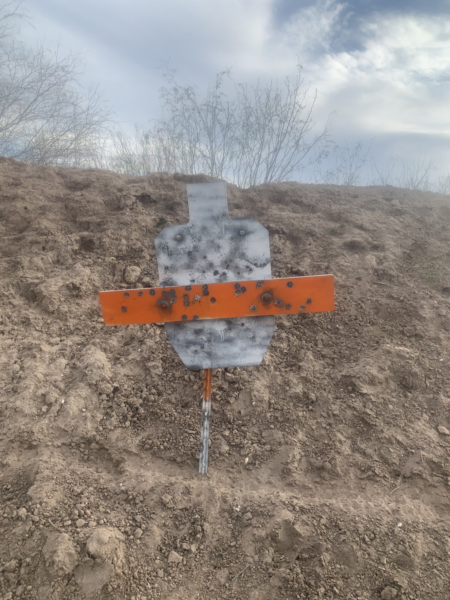

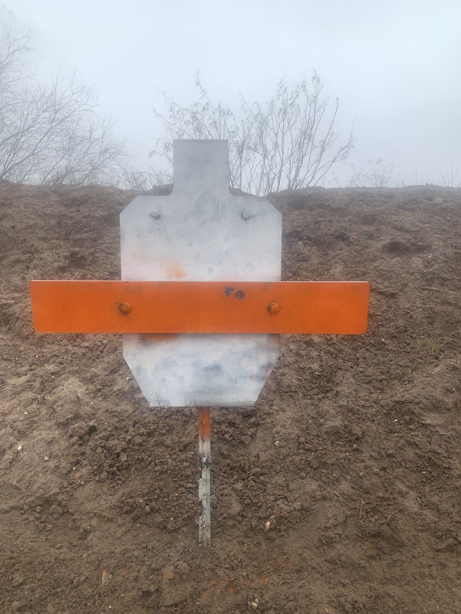

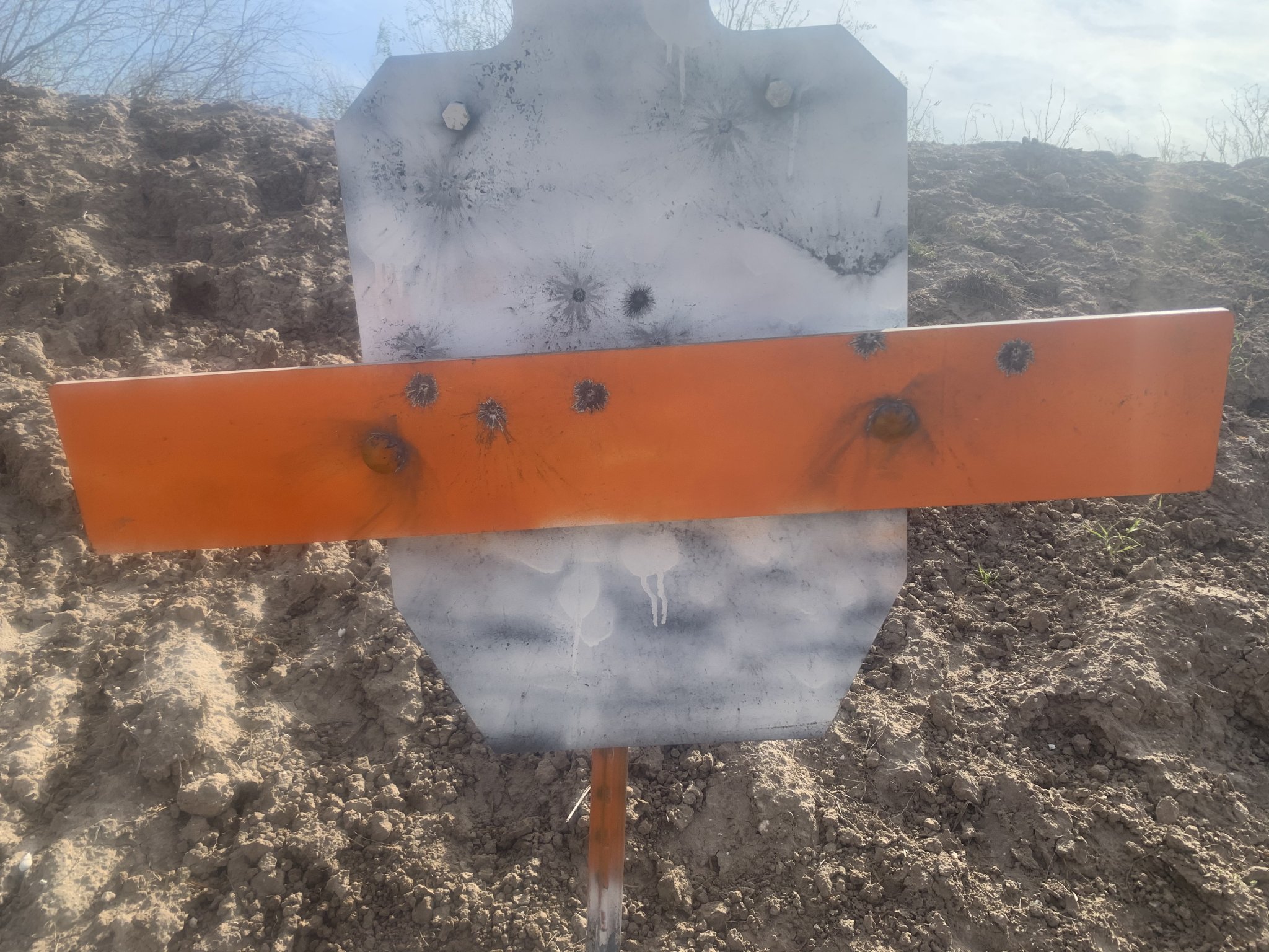

The truing bar is 34.0 as that’s what I run on virgin brass at matches. Wind was switching from straight up to 1.2mil. So only focused on vertical which was around 3-4”
Distance to truing bar was 933 yds

Also have found this to be a good training exercise. The velocity increase over time with powder charge makes POI move up. Also makes wind hold less. And I have a magnetospeed chrono bayonet strapped to barrel. So that changes harmonics/poi.
I don’t care what the groups are like at this point as I’m looking at chrono numbers for consistency within powder nodes.
So, I use it as atraining exercise. Set target at 900+.
On every trigger pull, pin the trigger back and hold until you
See the impact. If you hit, keep holding until you hear the steel ring.
If you miss, make them correction and go again
105 rnds of good training while collecting data.

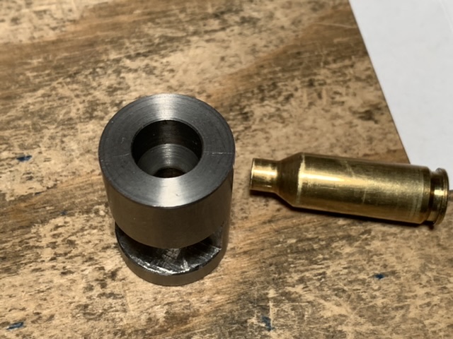

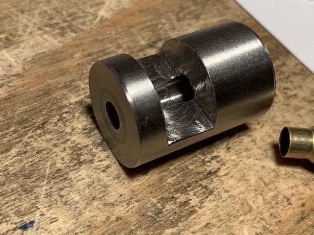

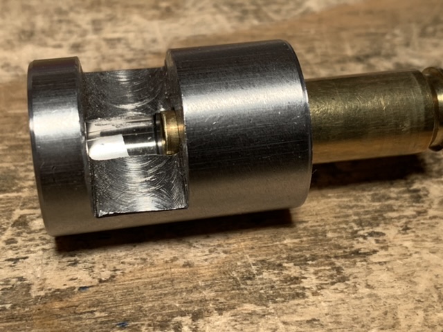

Grind or sand some material off the top of the shell holder, easier than removing marerial from the die. I had to do it to my 6GT die to bump the shoulder enough.
Be careful with this - I did same in a similar situation, and it weakened the shell holder enough that it bent when pulling a case out of a size die (not a stuck case - just normal sizing)
Checking dope for match this weekend. 933yds. That’s reason for only a couple shots as I’m in a crunch to get back and load 250rnds.
1x fired alpha, 109’s, 34.0 Varget. .020 off lands.
AB says it’s around 2950 to match their CDC.
I don’t chrono for dope as to not mind fuck myself before a match. So I’m not sure what the exact speed is. I’ll check next week.
Will have 700+ rnds on barrel by Sunday.

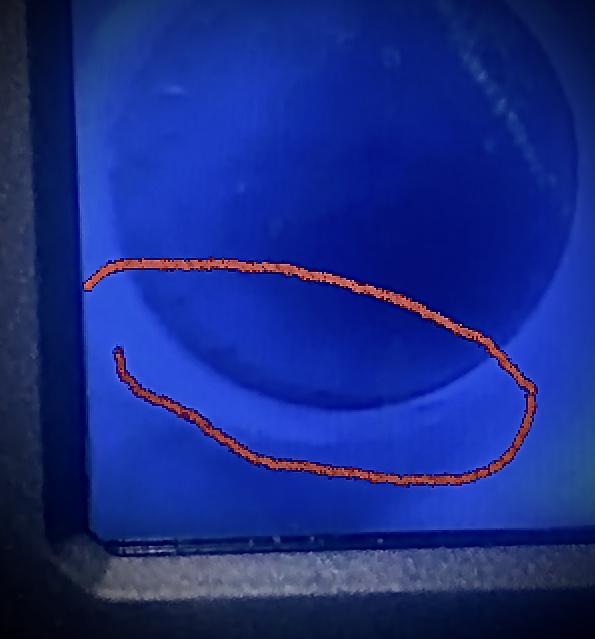

So, had some serious bolt lift issues that caused me to stop shooting a match over the weekend. Started out clicking and ramped up to beating my bolt open. Was running a mild 34.0 varget with 109’s at 2950 ish. .020 off lands.
After checking measurements and making sure my sizing die was sizing all the way down the base, I took ejector out of my bolt and noticed it would not close with just gravity like it should with a jump.
Pulled bullet and it fell closed on brass (I size mine for a free fall without a small crush like some like). Seated bullet again and same thing. No drop.
Ended up having to seat bullet another .030 for a total of .050 jump for bolt to free fall.
I’m waiting on a new borescope this week, so the attached picture sucks. But it’s a very bad carbon ring that was turning my .020 jump into a jam. I was running mild enough pressure to not blow primers, but still swell the cases out and have hard extraction.
It took quite a while to brush it out (and still have some cleaning to do), and now all my .020 loaded ammo allows the bolt to fall. A few get hung at the very bottom, so there’s still a bit of a ring in there.
This was at 490 rnds without cleaning. I’m sure it’s not indicative of other 6gt barrels. Just sharing my experience.
This is what can happen if you only clean once “accuracy starts degrading.” The rifle was still shooting .3/.4moa and dope was lining up as expected.

I had a real bad carbon ring with my 6.5 after at about 4-500 rounds like that. All of a sudden everything felt like it was getting jammed in the lands.
since then I clean my barrels after every match. I don’t wanna deal with a carbon ring again.

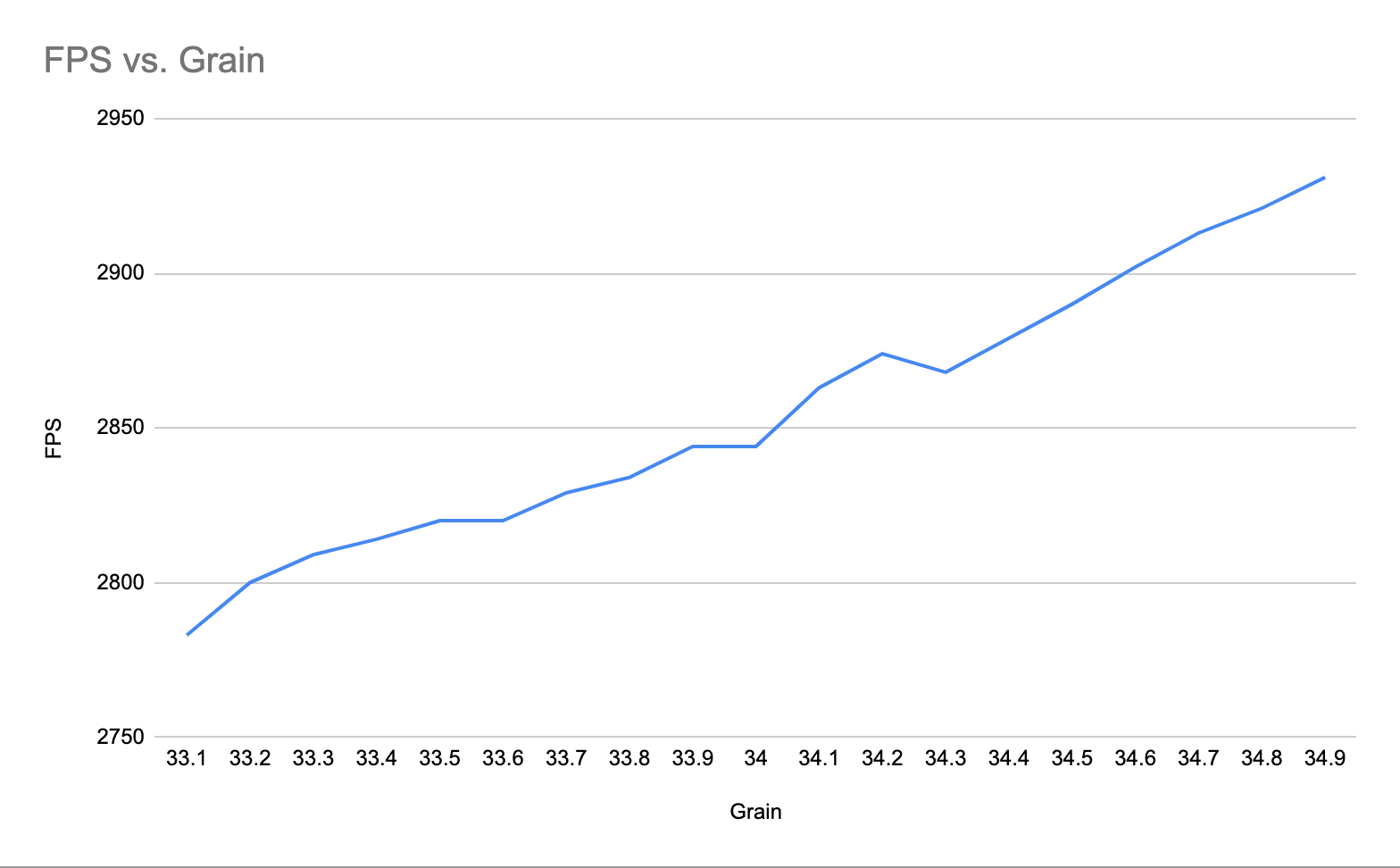

Not meaning to derail the thread, but what program is that?
It’s a spreadsheet for load development that the 65 Guys made. It’s really handy.
You can find it here.
