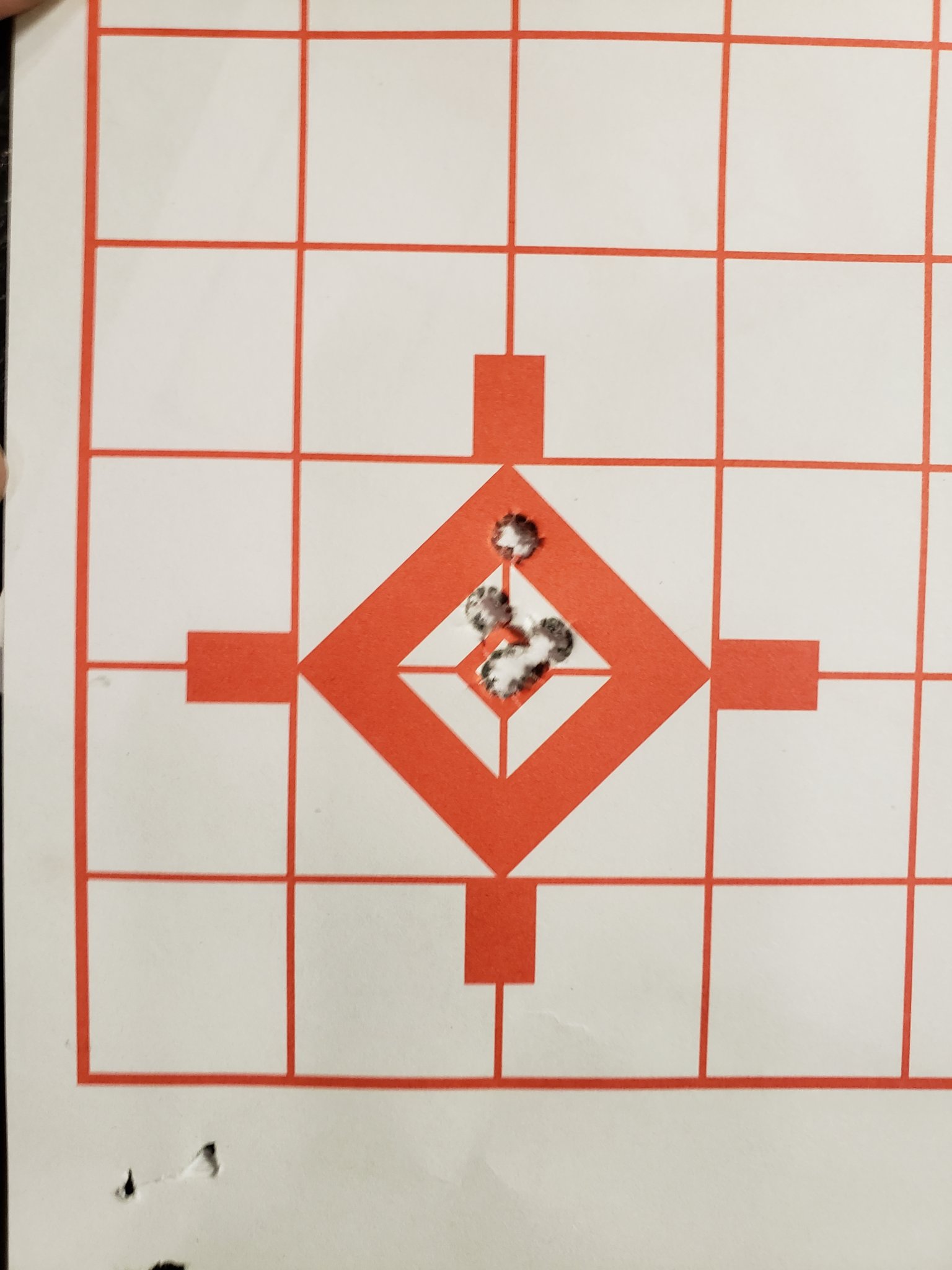

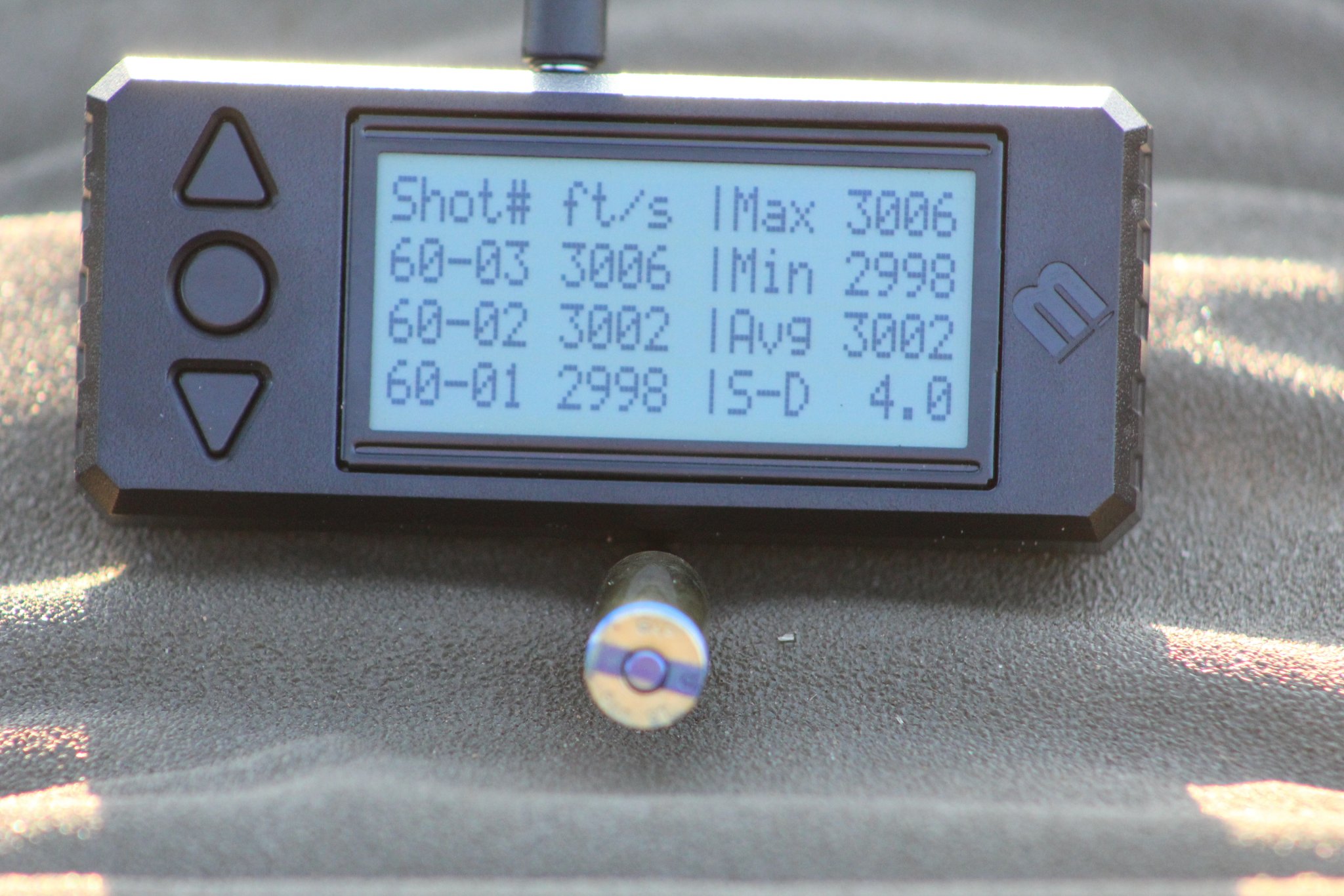

Took my 6GT out for the first time this weekend. Just getting rounds down range and breaking in my new barrel. Groups looks great for as good as I can shoot. First pic is a 3 shot group. The other two are 5 shot groups that I rushed because I was running out of time to shoot. Stupid range has a 1 hour limit and they were busy. Shooting Proof M24 SS 26" 7twist chambered by Straight Jacket Armory prefit for my Origin action. New Alpha brass, Varget, CCI 450 primers, and 105 Hybrids. I only got to chrono a few shots but SDs were single digits. Pretty happy with the 6GT and can't wait to do some real load development after I get more rounds down the pipe. Also no problems feeding with a magpul aics mag and MDT 12 rounder.

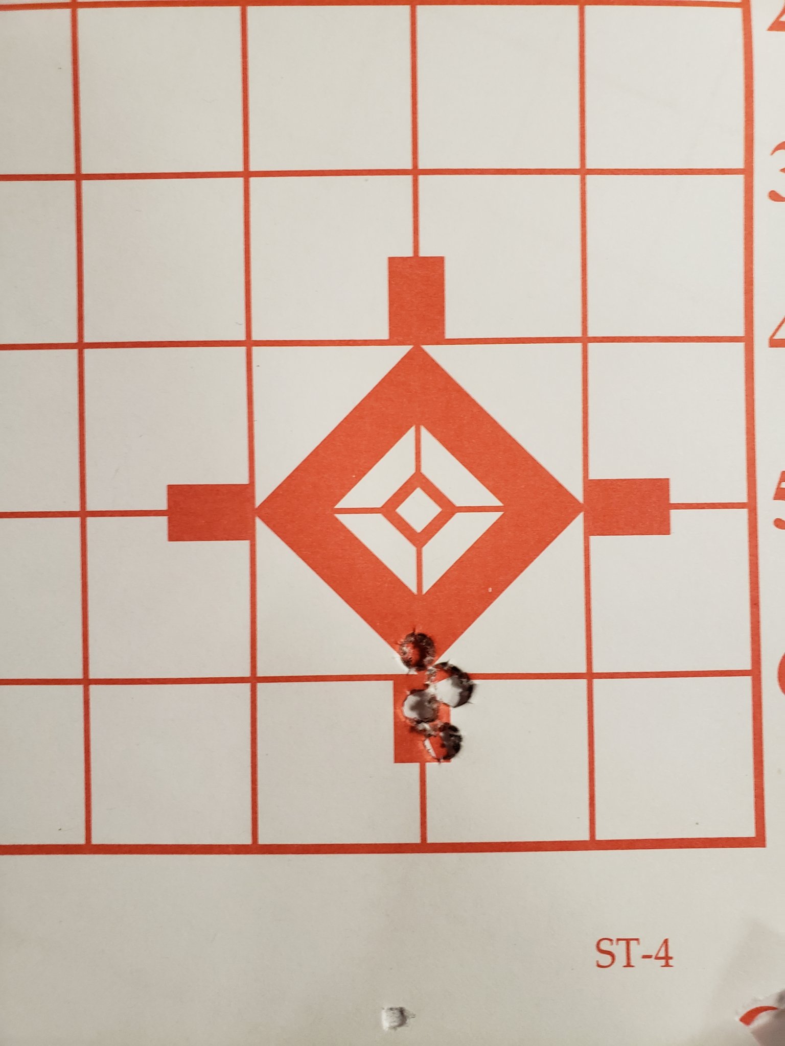

Also ot my 6mm GT from straight jacket arms. On a GA Tempest action. Loaded Hornady brass Barnes 112's cci br2 and varget, h4350, and staball. Proof 28 inch 7.5 twist.
33.4 varget 2915 sd 6 in 5 shots
36.6 h4350 2932 sd 5
Staball
37 2769 sd of 6
37.5 2781 sd 21
38.5 2830 sd 24
39 2885 sd 25
39.5 2965 sd 6
Non pressure signs on any load. The 39.5 load had some more kick to it. I did have one round not go off with Staball. I will get some rounds down the barrel and try again. But I am liking h4350 so far.

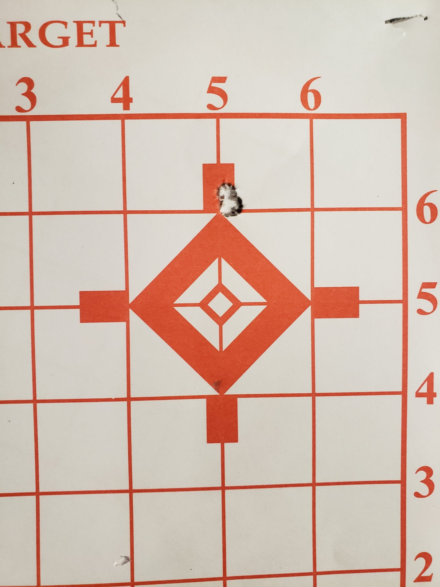

Brand new bartlien from impact arrived. Fired some pairs into my bullet trap collecting velocity only.
On new Hornady brass.
On fresh once fired
I'll add, this hornady brass is only needing to grow .002 to .003 in the shoulder from new, unlike some new brass I've used for different calibers. That should help with first fire accuracy...
On fresh once fired
