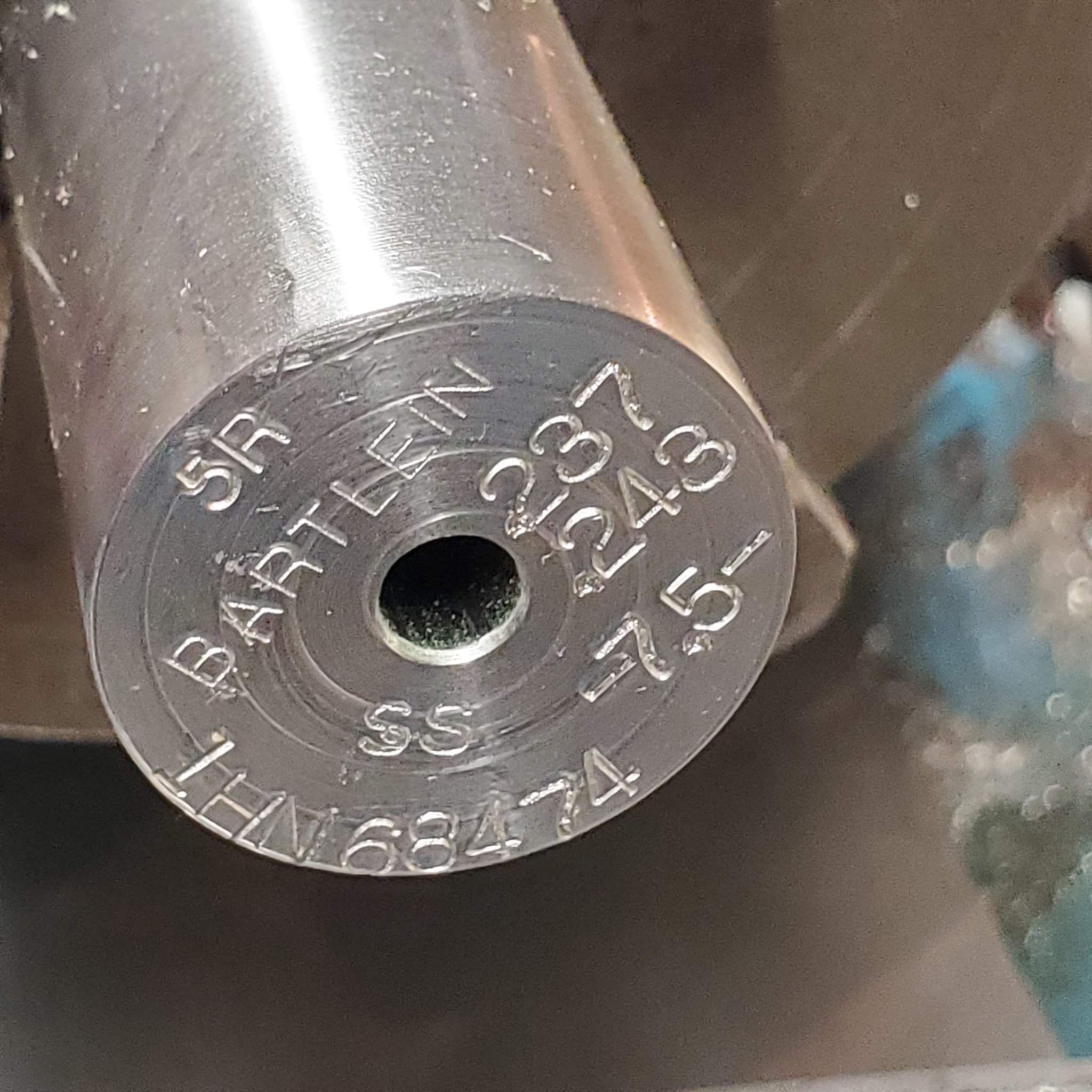

Anyone can shoot the same or similar speeds with a 6 Dasher.
Here's how... 28" Bartlein barrel, like this one, chambered in 6 Dasher.
The Alpha brass, 115 hr DTACs coated, and 6.5 Staball powder, with Rem 7 1/2 primer.
Work up for your rifle...3044 fps is there.

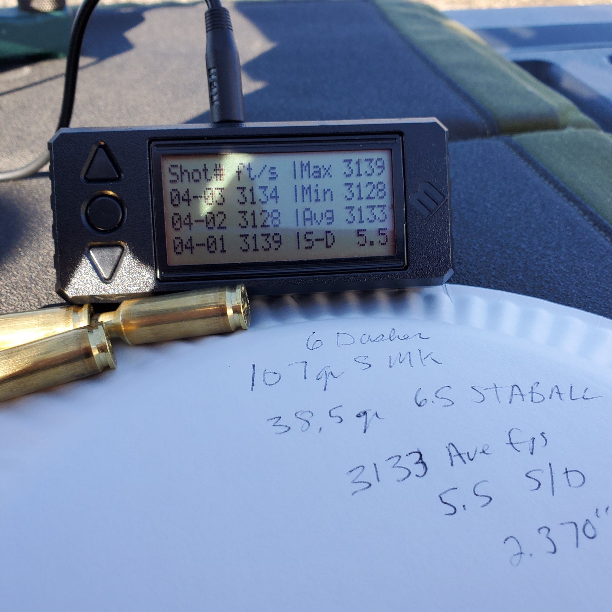

Here is actual load data when chronographing the 107 SMK at 3133 fos in the 6 Dasher.

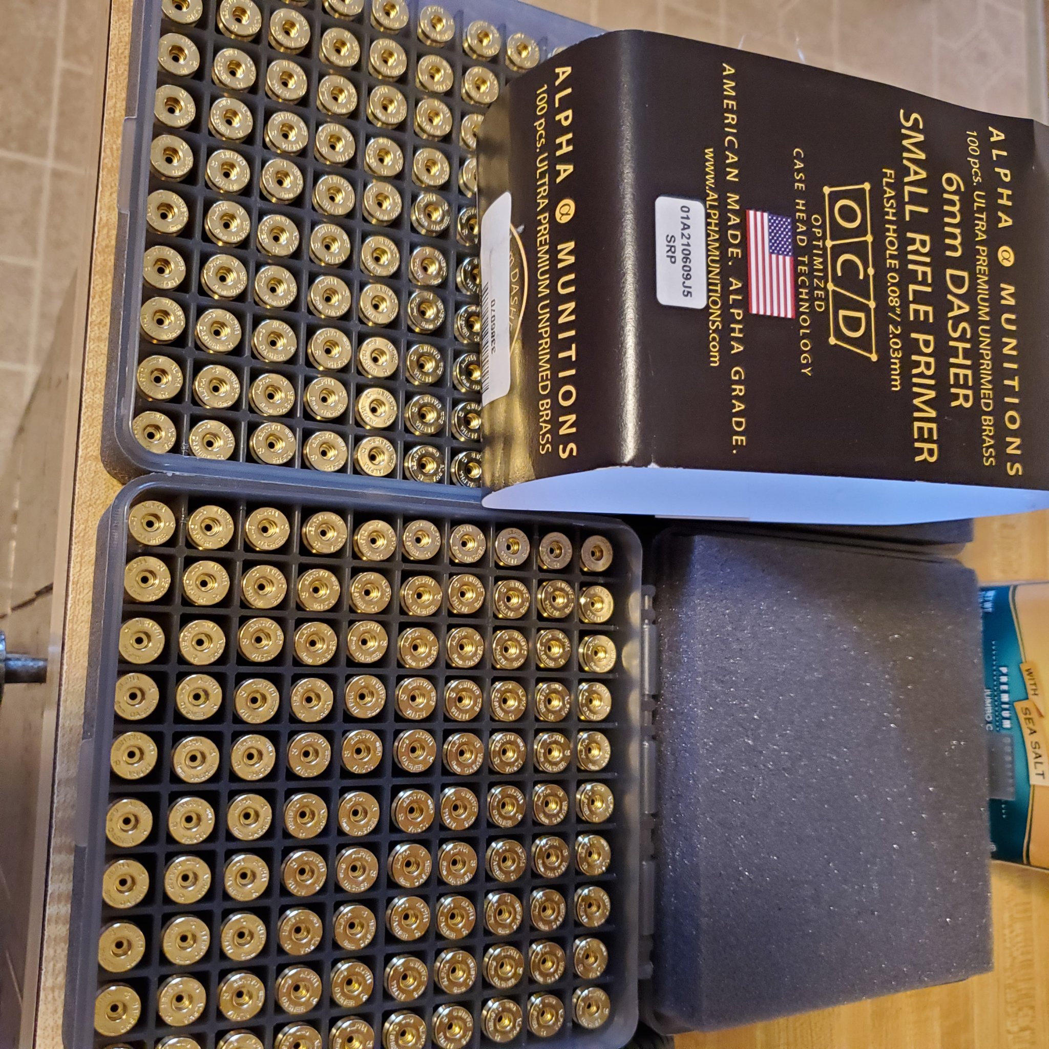

I had the same delima 6 Dasher or 6 GT.
I chose the Dasher when Alpha brass came out...

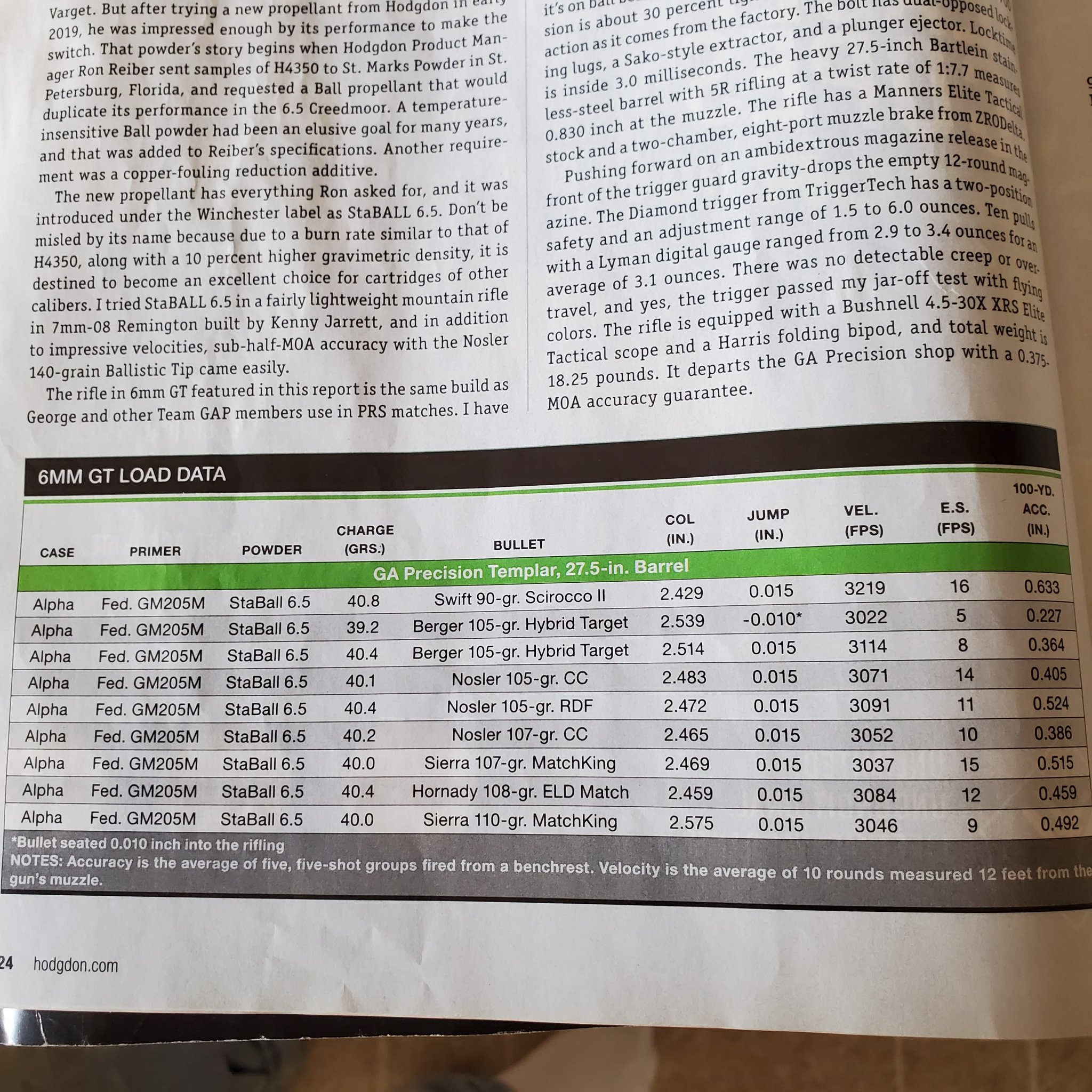

To muddy the waters further here is a direct comparison...my 28" barrel against a GA precision 27.5" 6 GT in Hodgdons 2020 annual manual. SAME powder...6.5 Staball
The only difference is the 6 dasher gets the same velocity with 1.5 grs less 6.5 Staball and the 6 Dasher had better accuracy with the Bartlein barrel than the GA Precision had with their barrel, probably Bartlein.
Here's the article and their load data.
There is little difference in performance, but the 6 Dasher has a slight accuracy edge...your choice.
