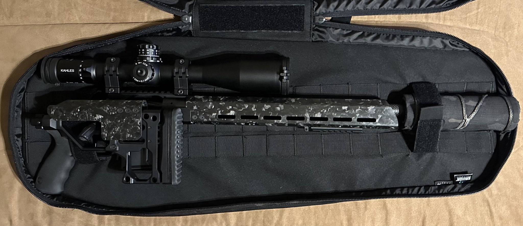

    Wanted to make this thread for a sticky post for the load data, for those who are shooting a bolt-action 6mm ARC. @Lowlight
    *** In case someone else reads this in the future, DO NOT use bolt-gun load data in a gas gun. Bolt guns can handle a lot more pressure. ***

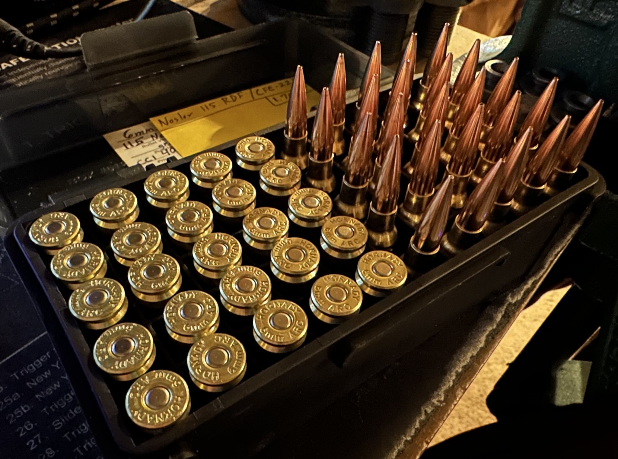

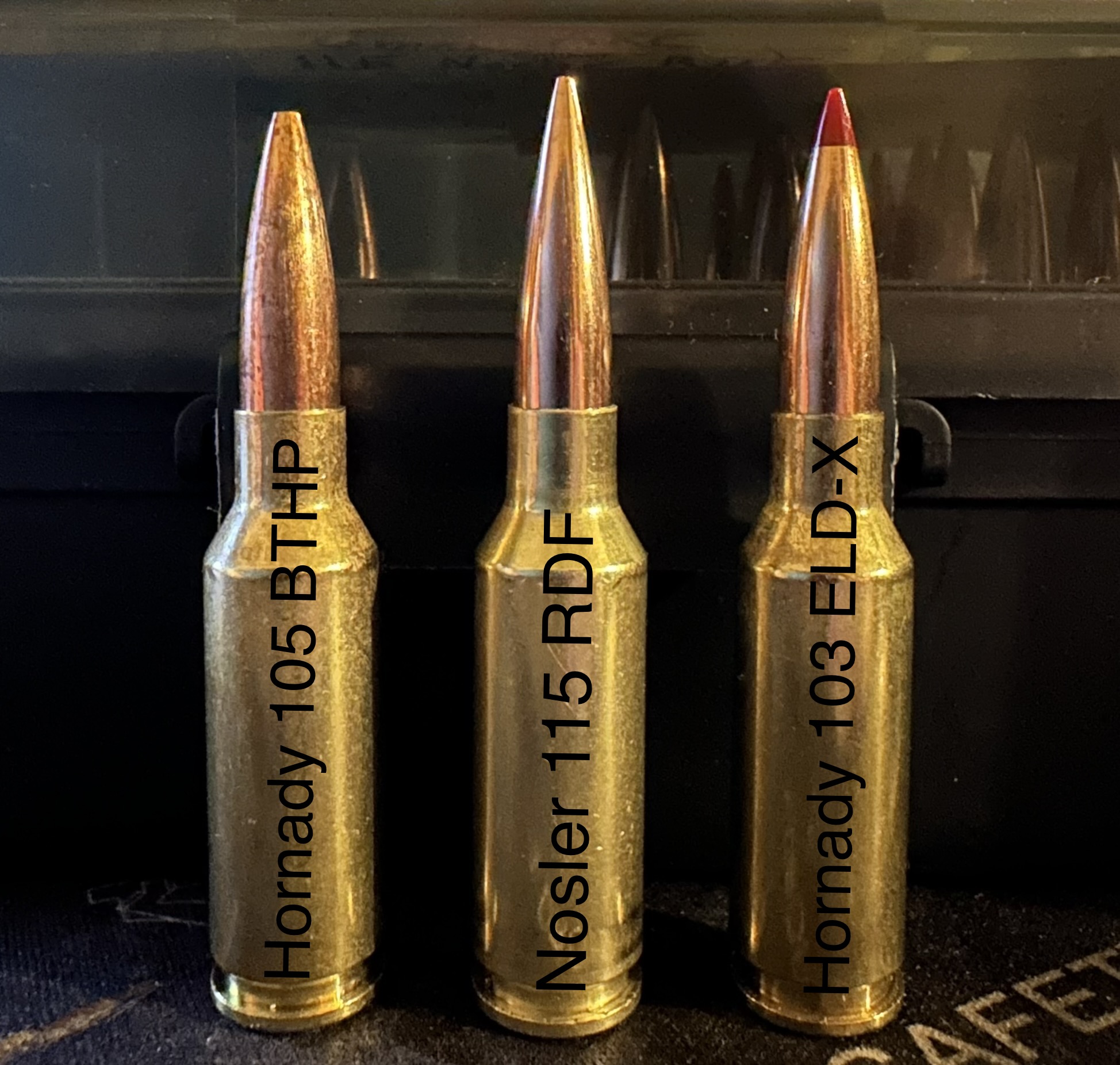

    Loaded up my first round of load development for my 16" Christensen Arms MPR. I'm running 1x fired and FL sized Hornady brass, CFE-223, CCI 400's, and Nosler 115 RDF's seated 0.007" off the lands, which works out perfectly at 1.700" in my rifle.
    I'm using Hornady Match Grade (bushing) dies & shell holder, with a Short Action Customs .266" bushing, giving me around 0.0025-0.003" of neck tension.
    I'm running all the way up to 29.0gr in 0.5 grain increments (first round of data is pressure baseline and finding a rough node pattern). I'll report back my findings when I get out to the range this weekend.

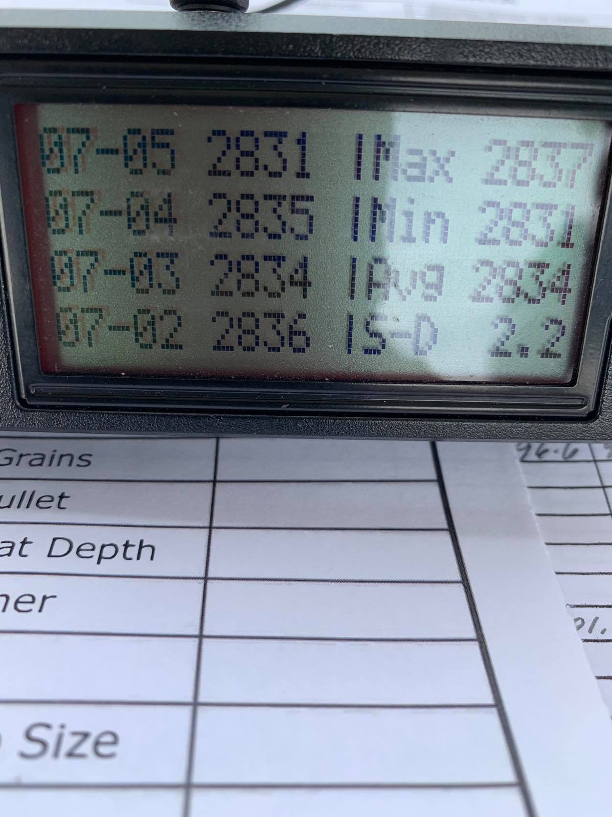

    The only powder i've had success above 2800 fps for the heavies (105, 108 or 110 A-TiP) has been with H4895. Running a 24" 1-7 twist barrel. With that said, it does not mean that i load to those velocity's.
    I do have one load (Lapua 105 HPBT Scenar) that shoot pretty well at 2831 fps with sd's of 2.2.

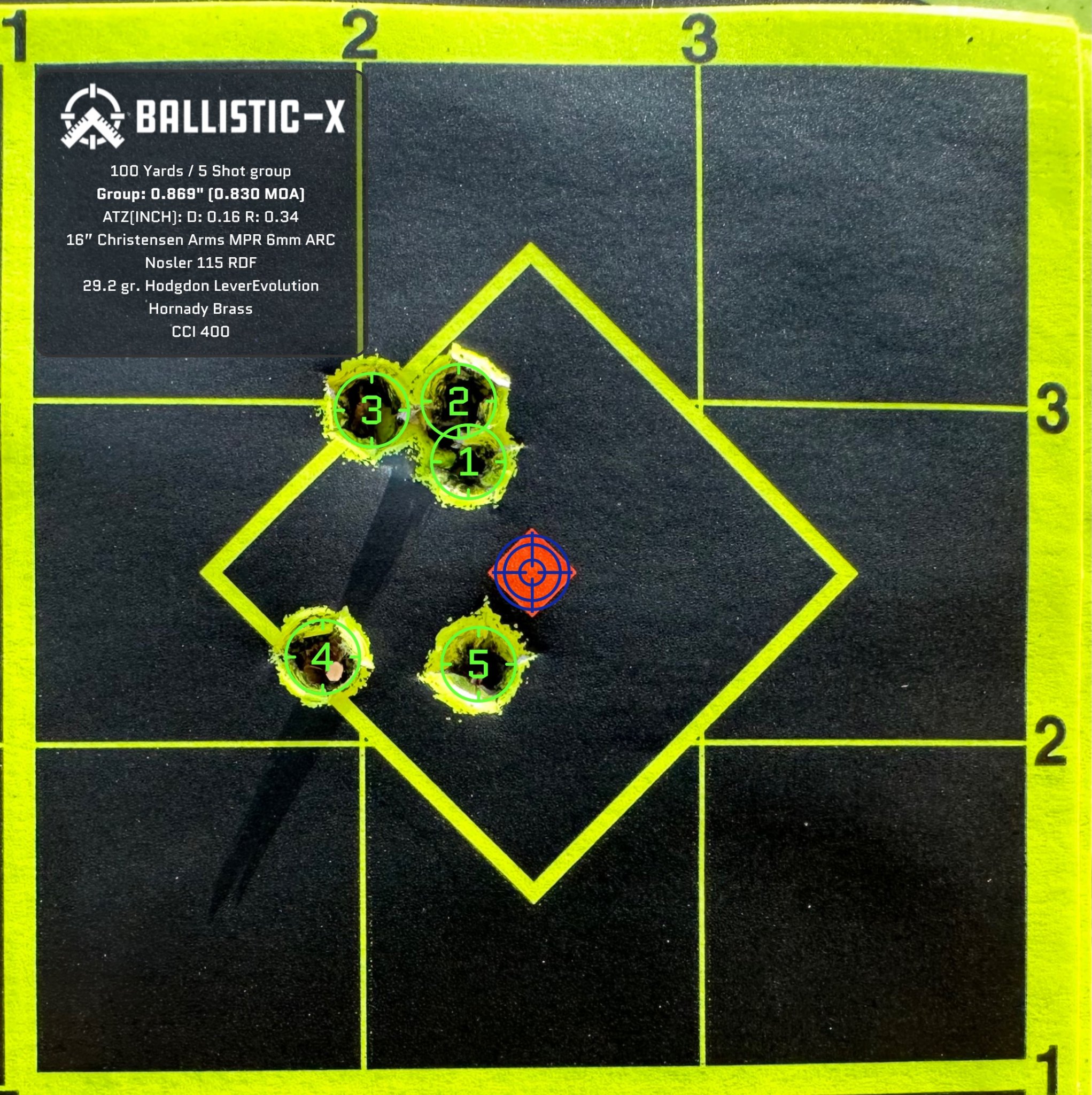

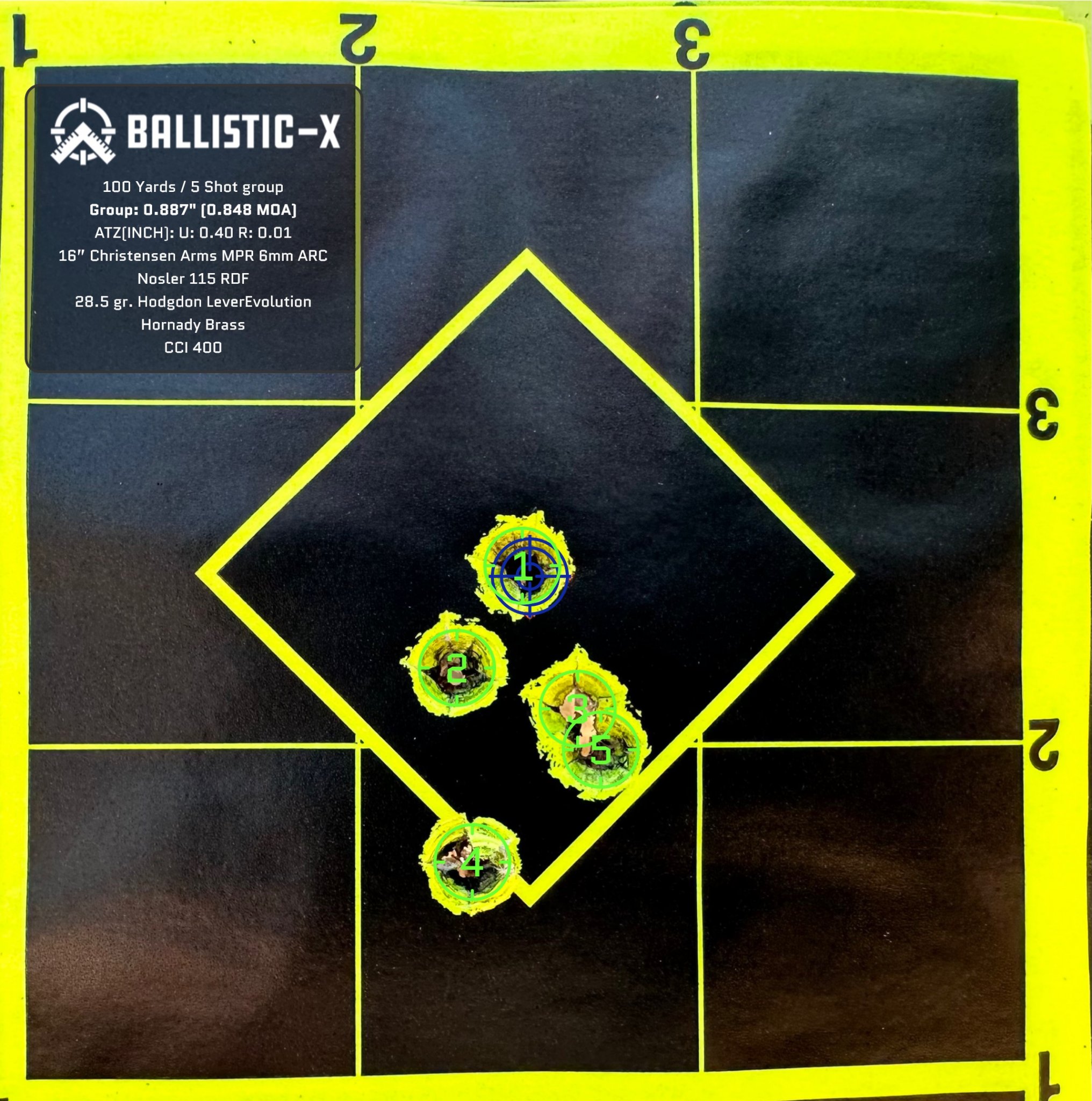

    Updates from today... Still not happy with the results, should be damn 1/2" gun for the MSRP, and my other 4 CA rifles shoot really good (1/4 to 1/3 MOA with handloads), but I guess you win some, you lose some. I guess no matter what, it's always going to be a "just barely sub-MOA" shooter... 🤦🏼 Granted, with factory ammo, it is NOT sub-MOA, so I might call CA and and send the fucker back and get it rebarreled and tested and proven before it leaves their factory.
    Yesterday and today's best groups with the Nosler 115 RDF and LeverEvolution powder...
    Ballistic-X-Export-2023-05-14 18:03:37.658545.jpgBallistic-X-Export-2023-05-14 18:07:12.729460.jpg

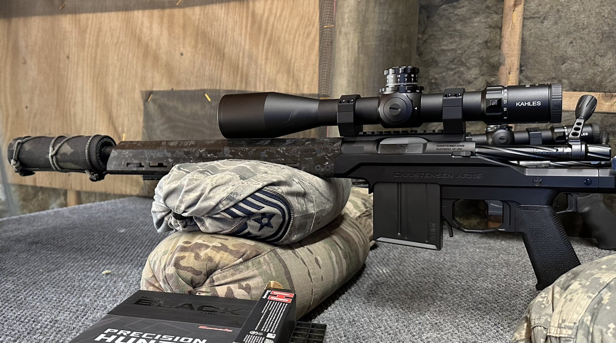

    Here's a couple groups today with the final rounds of factory Hornady Black and Precision Hunter I had left just for shits and giggles... These are the 2 best groups I've ever shot with it in 200 rounds of factory ammo... NOT sub-moa. 😐
    Ballistic-X-Export-2023-05-14 18:11:16.910828.jpgBallistic-X-Export-2023-05-14 18:15:13.970556.jpg

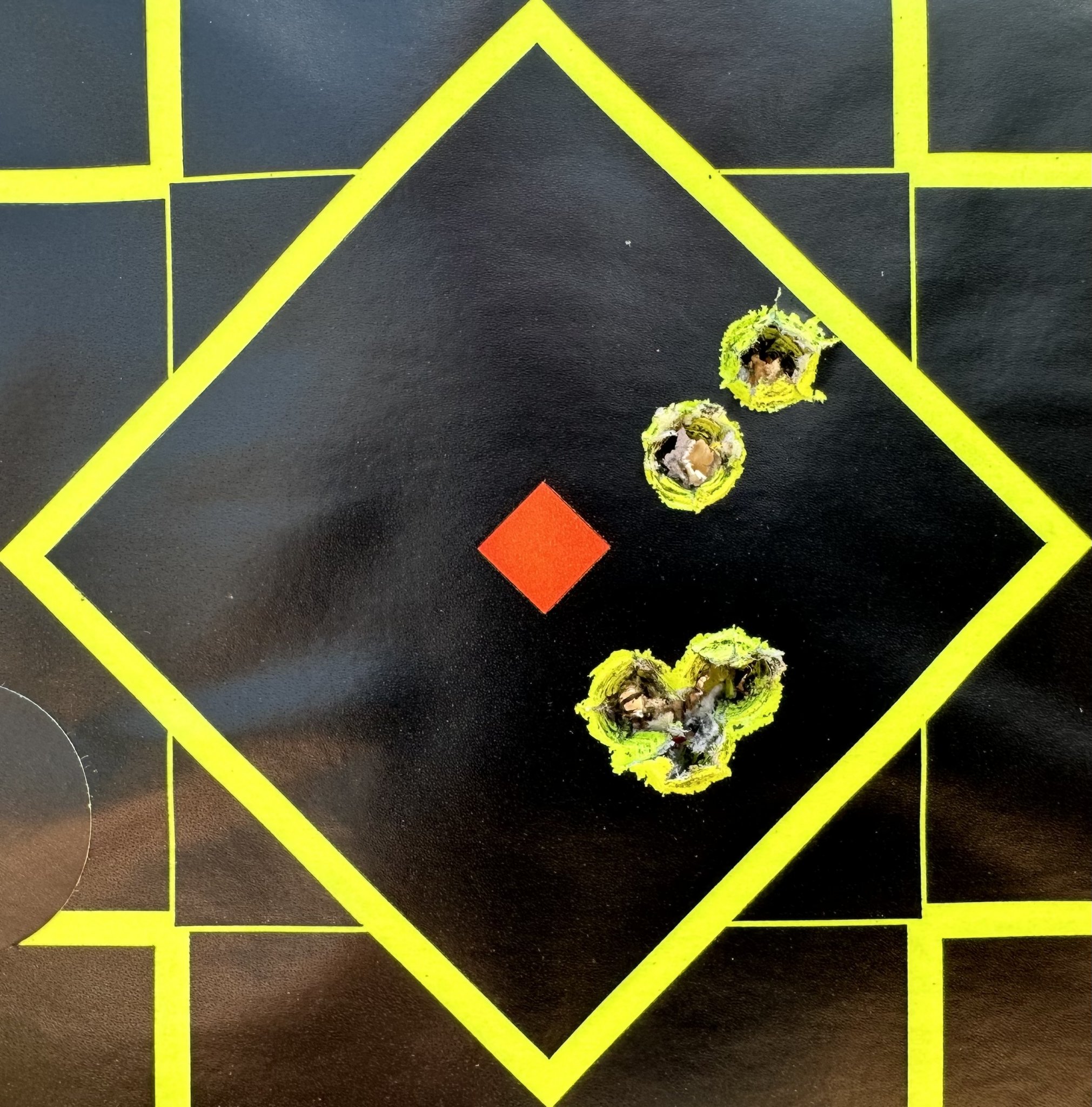

    It has consistent fliers. Like, it'll group a nice group near the bull, and then it'll put 2 or 3 in a nice little group off somewhere else. OR, it will shoot a nice 3-shot cloverleaf, and then throw 1-2 random goddamn fliers out into left-field somewhere for no reason. It's pretty annoying.
    I've been doing this a long time, and I've never owned a rifle that would put down 2 separate groups on the same target out of the same set of shots? It's weird. It does is almost every group like that. I honestly have never encountered this personally. I've seen other people's gun do it, but had no idea what caused it? Any ideas? 🤷🏼
    Could it be the scope having an issue? It's a Kahles K624i...I mean, it's an alpha-tier scope sitting in ARC M-Brace rings, that's pretty much brand new. Everything is tight, and it holds a pretty consistent zero. First shot is almost always near the bull...But the follow-ups are a complete crap-shoot where they'll land...
    For example... Here's a couple from yesterday...
    Pull the barreled action out and reset it and torque it. I have seen rifles do that with issues in the barreled action to stock fit.
    Also have you shot it without the suppressor?
    No, haven't shot it without the can. But that can has been shot a lot, and proven to be straight, and has never affected any other rifle's groups... I suppose I should give that a try. I will definitely remove the barreled action and retorque for sure.
    Yeah might be the can to barrel connection so might not be the can. Best to try everything before calling them as they will ask you the same things I am sure.
