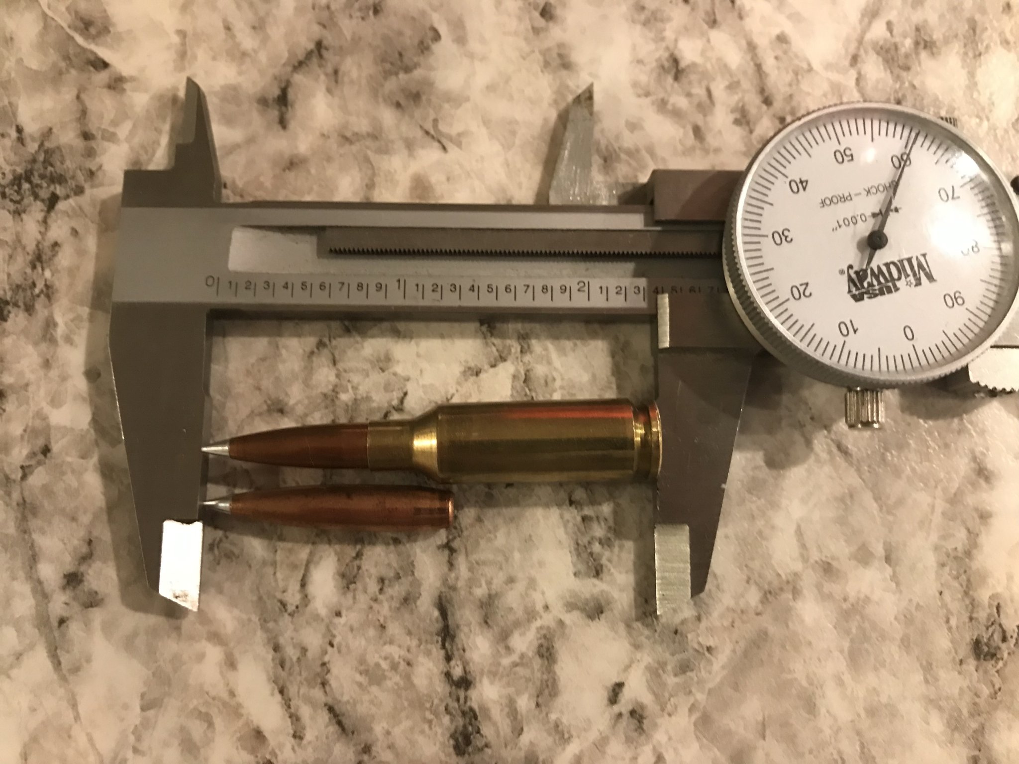

Re: my jump issue, I'm starting to think my new 6ARC modified case is screwy. Even if I really jam the bullet with the OAL gauge the best I can get is 0.020" off of the jam with 2.252" factory COAL ... but that does not track with how smoothly the round chambers at all.
Going to get a new modified case and see if measurements hold with that before jumping (pun intended) to conclusions. If they do, the only conclusion is that my chamber is shorter than it should be I assume?
Is there a better method of measuring contact to the lands besides the Hornady OAL gauge? The bullets are 0.2430" exactly so I don't think they're too fat or anything.
EDIT: going to try https://precisionrifleblog.com/how-to-measure-the-distance-to-the-lands-on-your-rifle-barrel/

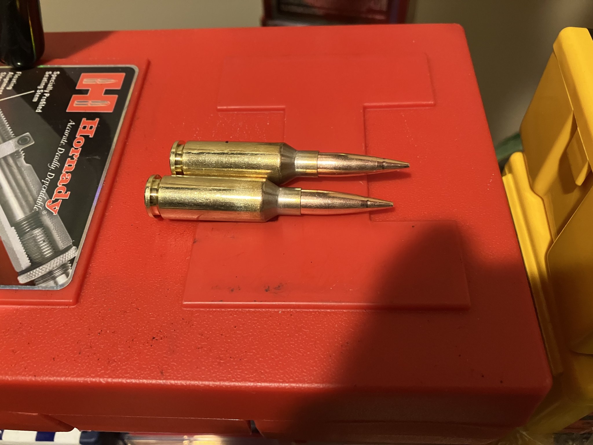

So I'm not nuts and factory 2.250" COAL has me well into the lands. The OAL gauge had me at 1.666" to the lands with my ogive comparitor.
I'm shipping this barrel back to have the chamber inspected before shooting it again. That's too much of a coincidence for me to chalk it all up to my gauges or my ability to measure.
EDIT: I reran the Wheeler test because the first run I was comparing a deeply seated Hornady brass to an Alpha brass that I was incrementally kept seating deeper. I figured to be exact I should compare apples to apples and reran comparing Alpha to Alpha and just going until there was no longer a bolt lift "unlock" feeling disengaging the bullet from the rifling as opposed to no friction at all, and that gets me 0.015" off the lands with 2.250" COAL ... still a little close for comfort, but manageable if I drop my powder charge I think.

Note on my ejector marks, I was still a bit bothered that even my lighter loads (29.2 e.g.) were showing ejector marks and was thinking maybe excessive headspace. What really got my gears grinding was that a batch of Hornady brass reloads that were fine in their factory first firing now also had ejection marks at a mild load similar to the factory load.
This was the first time using my new Hornady 6ARC die and ASSUMED it would just headspace to SAAMI spec by default which is what my 6.5CM and 308 dies do. So I was just going to get the first firing out of the way with a standard headspace and then tweak from there on, and again, assumption is the mother of all f-ups.
Measuring today, my 6ARC FL resize die is setting headspace back ~0.010" further than a Hornady factory round so I'm guessing the excessive headspace had my brass slamming into the boltface regardless of charge. I bumped it back up 0.010" using a Redding #12 competition shellholder set. These let you adjust shoulder bump from the shell holder end so you don't have to mess with the seating depth of the die. I'll do that for the rest of the Alpha brass lot's first firings as well and then tweak to the chamber from there.
In the interim I ordered a set of Mighty Armory dies for all the calibers I reload for to replace my hodgepodge of Lee and Hornady dies.
Yea man, you gotta measure your once fired in your chamber brass with a case headspace gauge with the primers removed and record that number. Then screw your sizing down down until it touchs shell holders then back off a half a turn or so.
Now size your brass and measure, and keep screwing that sizing die down 1/4 turn at a time until your brass headspace measures 0.002-0.003 less than your once fired brass measurement then lock it down....

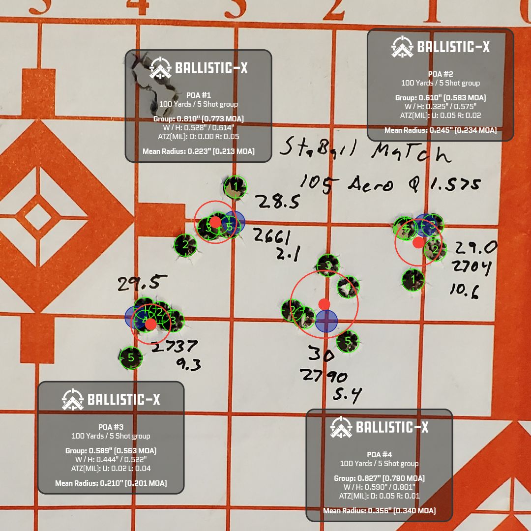

Made it out with the next set of loads. One difference to note, unlike my previous outings the rifle and ammo were exposed to 32 degrees for 9 hours prior to these being fired.
These were all loaded to jump .055" in new Alpha brass with federal 205's and StaBALL Match powder.
28.5 = 2661 sd 2.1
29.0 = 2704 sd 10.6
29.5 = 2737 sd 9.3
30.0 = 2790 sd 5.4
Groups suck compared to varget but still under .8 moa, so there is that...

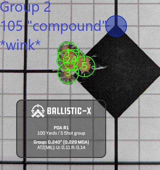

Also been playing around with varget. Alpha brass, 105 berger hybrid, 2.400" COAL, 0.035" jump (measured using the wheeler method), 24" 1:7.5 benchmark with throated freebore to 0.180"
Running between 2650-2700fps on these first loads. Have some case capacity left due to seating long and having double freebore so going to ladder up to 28.6 varget later this week and see how that does. If I can get 2750 on a varget load and keep it under or around 0.5moa without pressure signs I'm going to call it there. Quickload predicts around 60K PSI on 28.6gr of varget with my COAL so should be alright.
