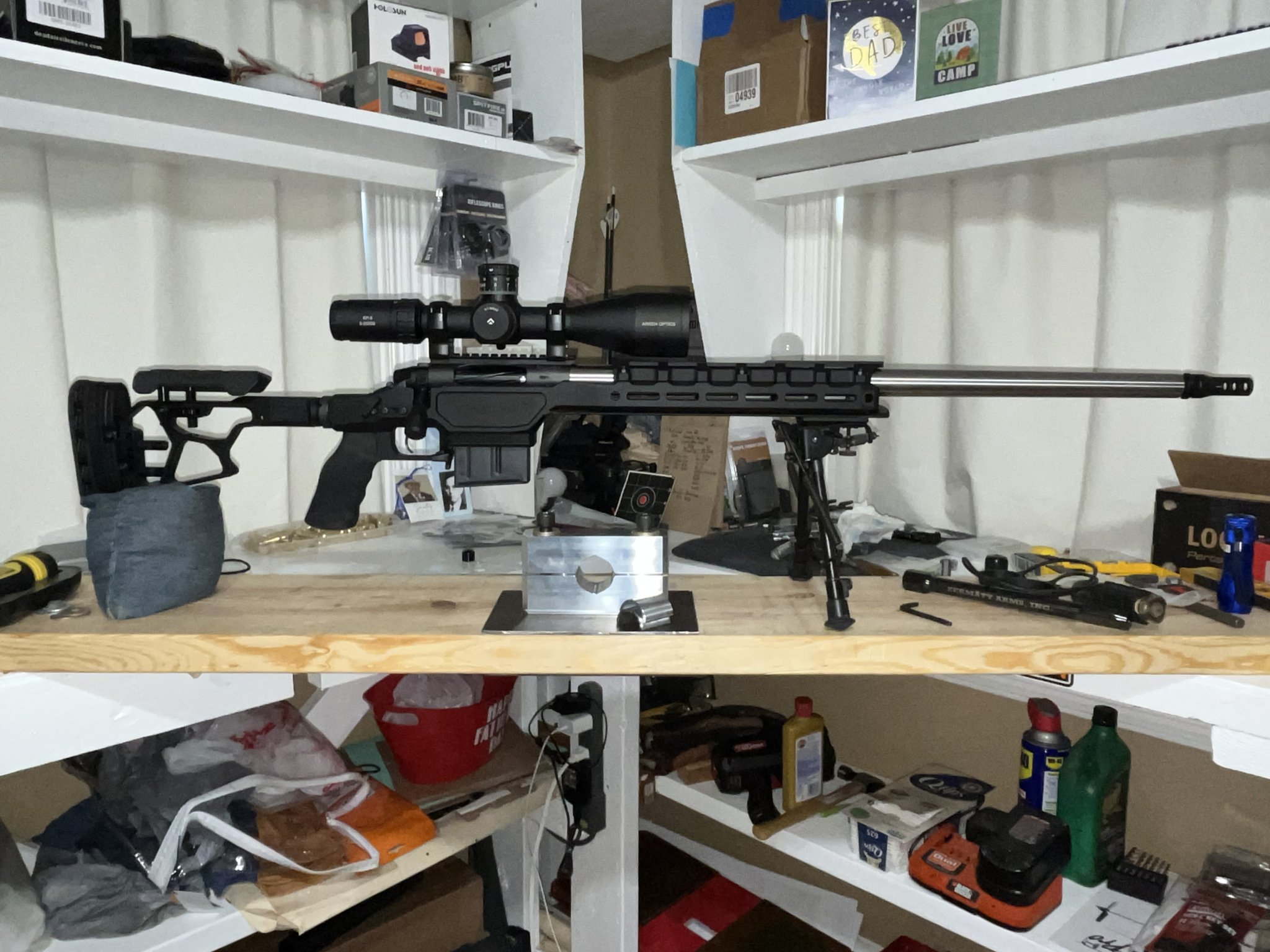

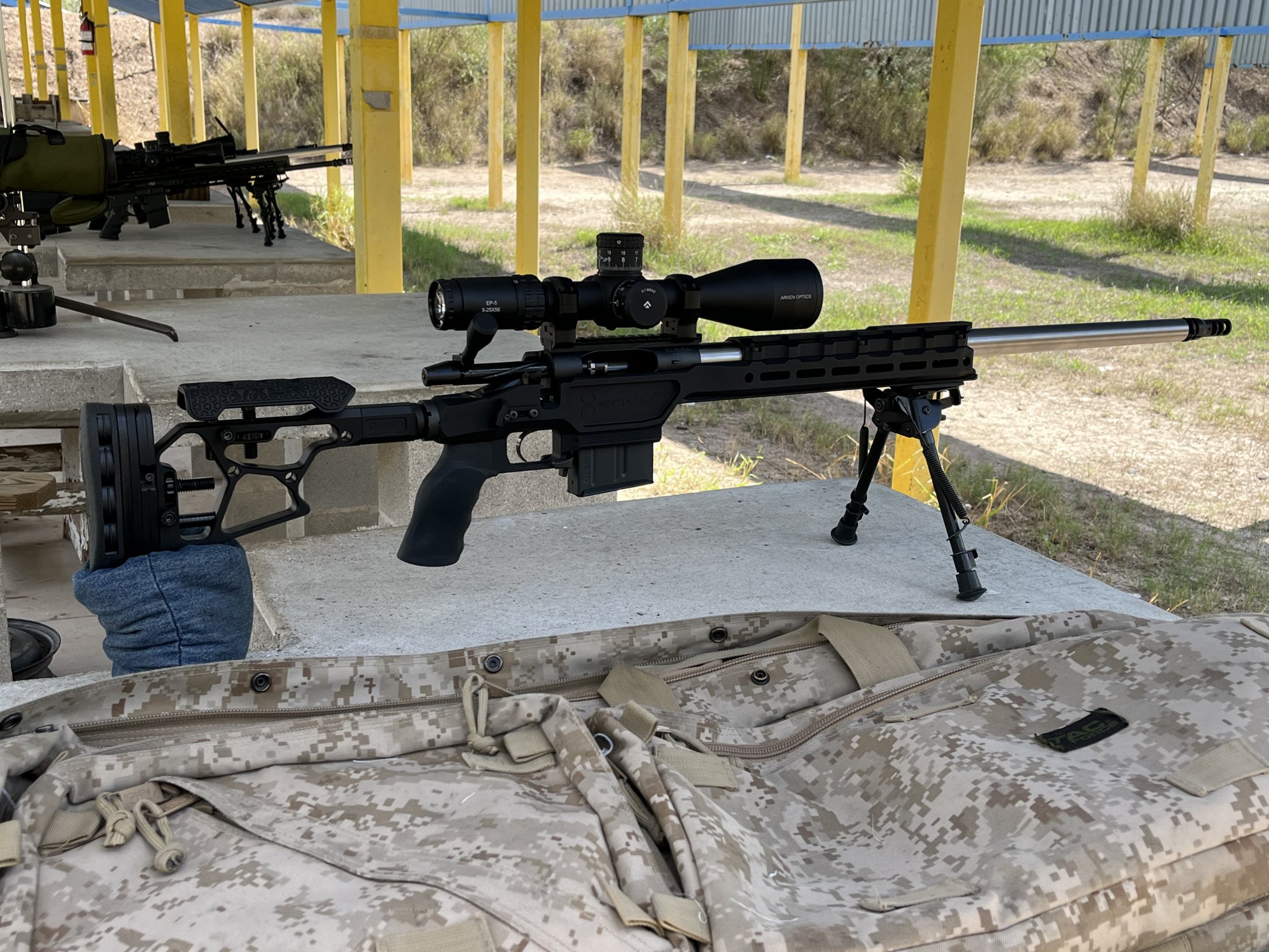

Gentlemen, can I get a Hell Ya!!
6mm ARC
Zermatt TL3
PROOF 26”
XLR Envy Pro
Trigger Tech Primary
Dead Air Brake
MDT 10 rd mag
I have some CFE 223/Varget loads ready 1/2 grain short of max to try her out tomorrow. We’ll see how she does.
Reactions: JKW70 and Ronws
6mm ARC
Zermatt TL3
PROOF 26”
XLR Envy Pro
Dead Air Brake
MDT 10 rd mag
That is a sick build! Are you running bolt pressure loads? Please post results (load data, velocity, accuracy) as I'm considering a near identical build for PRS for an efficient, low recoil 6. Very cool!

I've got a Bighorn Origin SA, McMillan carbon-fiber A6, Seekins bottom metal with a Proof CF 6.5CM thats getting a little long in the tooth. Definitely more of a 'field' gun than a 'gamer' gun - just heavy enough to be steady, still light enough to be not-miserable to carry around. I see Proof makes a 22" 6 ARC pre-fit barrel, and that's got me... intrigued. What else would I need? Bolt head and... mags, from MDT?
Honestly, I'd kinda like to build a 'heavier' gun on an Aero Solus and go with a Proof CF 20" .308 bbl on this gun, but until/unless they come out with a PPC/Grendel/ARC bolt head for the Solus like the Origin, guess I'll be building with what I have. I figure the 22" barrel will pair with my 9" Sandstorm Ti can a lot better than the 26" tube I have now!
Any more updates on these? Still lovin' it, @Rob01 ? ;)

What freebore are y'all running on your bolt action 6ARCs?
I've been loving my 6ARC and it's shooting great (Zermatt Origin with a 20" 1:7.5 Benchmark barrel) but today I noticed some lands mark on a round I ejected unfired.
That got me scratching my head because I load to factory Hornady dimensions with (zero'd on ogive gauge) seats CBTO at ~1.699" ... so I busted out the OAL gauge and sure enough my lands are touching at 1.666" so I'm negative into the lands 0.033" and in full on jam territory even with factory COAL.
Digging up the paperwork on my barrel order, sure enough the freebore on my barrel is 0.090" which seems awfully short for a 6mm and I reckon not ideal to have even factory ammo jam into the lands. It shoots fine, and holds 0.3-0.5moa groups pretty consistently but it was running pretty high velocities for a 20" barrel (2850fps with 30.7gr LeverEvolution), which I chalked up to good fortune but now I'm guessing I'm spiking pressure a bit due to the jam into the lands.
I was seeing a little bit of extractor shine on the caseheads as well today, which I think was because I had some carbon ring, which combined with the jam put me over into early pressure sign territory. No other signs on the brass or primers though.
Normally I try to stay around 0.020" off of the lands, so I guess I'll have to order a new barrel, which I'll probably go to a 24" and hopefully regain some velocity that I'm giving up on getting away from the jam.
Seating off of the lands with my current freebore would get me into powder crunch territory I think.
Lesson learned: always measure everything and don't assume.
