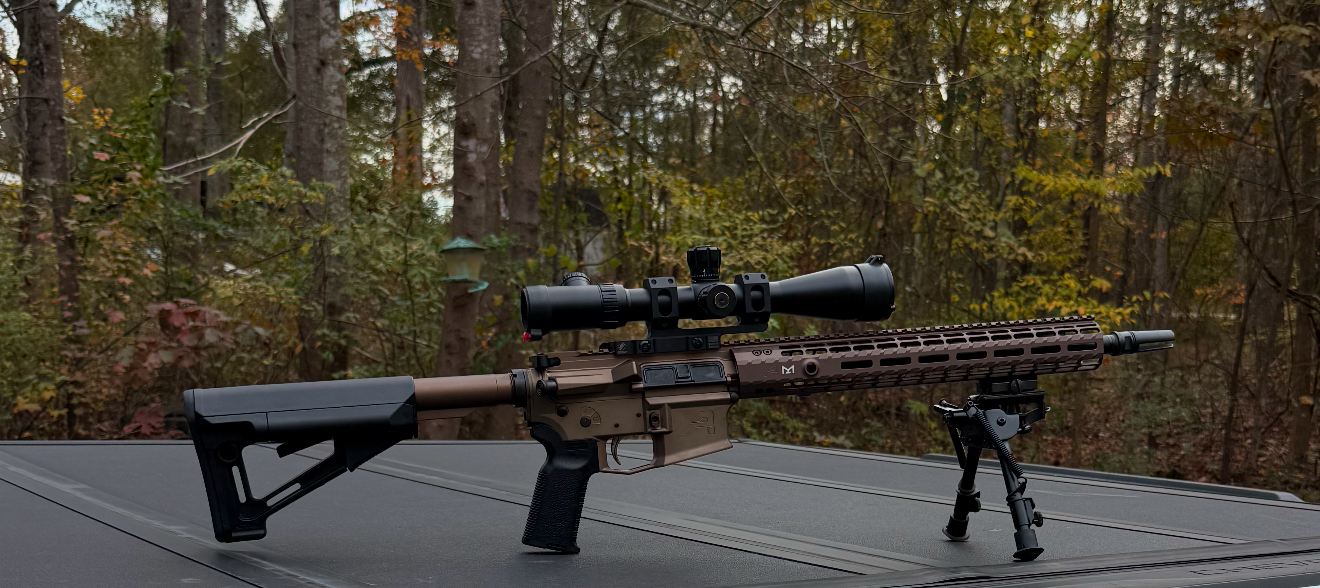

I have a 16" build that I'm pretty happy with as a hunting/beater rifle,
Aero upper (no F/A but do whatever makes you happy)
Aero M4e1 lower
Aero handguard
Faxon Match 6mm ARC 16" barrel (YMMV, I think I got lucky with this one it hammers with factory ammo, I know Faxon doesn't always deliver in that regard). Pretty sure it's mid-length
Aero adjustable gas block
Geiselle trigger (3.5lb single stage), standard guts otherwise & magpul grip/stock

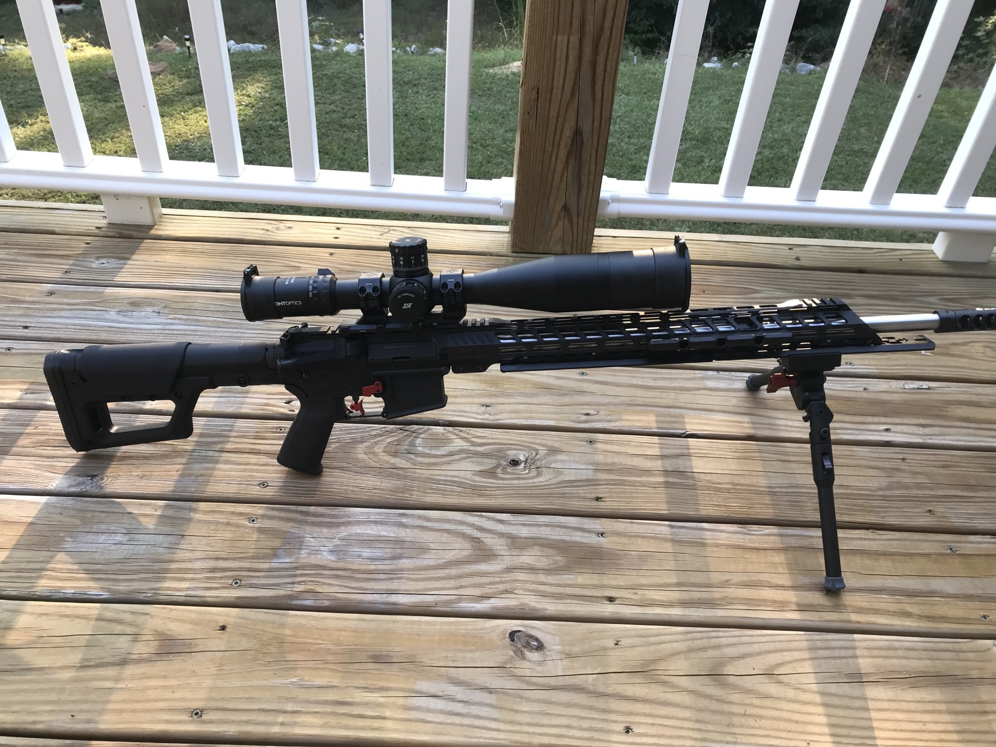

I've done a 26" rifle +2 gas build, a 16" rifle gas build, and a 20" rifle gas build. All were easy to tune, but what I've learned about these barrels comes down to this:
  • 16" is fine for the vast majority of setups and you can still shoot 100-110 class bullets at reasonable velocity
  • 26" is too long and not the velocity increase you'd expect
  • 20" feels like the sweet spot if you're trying to maximize mass/velocity

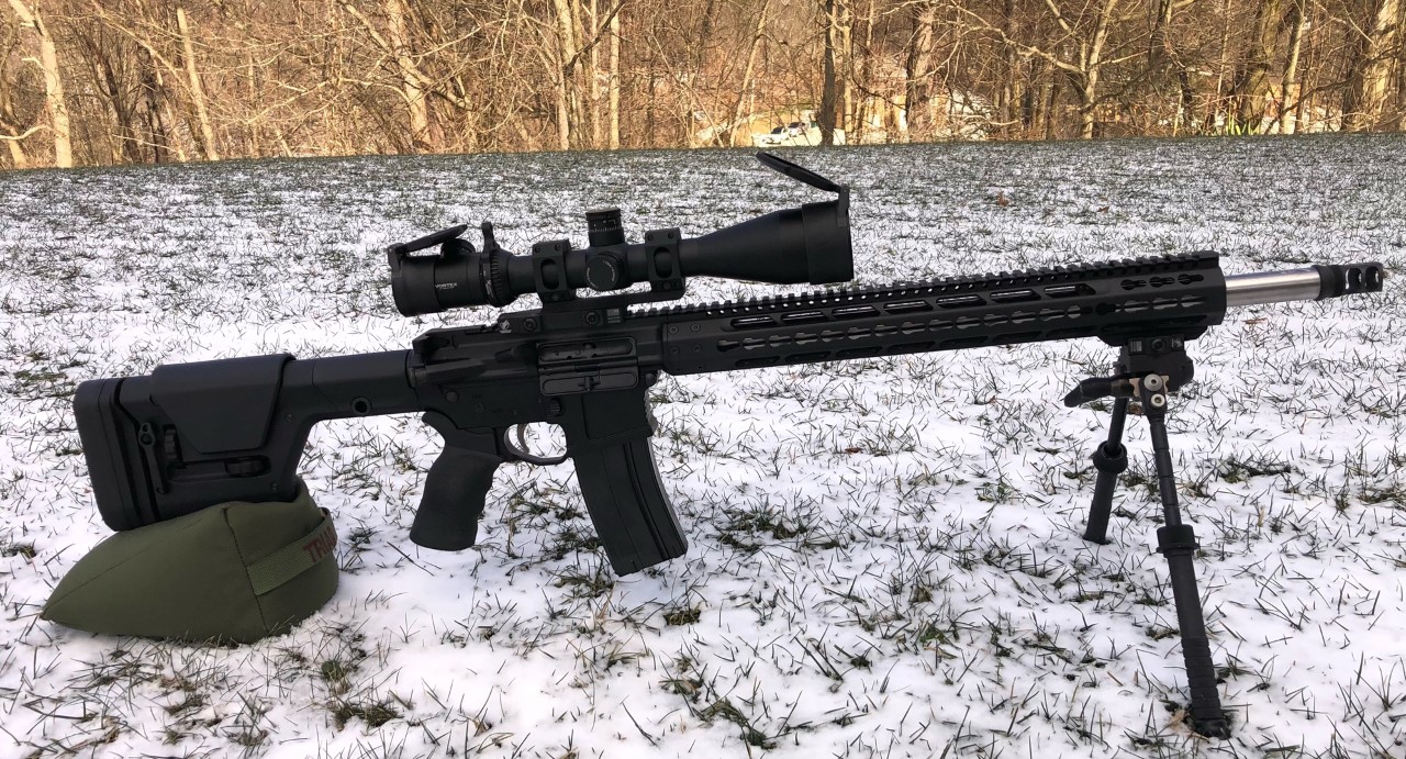

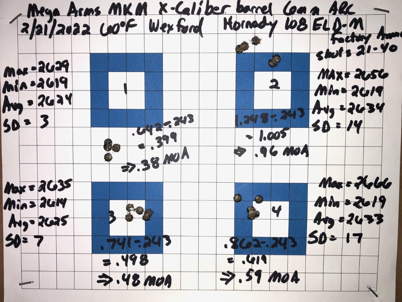

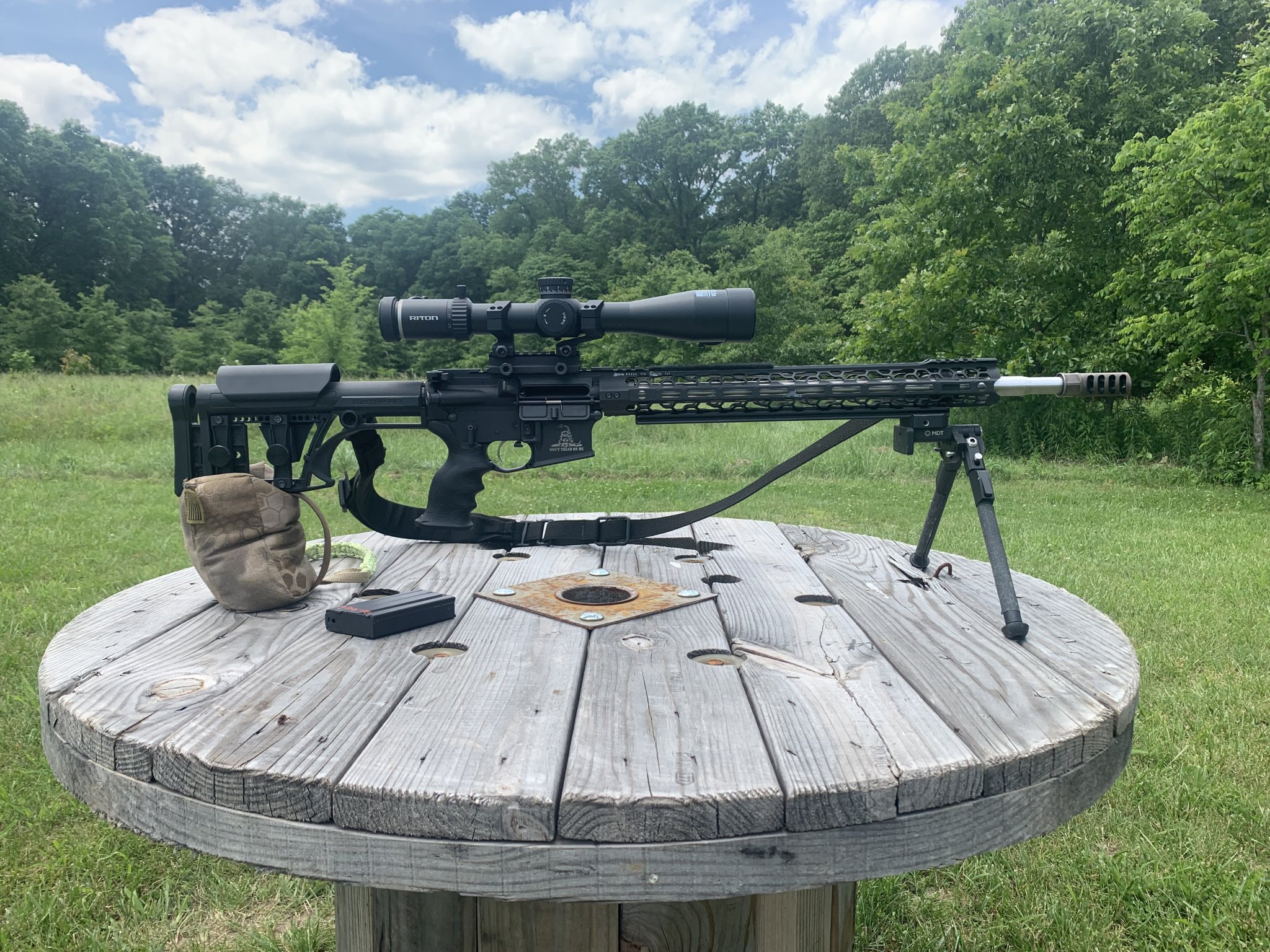

I went with a 20 inch X Caliber barrel (bull profile and rifle gas) on my Mega Arms AR-15 receiver set. Using a JP rifles full mass bcg, SLR Sentry 9 adjustable gas block, LaRue MBT-2S trigger and Vortex Viper PST Gen 1 4-16x50 mrad scope it easily printed sub moa groups with factory Hornady 108 ELD-M.
Seekins. Geissele Super 42 braided spring, H2 (iirc) buffer, JP HP bolt (which comes headspaced and recommended by) Proof 18” +1 rifle, SA AGB. Almost exclusively suppressed. No issues, very accurate and good velocities.
As mentioned 18-20” is where this cartridge shines. I’ve had good luck with Duramag SS 6 ARC mags.

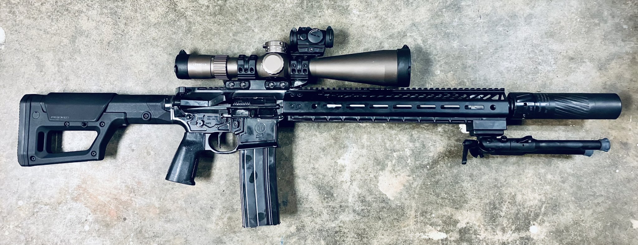

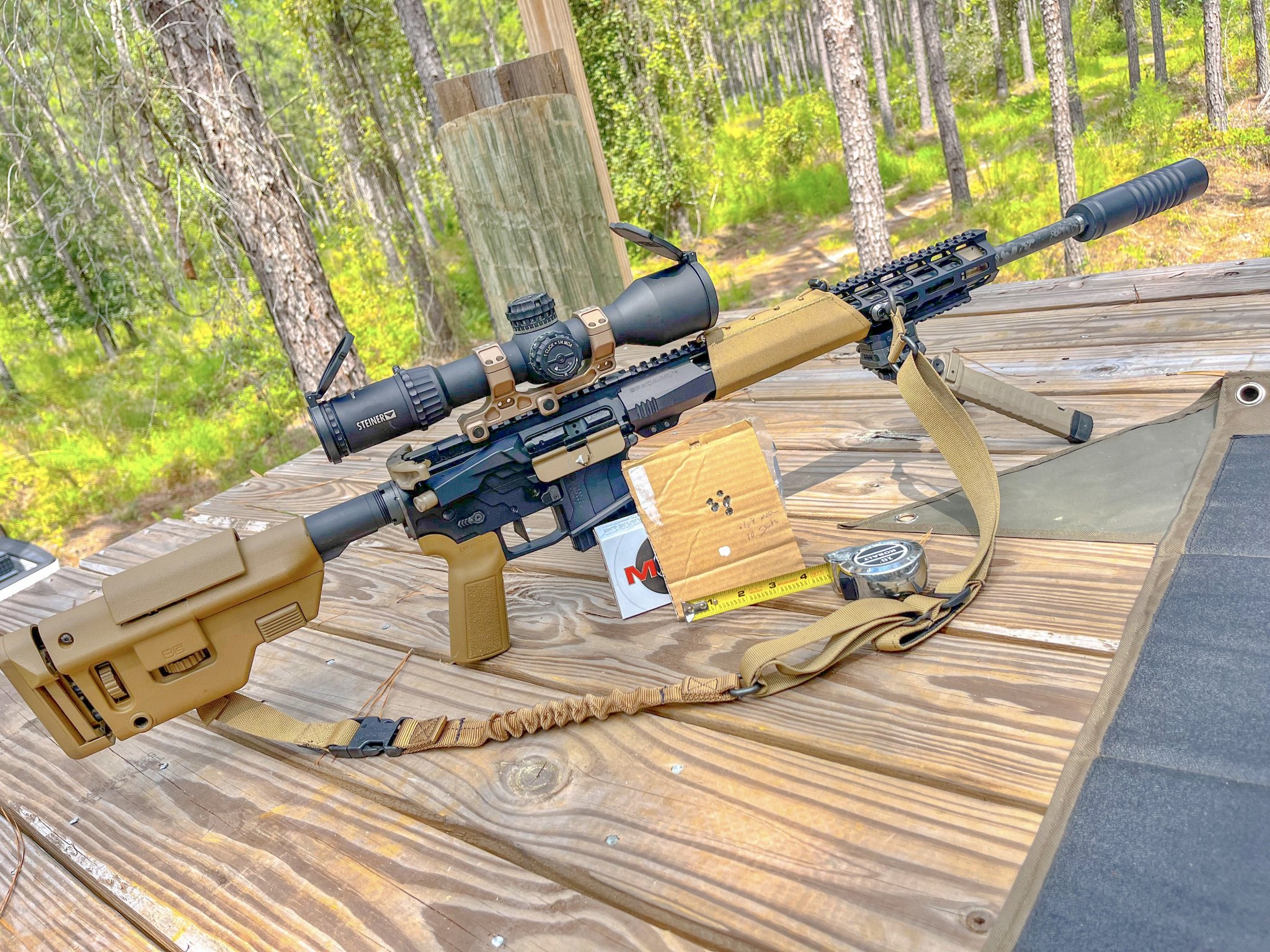

I converted a 5.56 LMT to a 6 ARC. I did the barrel swap with D Wilson and bought a Proof stainless barrel. I changed out the bolt face for the 6.5 from JP. I have tried a couple of mags but the only one that has worked flawlessly for me have been the Geissele.
Reactions: Redlion
Damn! You beat the DoD building a 6 ARC by like 4 years. And Lowlight will bust a nut when he sees the height on that scope! That’s the future apparently.
Well, I have no idea WTF I was thinking of when I said ‘16. Looking at my data book, it reads 5-30-21. lol.
The scope height fits my face comfortably. I’d rather be comfortable than super cool low.
18" rifle+1. 22" rifle +2. 16" rifle length gas h2 and h3 buffers in a carbine tube with regular and flatwire springs shooting suppressed. Not problems getting any of them running and adjusted.
I'm also running a 18" rifle +1" gas. I think it's got an A5H1 buffer, and it's tuned for suppressed but absolutely will not work unsuppressed. I think the performance overlap would be a lot bigger for rifle gas if I was taking the can off a lot.
That’s odd. My +1 runs both. Ejects different angle obviously but runs all the different hand loads I’ve tried. Definitely the factory ammo. I haven’t shot all my load developments unsuppressed though.
I think if you have a quality adjustable gas block and a JP silent capture spring, (why wouldn't every AR you own have one?), gas systems haven't been an issue for any of the 5 I've assembled.
I'm sure I could tune it to run unsuppressed, but then with my high back pressure can (Polonium 30) I'd be getting pretty gassed out as the dwell time is pretty tiny it would need a lot of gas. Not a huge deal for me. Picture not really required but why not.

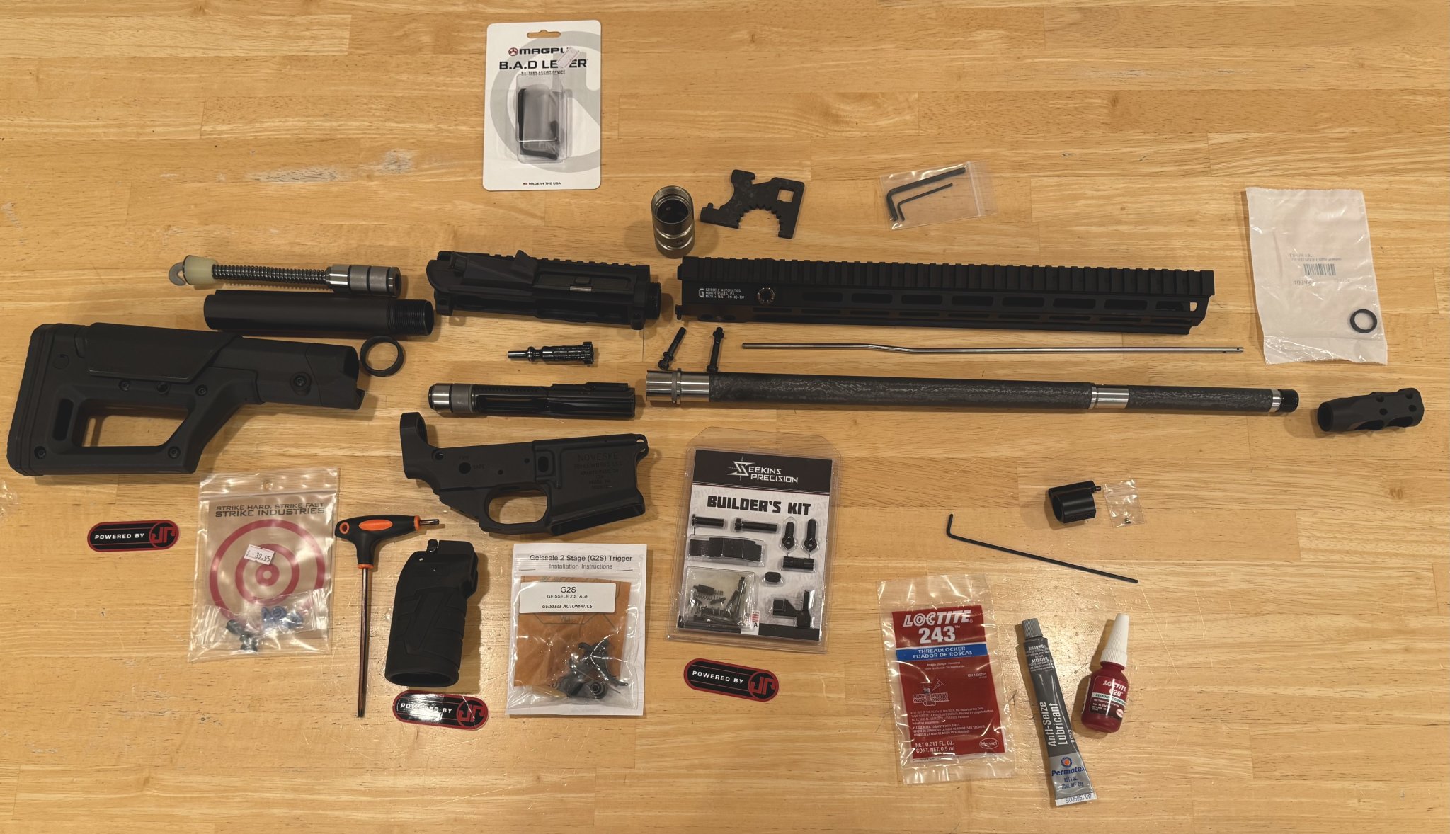

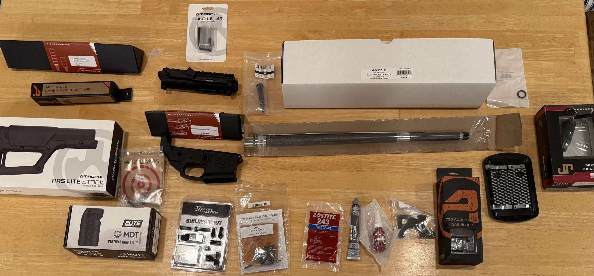

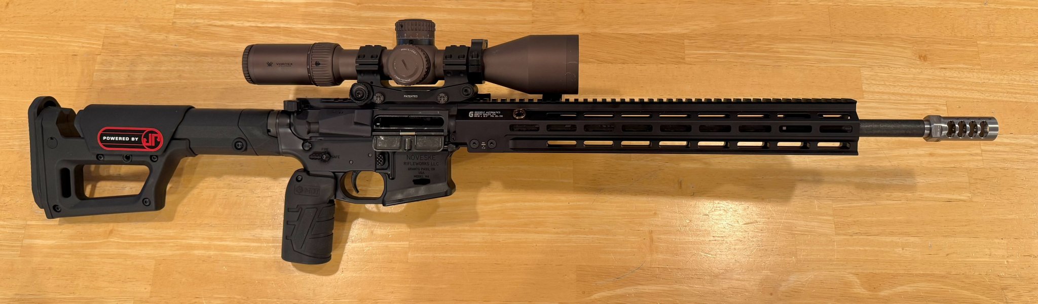

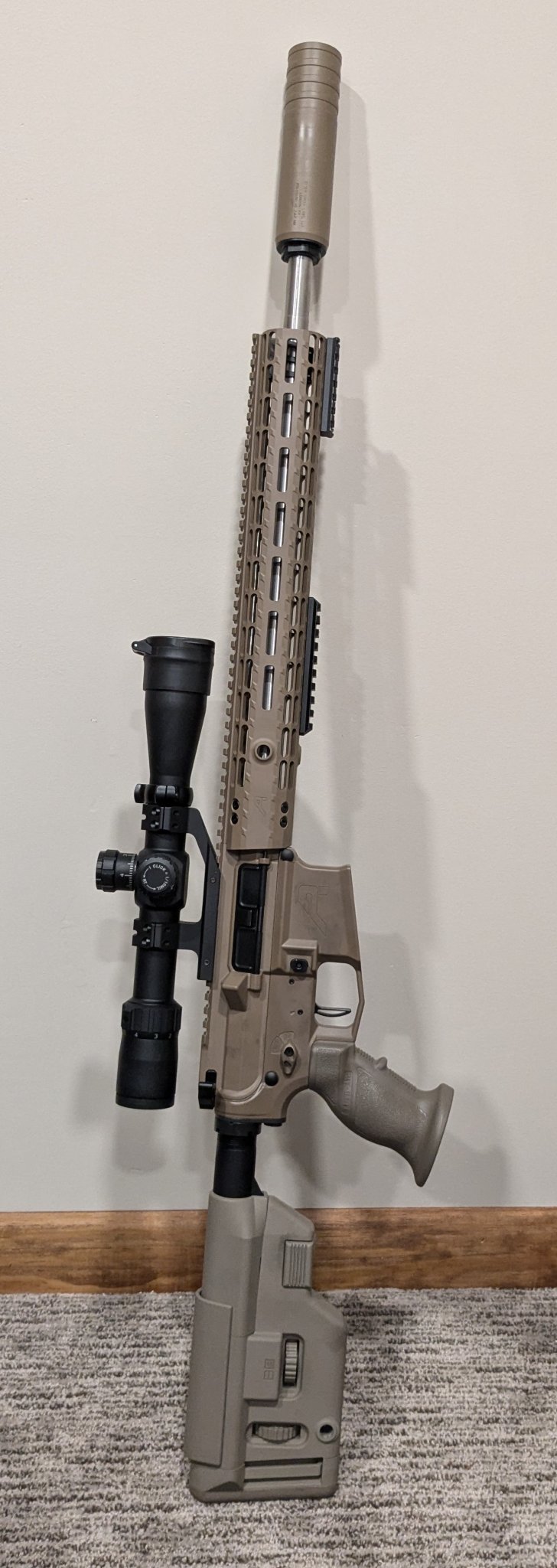

Well, got most of the parts. I didn’t think that if I bought a JP Enhanced Bolt and a bolt carrier that neither would have a firing pin, bolt cam pin and firing pin retainer…
Anyways:
Vltor upper
Proof 20 inch 6ARC 1:7.5
Aero precision adjustable gas block
Little bastard 3 comp (replaced JP)
GEISSELE Mk18 16.5 inch rail
Noveske lower that I’ve had in my safe for 15 years
GEISSELE Trigger G2S
Magpul PRS lite
JP heavy adjustable BCG
JP captured spring buffer
Seekins LPK (was missing the safety detent and spring??? WTFudge
MDT grip
Got the bedding compound, but the barrel was pretty tight, so I skipped it.
Strike industries AMbi safety was unusable. Would hardly turn, used the Seekins safety that I didn’t realize was part of the kit. Much better, as in it actually turns.
Oddly enough, my go-to for parts was Optics Planet, but they have so many options, I sometimes didn’t get the differences. Plus they sometimes have the same thing (or what seems to be) the same thing under different codes.
Got it together last night. Hope to get to the range today to at least break in the barrel and gas system.

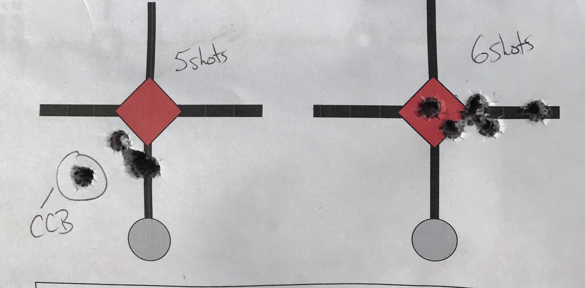

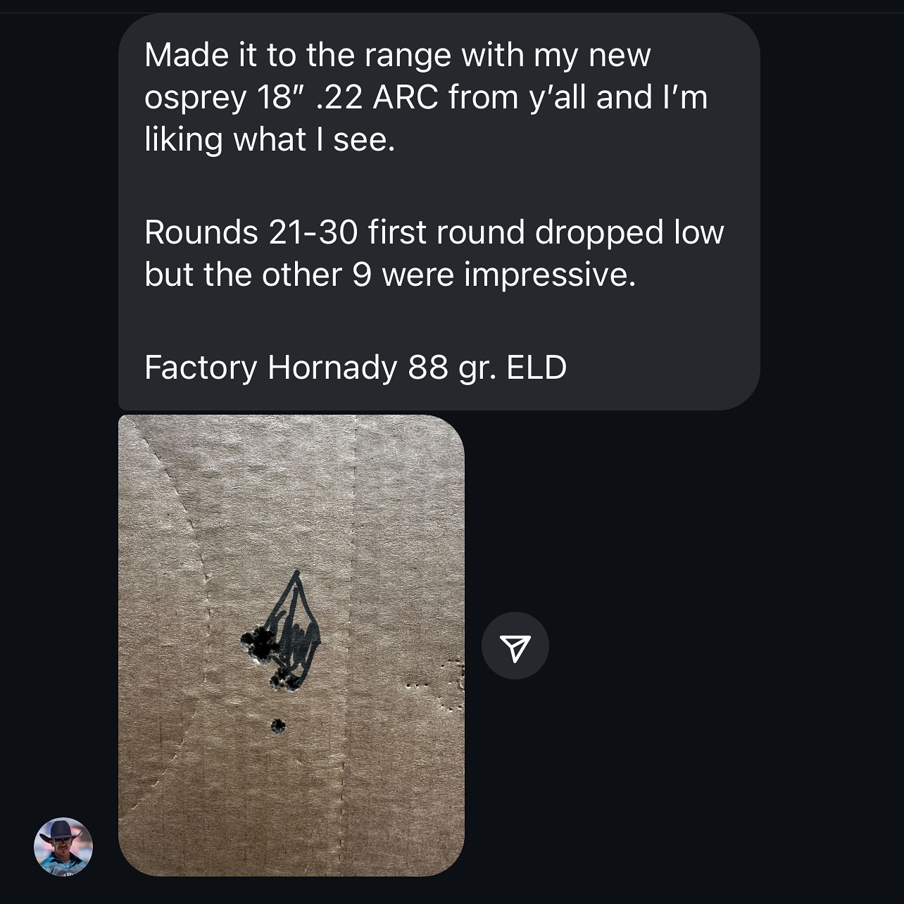

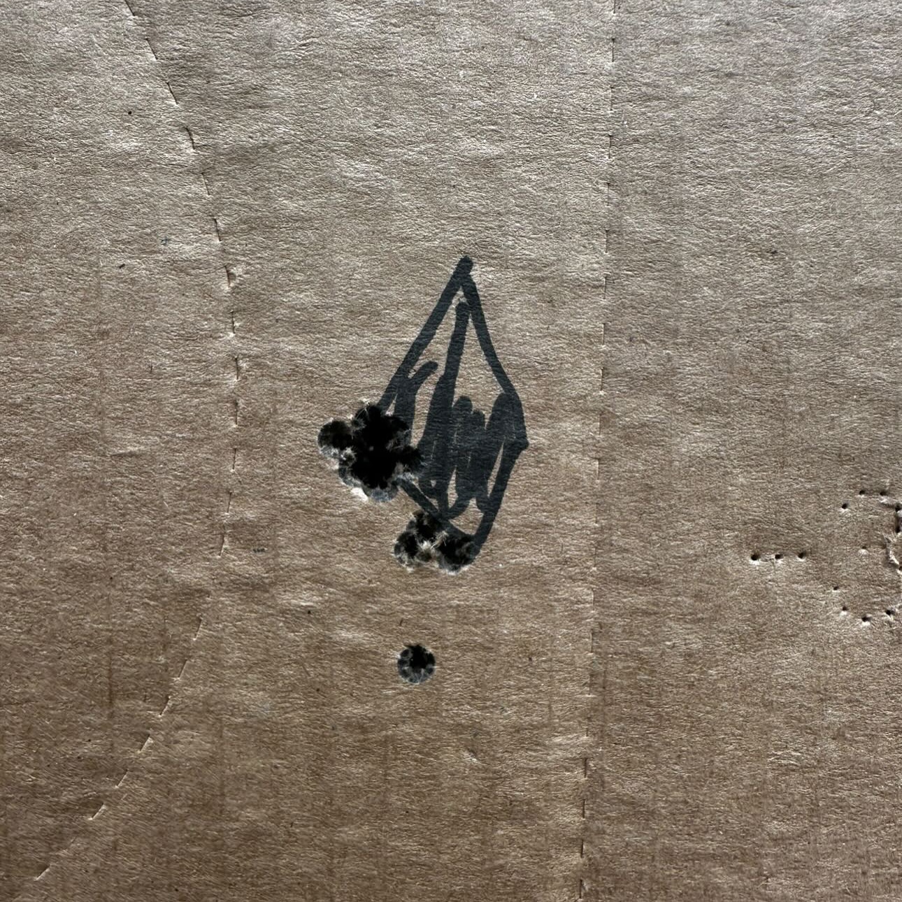

For those curious about the Ospreys I got several text and Instagram messages this weekend from folks who got to the range recently with their ARC's.
This one was the most recent: 18" 22 ARC, 7tw, Hornady 88gr factory ammo at 100 yards.
Looks like two different groups, both really impressive for a gasser shooting factory ammo.
