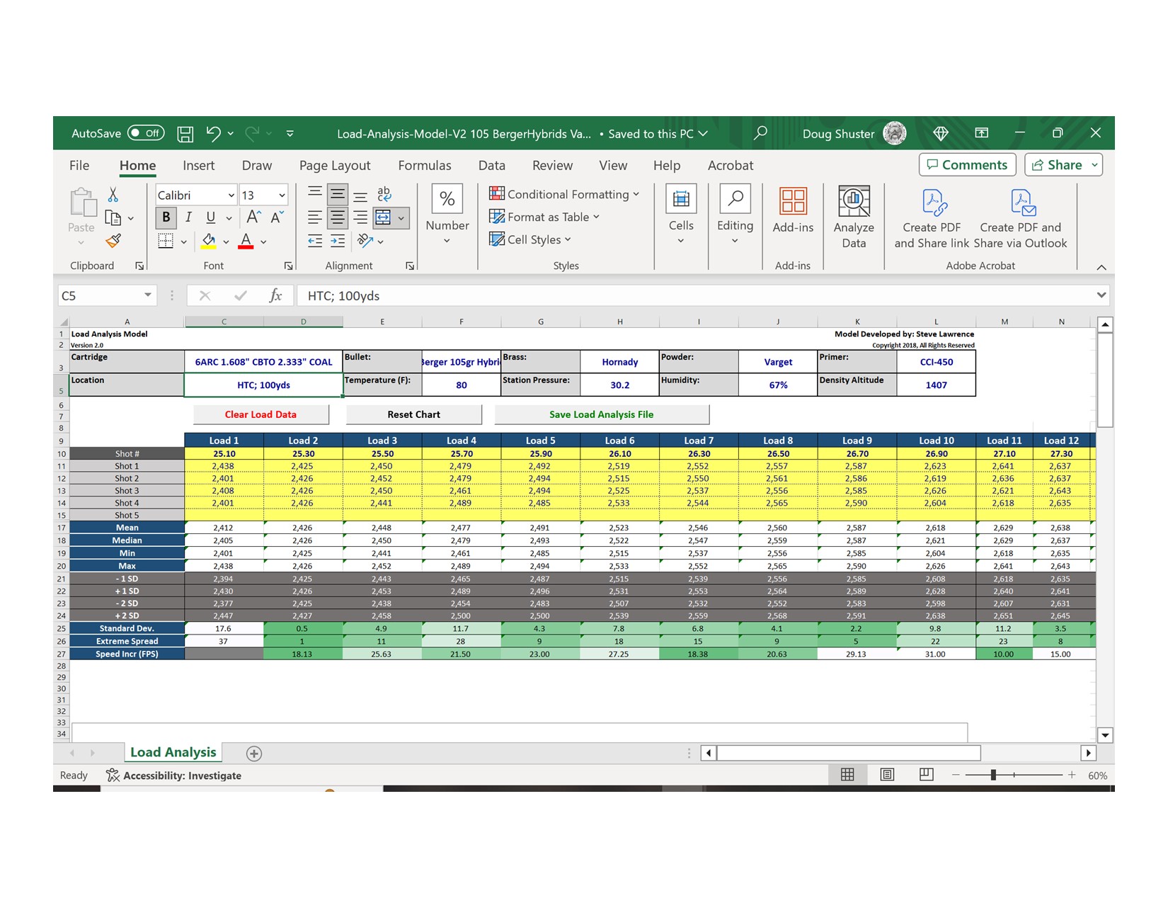

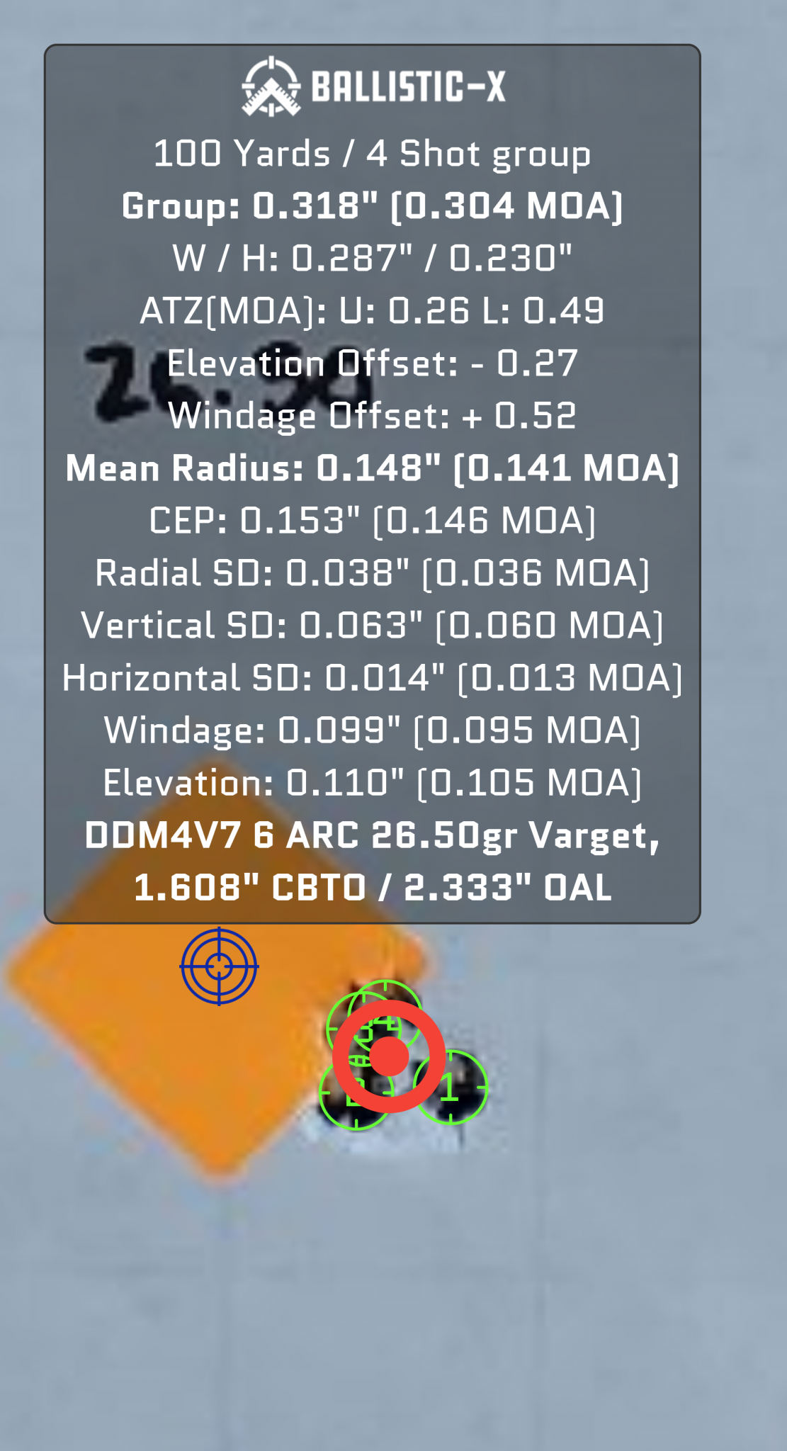

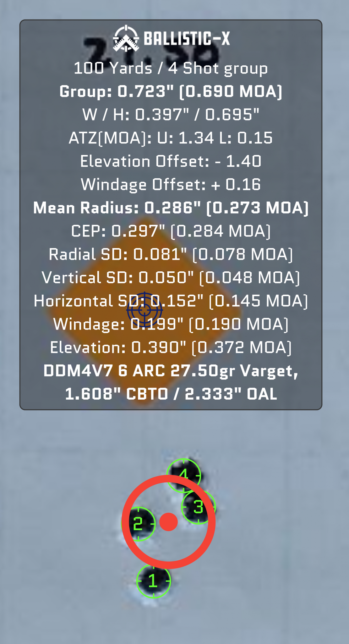

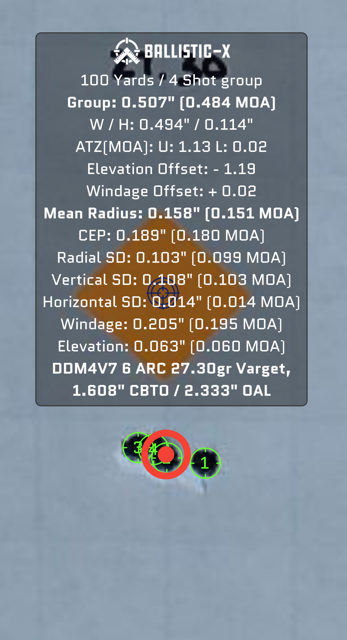

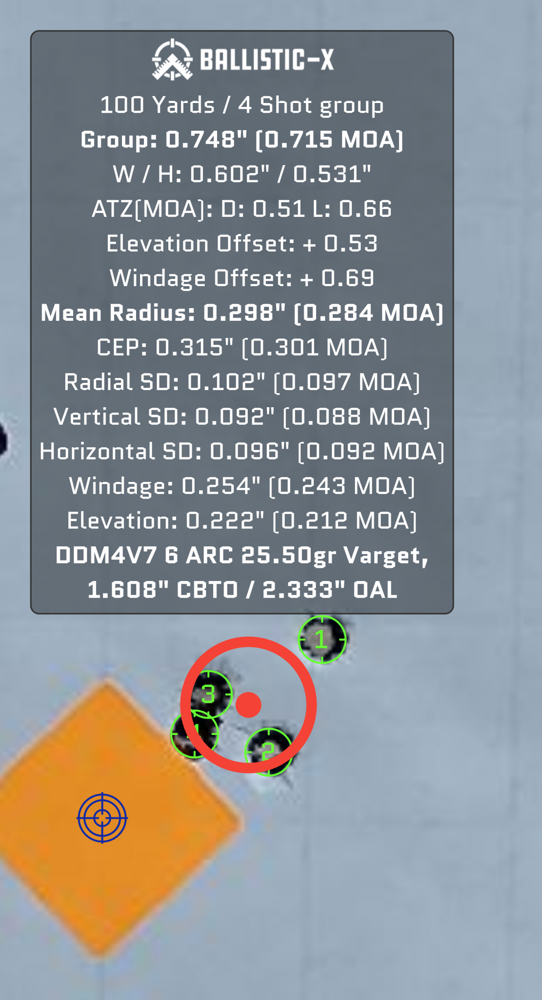

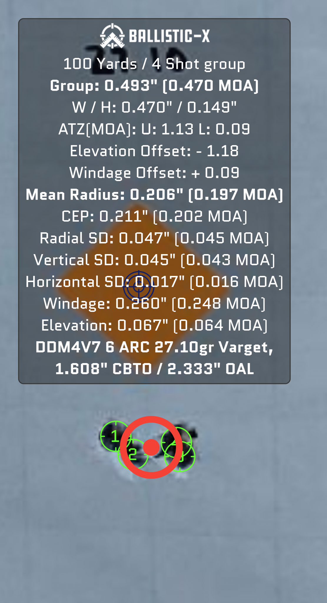

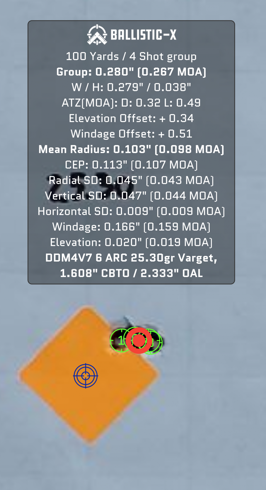

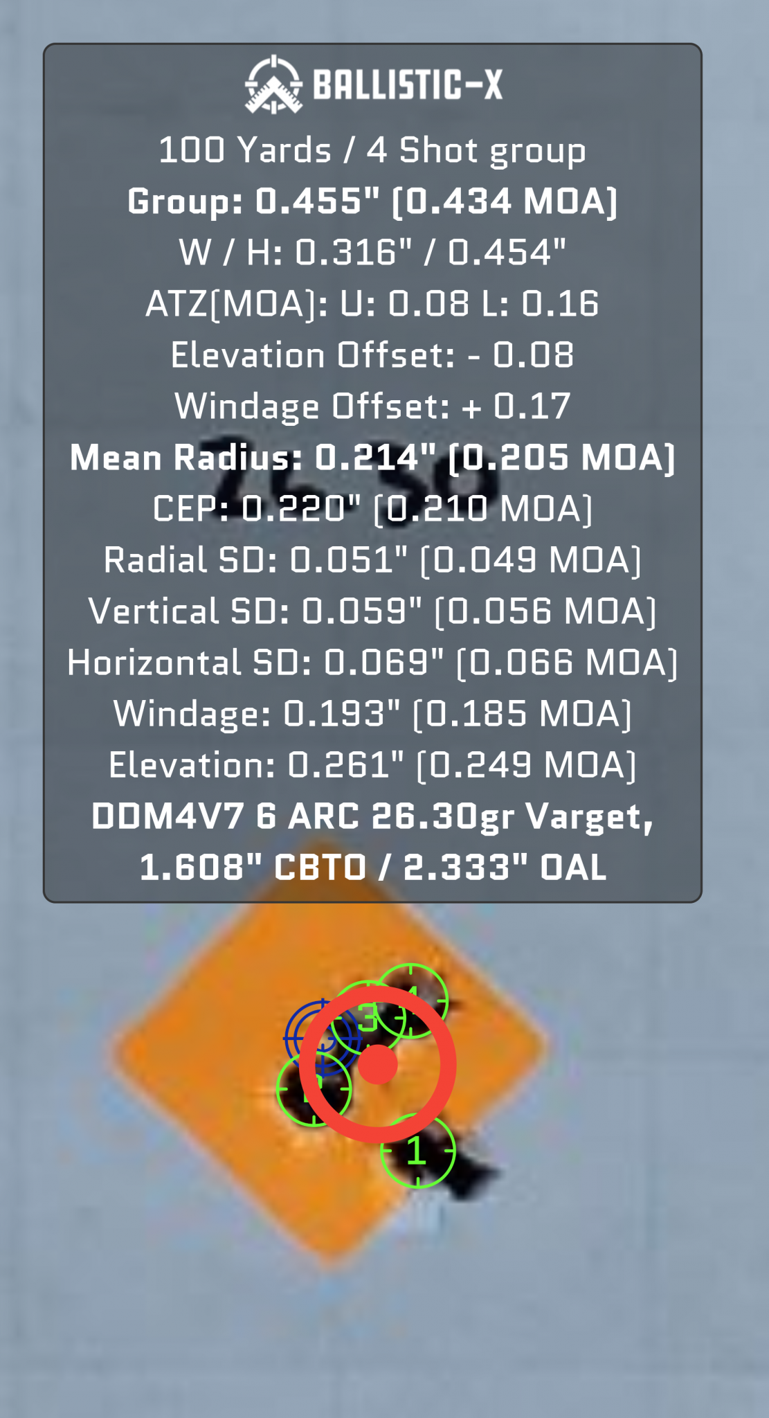

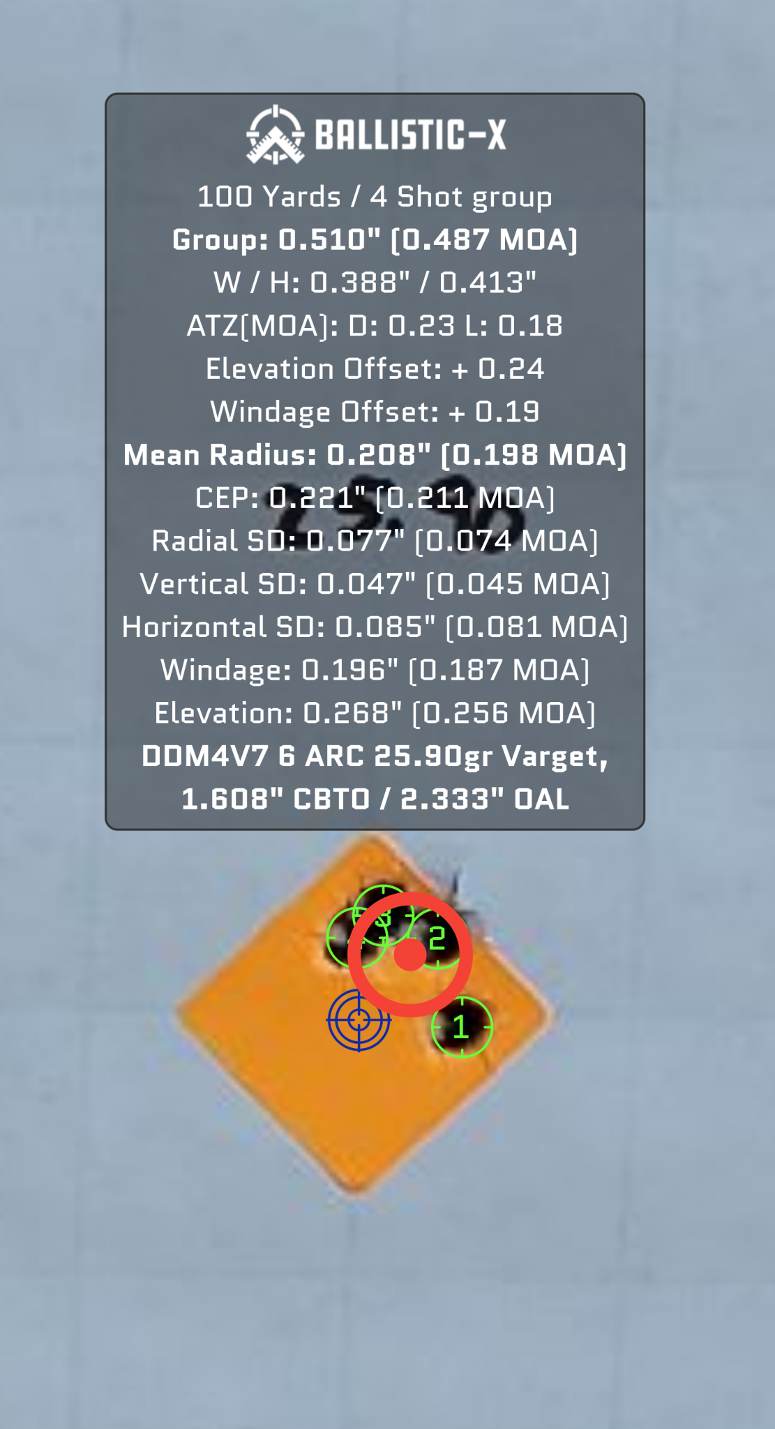

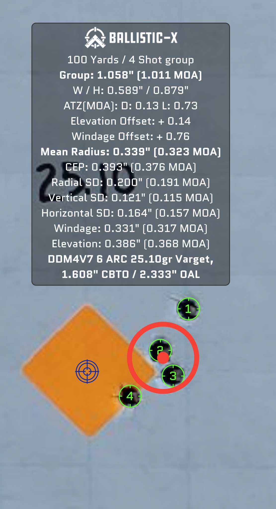

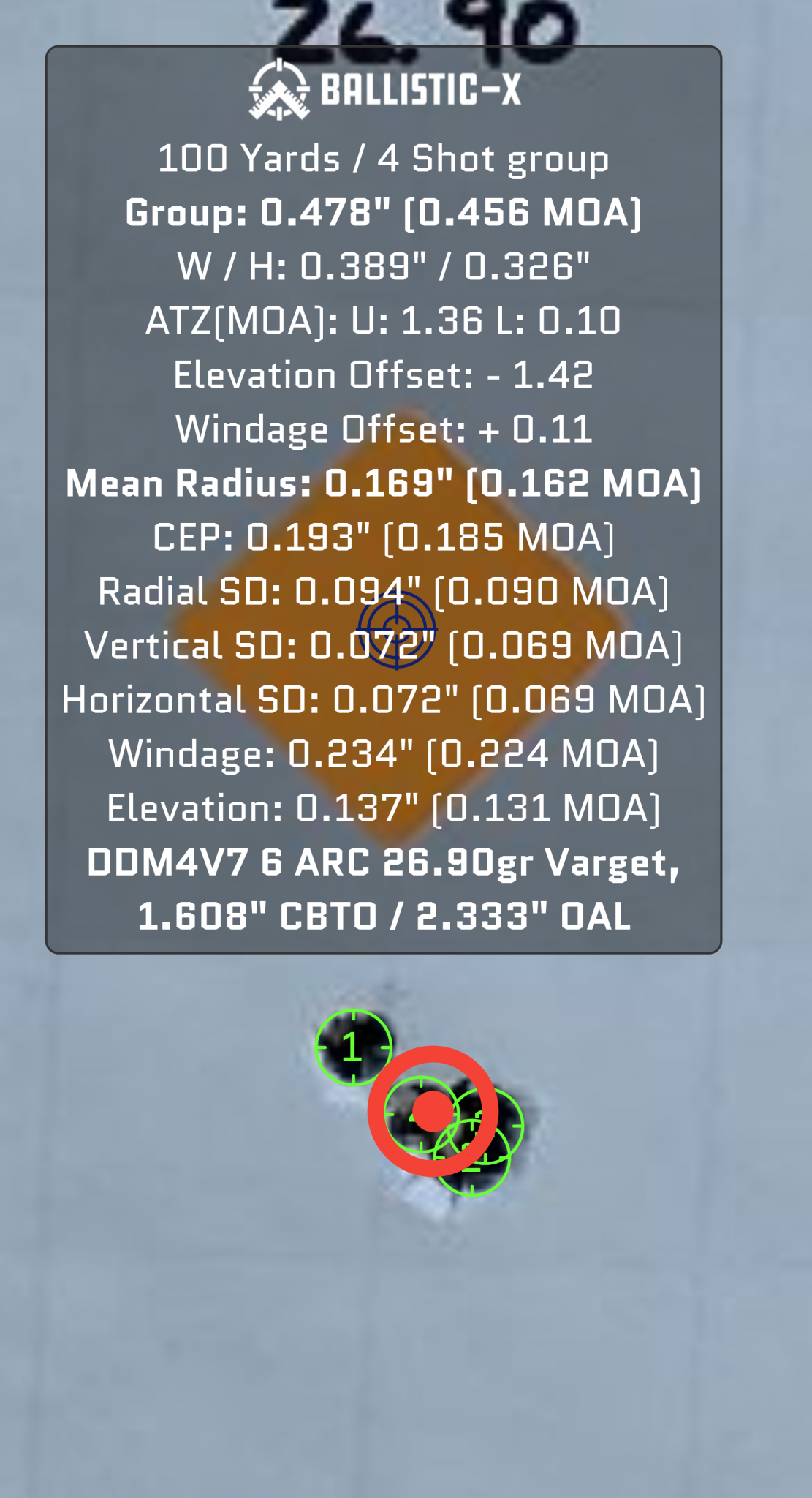

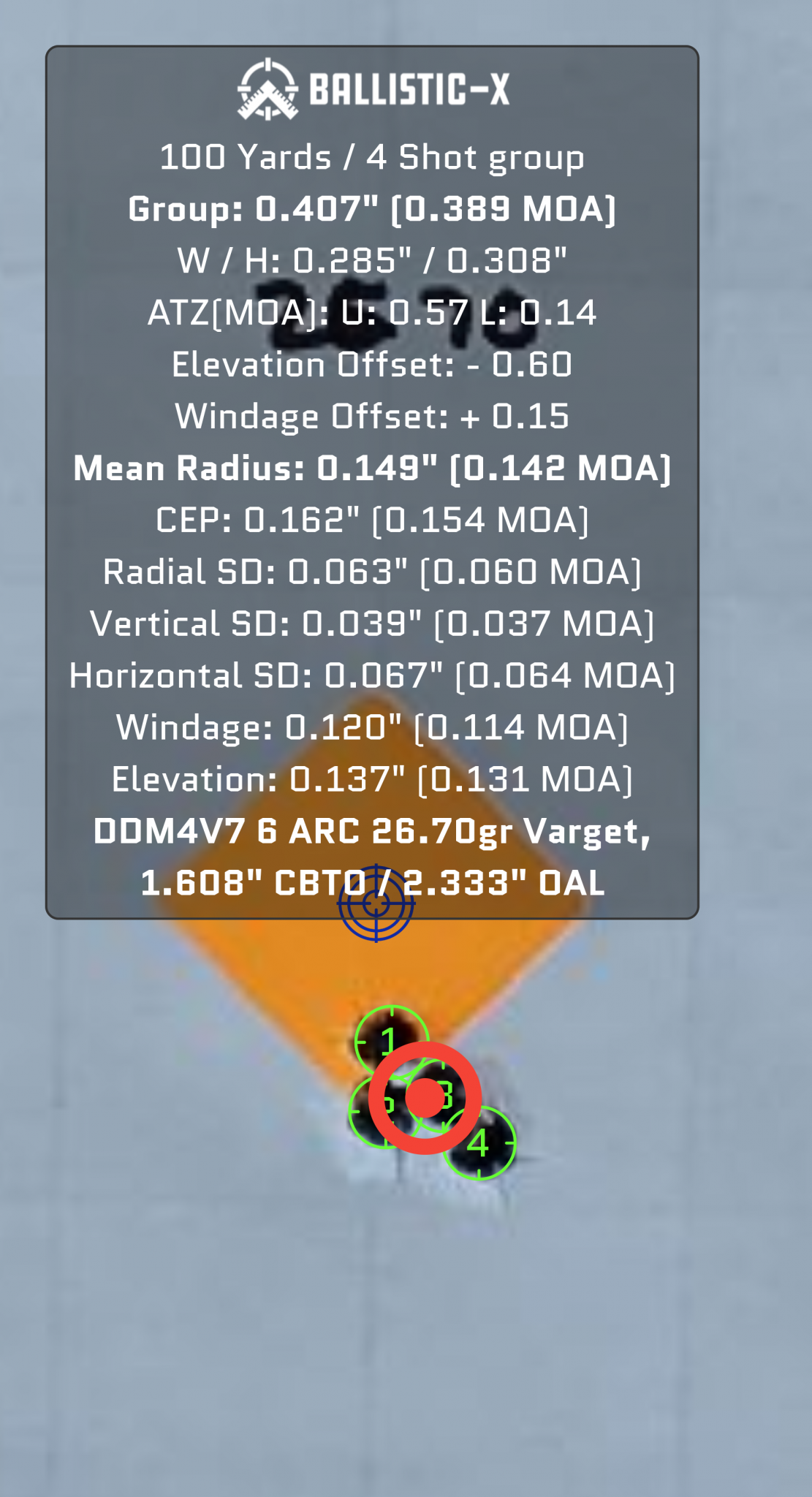

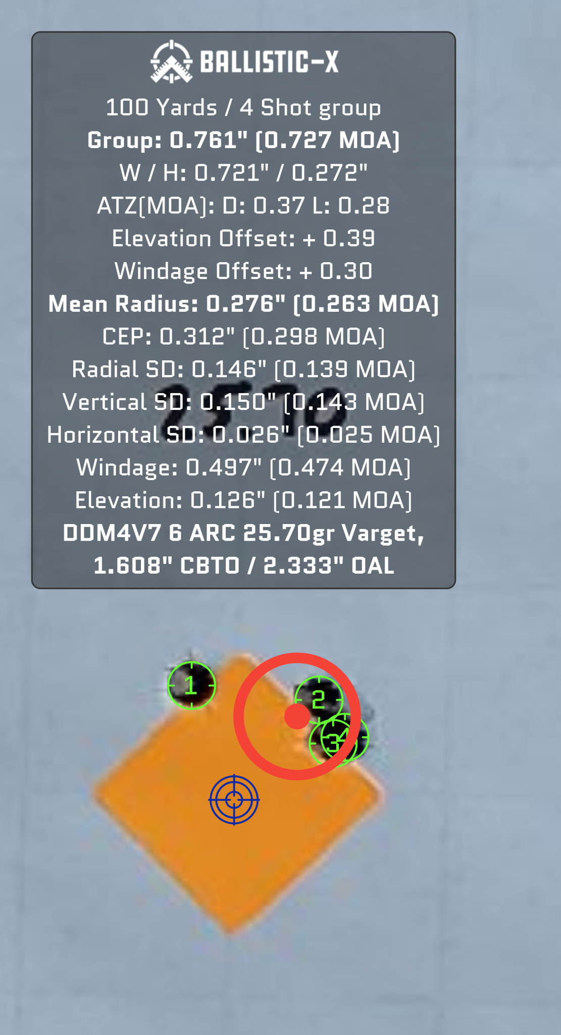

After noticing that the Hornady line uses temp-sensitive powders, I tried developing a load yesterday with Varget. I initially didn't want to use it due to QL showing the MV would be pretty low. I thought it may be better to have consistency over MV. The below results were shot at 100yds in the prone with Harris bipod and rear squeeze bag. Rifle specs are: JP Enterprises thermal-fit upper with 20" Compass Lake Engineering-chambered Criterion 6 ARC barrel which I asked them to set up for the 108gr ELD-M bullet. Daniel Defense DDM4V7 lower with TriggerTech AR trigger set at 4.5 pounds and Magpul PRS stock. Scope was a March 1.5-15x42 with MTR-4 reticle. Rifle weighs in complete at 14 pounds.
The factory Hornady 108gr ELD-M wouldn't initially shoot here in SoFla, so I took everything with me to Virginia. The temps were between 32-58F and both the ELD-M and the Hornady Black 105gr BTHP shot very well; largest groups were @ .750, smallest were @ .450 for 5 shots. Brought everything back to SoFla and the groups opened up again. So...On to Varget. I'll reload 26.2 through 26.9 in .10gr increments and see if I can spot the tightest of all. Then maybe play around with seating depths.

26.9 varget looks to be good to go?
