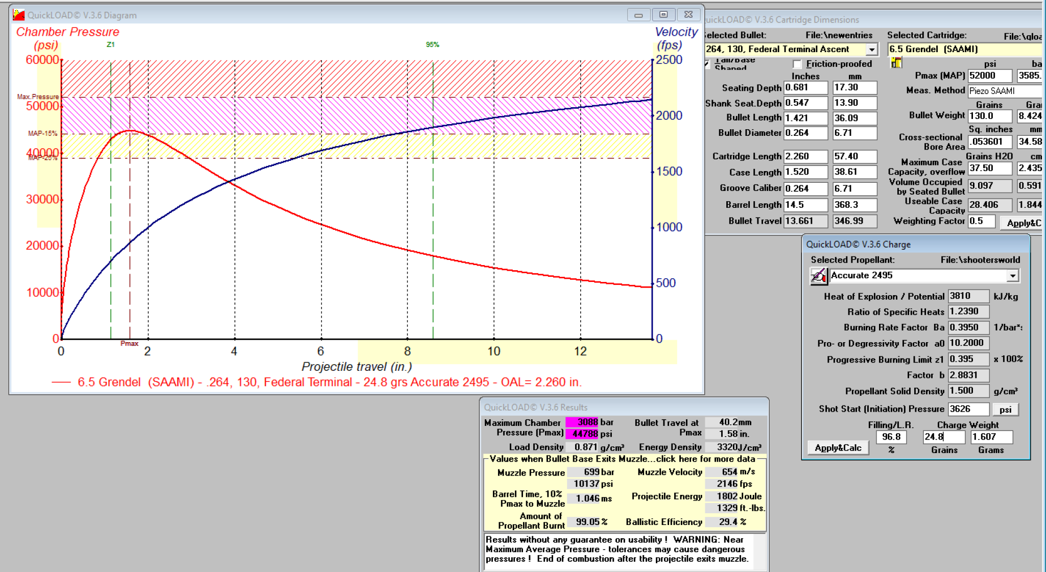

The only "magic bullet" I've ever come across that does it all is the Federal Terminal Ascent, because it's a really trippy combination of polymer tipped hollow point front end with a middle/rear that act more like the Trophy Bonded Bear Claw soft points, all in a high-BC package. Not sure if the bullets that they make for the 6.5 Creed loadings would work well in 6.5G, since they're 130s.
a quick dig into QL seems to agree it would do pretty well
according to a quick and dirty charting, 2150fps from a 14.5" barrel would make it transonic at 900yd with a G1 BC of 0.532
There’s a guy who loaded those in Grendel and got some really amazing results in terminal ballistics testing compared to all the other bullets he tested.
14.5” Grendel will spit a 130gr at 2310fps with CFE223 at 50,000psi. (2260-2359fps depending on barrel/chamber)
Same for the Nosler Accubond LR 129gr with its 1300fps expansion threshold. Those are at normal 2.260” COL lengths, not pushing them out a little more.
I tried CFE223 and actually got a better velocity and burn curve from the Accurate 2495. CFE223 takes longer to fully burn up and will cause more throat erosion over time.
