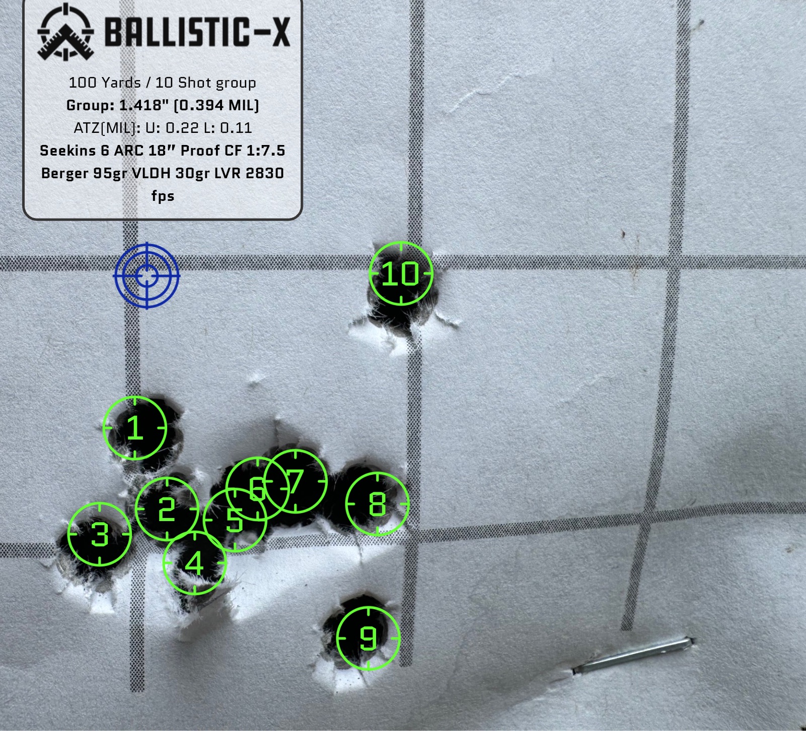

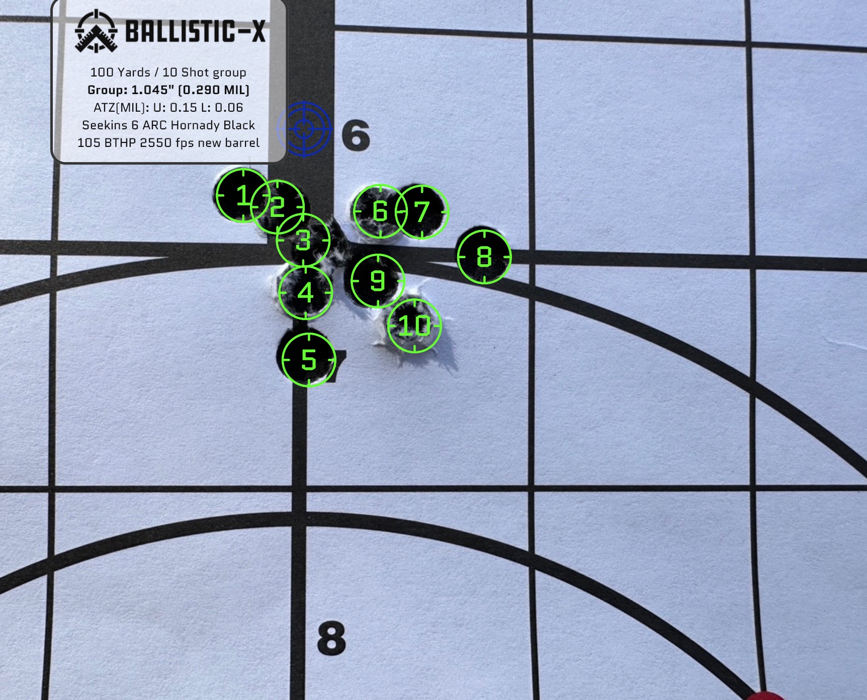

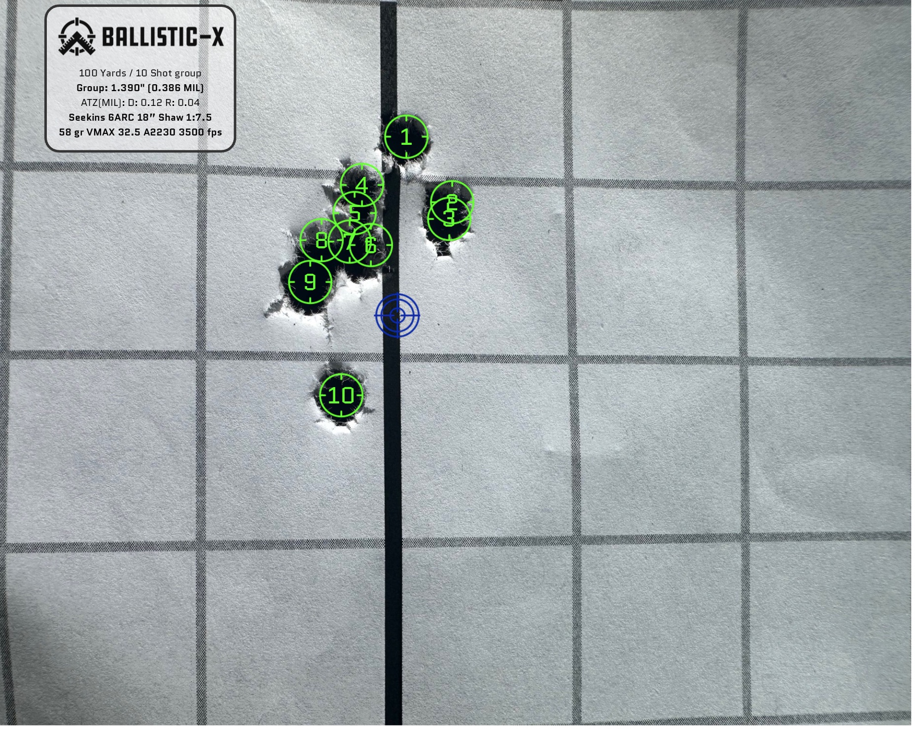

Here’s two random 10 shot strings I found. A Shaw SS barrel I sold and my Proof CF. Seekins builds. Both 18” probably me with the fliers but who knows. 1 MOA would be awesome, 1/2 is unrealistic.
Ballistic-X-Export-2024-01-28 17:21:29.465939.jpg
Ballistic-X-Export-2023-07-27 18:07:57.817547.jpg
Ballistic-X-Export-2023-03-21 15:57:25.810625.jpg

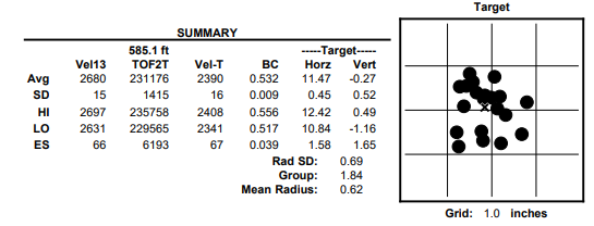

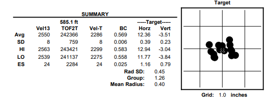

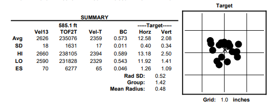

I got 2nd place in Gas gun for the season last year with a 24" Bartlein 1:7.5" bull barrel in 6mm ARC. If I recall it was within 5 points on the match and came down to a single stage that Jeff beat me with his 22 CM. Cartridge/rifle wasn't the determining factor IMO-- Jeff shot a better match.
At any rate, here are a couple of test strings from development of that system. Bear in mind these are at 200yd so cut in half for MOA. ETA: Also bear in mind I don't usually take the time to update environmental data in the Oehler system so the displayed BC's are not necessarily accurate.
Was messing with the factory 108 Match powder (similar to LVR) and 110 Atips. Didn't like the velocity spreads and didn't run it.
15 shot string with book max charge (gas gun data) of Varget and 110 A-tip. This ran slow but was what I ended up taking to the finale.
20 rounds of Factory 108 Match. Ran this early in the season at Cameo.
In my opinion, you can reasonably expect 3/4 MOA from a gas gun for 20 shot strings and to get much better than that the stars have to align. This is from a bench, bipod and bag with consistent fore-end loading. There are a bunch of sub-1/2 MOA 5-shot groups in what I just posted above but that isn't indicative of the capability of the system. It was a 3/4-1 MOA rifle that could have the MPOI pushed around by as much as .3-.8 mils depending on handguard loading-- which is the real weak point of the gas gun game. I have shot 3/4 MOA bolt guns in the same style matches and finished top 20 or even top 10. The MPOI movement made my gas gun finishes in the 60th-90th place range.
