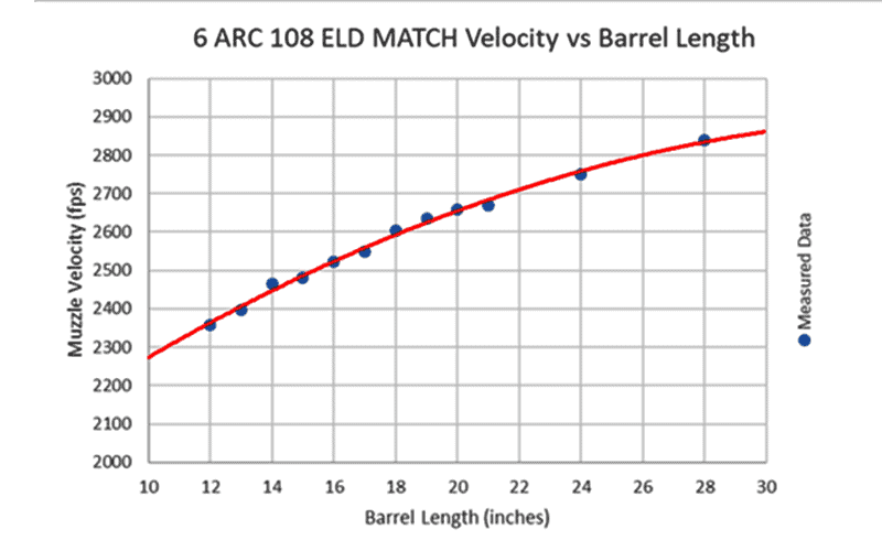

Been wondering the performance of a 6 Arc out of a short-barrel? Maybe12.5? With the velocity as it is did anyone have any idea how much velocity you would lose? Would it end up being a 6mm blackout basically?
Seems like most of the barrels are made in 18 in. The people have SBR Grendel's
The free Hornady load data for 6mm ARC and 105-108gr bullets on their site has velocity info on the 12.5”. I am waiting on a 10.5” barrel, but once I get it will have some more info for that length.

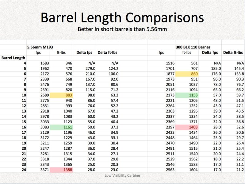

That is a myth and has been disproven time and time again. Somehow it's repeated in every blackout thread I've ever seen though. 95% of modern powders burn within the first 3 in of barrel. If its saying complete powder burn, 223 will do the same. If it's saying you stop gaining muzzle velocity that's just wrong. Maybe what they're trying to say is you don't get a big Fireball from the expanding gases?
But again, most (if not all) modern powders (pistol - 308 type)burn within the first 3 inches of barrel but containing the blast and harnessing the energy for a longer period of time gives you more muzzle velocity. With Blackout you see substantial velocity gains well past 16"(2400 fps). About 25 fps per inch which which is about the same 223. Any of the blackout Test with different barrel lengths on YouTube can show you this. Jrb or Johnny's reloading bench did a good series on 300 blk comparing 16" to sub 10" barrels.
The first 50 hits on google alone would make me ask for your sourcing on that...
However, I’m the first to agree that “conventional wisdom” is often interchangeable with “shared delusion.”
That said, from personal experience alone the blast and fireball from more overbore cartridges out of the same barrel length absolutely increases. Some of that translates into added velocity, which is why I usually see 50-35fps/inch from 16-20 for .223 and 25-20fps/inch from 16-20 for 300blk.

That advice is still not correct. Go with the length you need to achieve your goals. I'm putting together a 10.5" 6mm ARC because I'm fine with the velocity reduction; I'm not expecting to make first round 1000yd hits with it, and I want the shorter barrel. Nothing "bad" is going to happen, I'm just giving up velocity. I shoot suppressed with a sacrificial brake, and it's a Sandman S, so erosion isn't a huge ordeal.
What is true - the more overbore you are, the more velocity you start losing per inch as you go shorter and shorter. You just need to determine what velocity you need and work out your minimum barrel length with that cartridge - if it fits your desired length, awesome, if not - pick another cartridge.

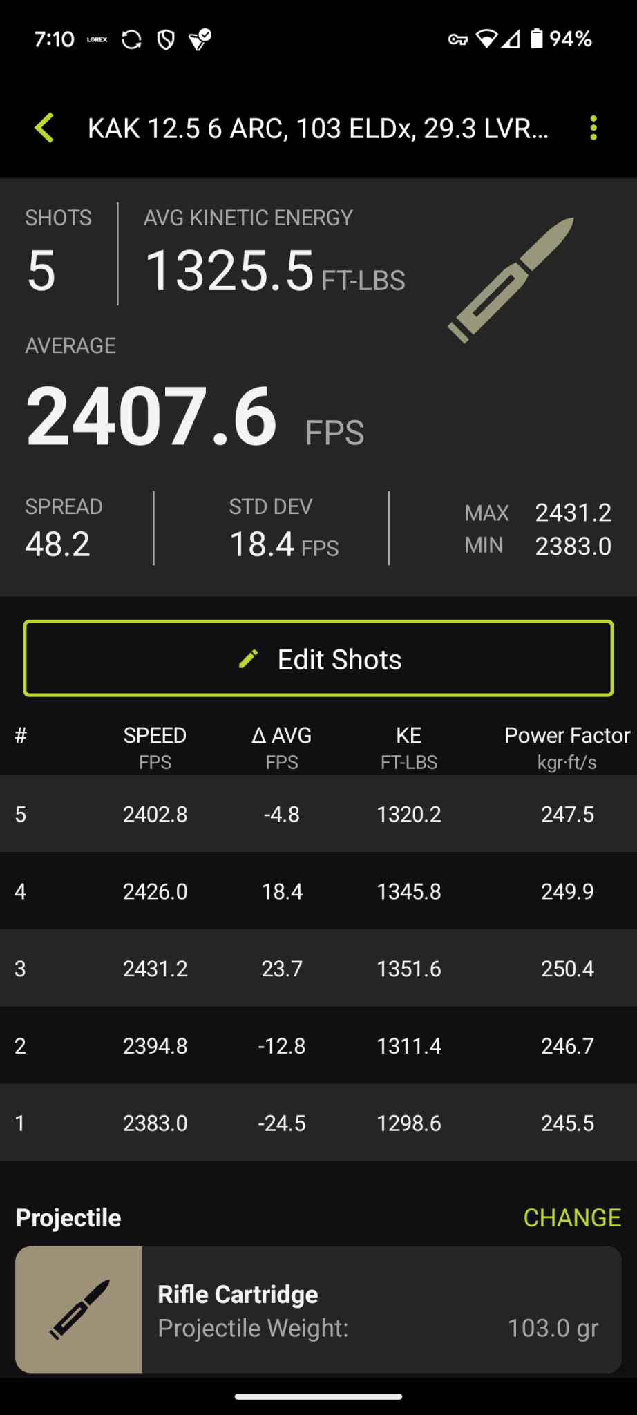

Old thread, but this is relevant…
12” Monster 6mm ARC Barrel- five shot group averages
ELD-X 2343 fps and 2344 fps w/ five shot group sizes of 1.34 and 2.52.
TAP LE load 2347 fps and 2335 fps w/ group size 2.5
All in all, not pin-point precision. Out of my 18” Odin barrel the -X was .88 and .53 moa. Still, for intermediate hunting distances a good short barrel will be fine. And keep in mind, my 12” has a 1-8x with course crosshair reticle while the 18” wears a 2.5-20x NightForce with a fine dot for an aiming point. I used max magnification on each scope to shoot the groups
I have to put a better scope on the 12” and shoot some more to see how it stacks up.
