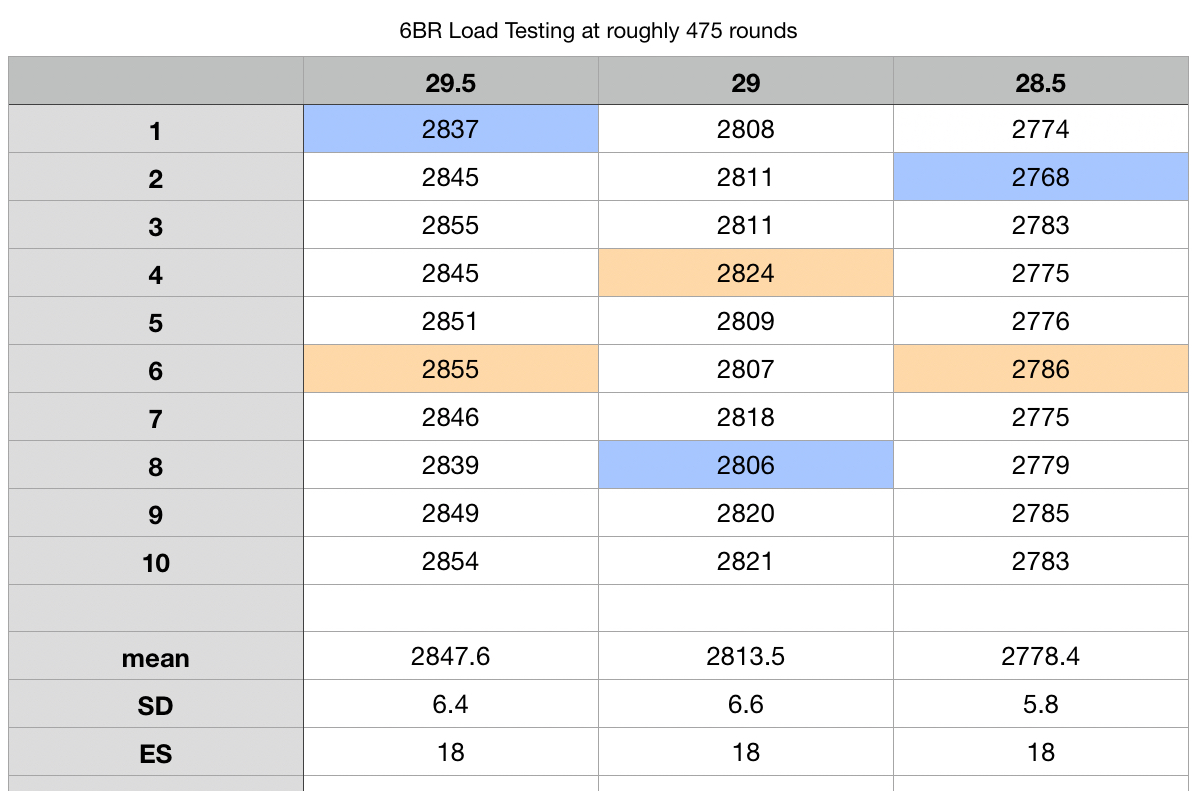

The rifle now has 3 one-day club matches and about 500 rounds now. It has changed quite a bit since the original post in Feb.
Components unchanged as above, I was loading 30gr. A typical 10 shot string would yield the following results:
mean 2890
SD 10
ES 30
I went back to the range with some reduced loads and obtained the following data:
On the target, there was vertical stringing with the 29 and 28.5gr loads, while the 29.5gr load looked pretty good. I can only resolve 5 of the 10 shots on the target, so that’s the best I can do with the target analysis. The other 5 shots are in there somewhere! 😀 I’m nowhere near as good a shot as some of you guys are, but I think I can improve on my results at competitions with this load.
Ballistic-X-Export-2024-07-07 12:54:36.080199.jpeg
So, I’ll probably stick with 29.5gr unless something changes over the next 2,000 rounds!

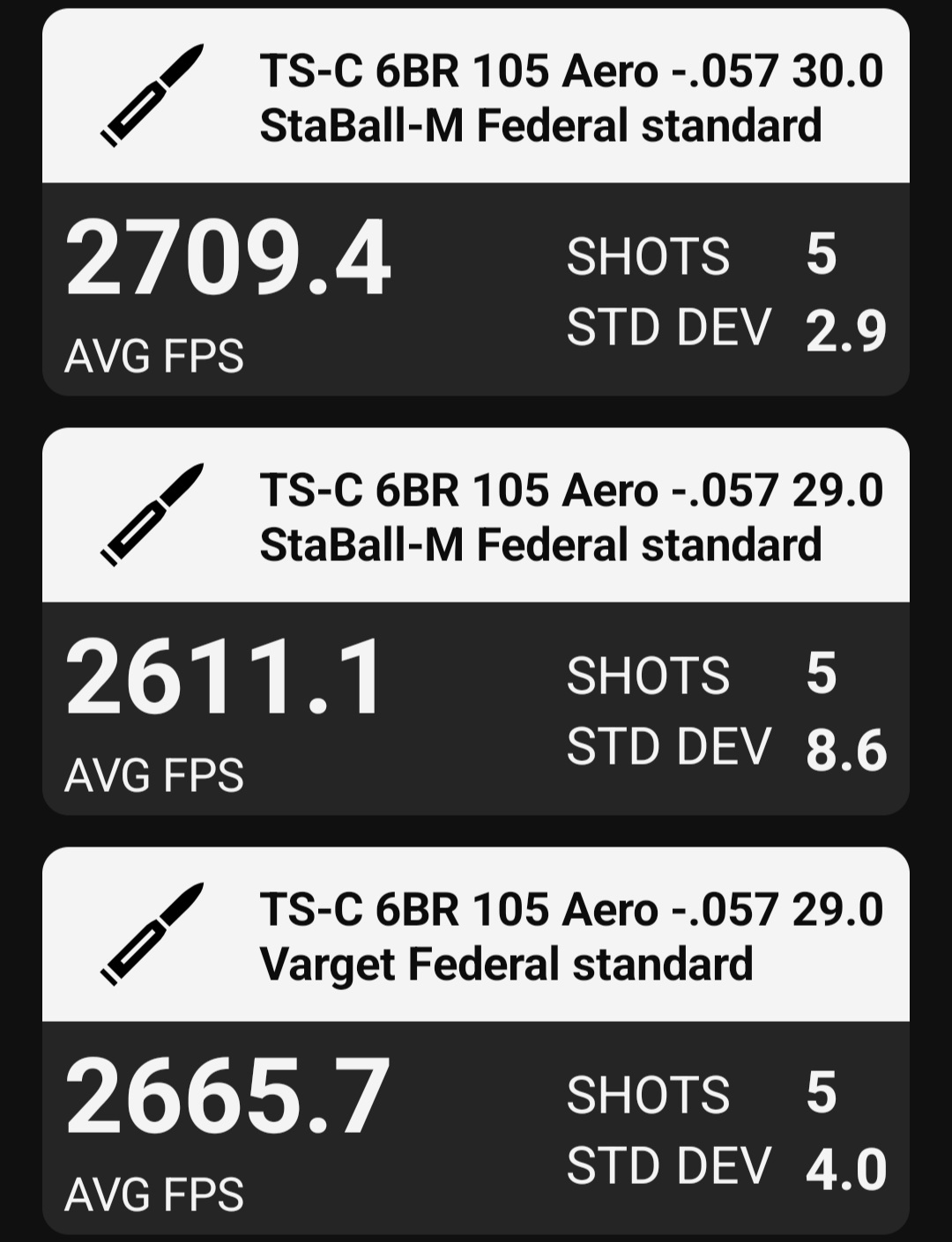

So,.... Staball 6.5 works well in the 6mm BR Norma? what is your charge and velocity?
At work, I have to take a look at my data at home. Tried it a couple of years ago when Varget wasn’t available.
Will try n150 next, but it’s not a ball powder.
Also have in mind that I’m shooting steel with mb’s, not competition or bench rest.

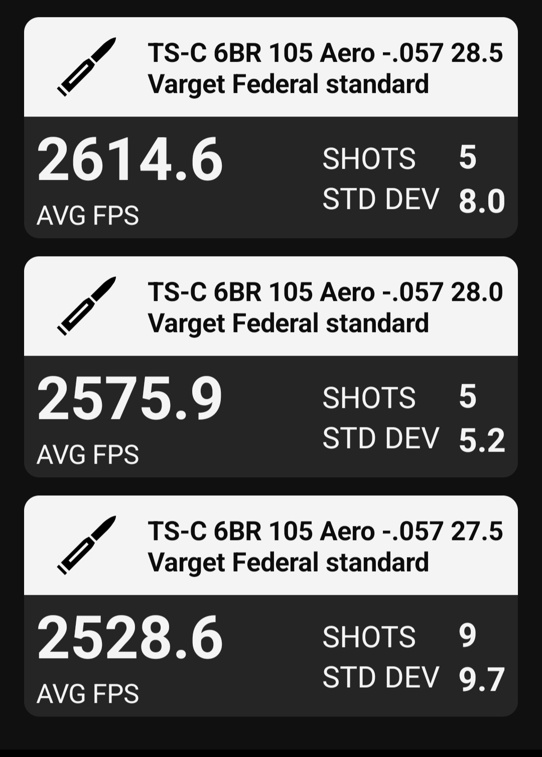

First 35 through a new barrel. Joining the 6BR club. All Horny Hybrid's (Aeromatch) seated .057" off in new Lapua brass and Federal standard primers.
Nice to see I have a cartridge that might like staball match. Unlike all my other calibers I've tried it in I had zero hang fires with this combo and it seems to want to group too!
