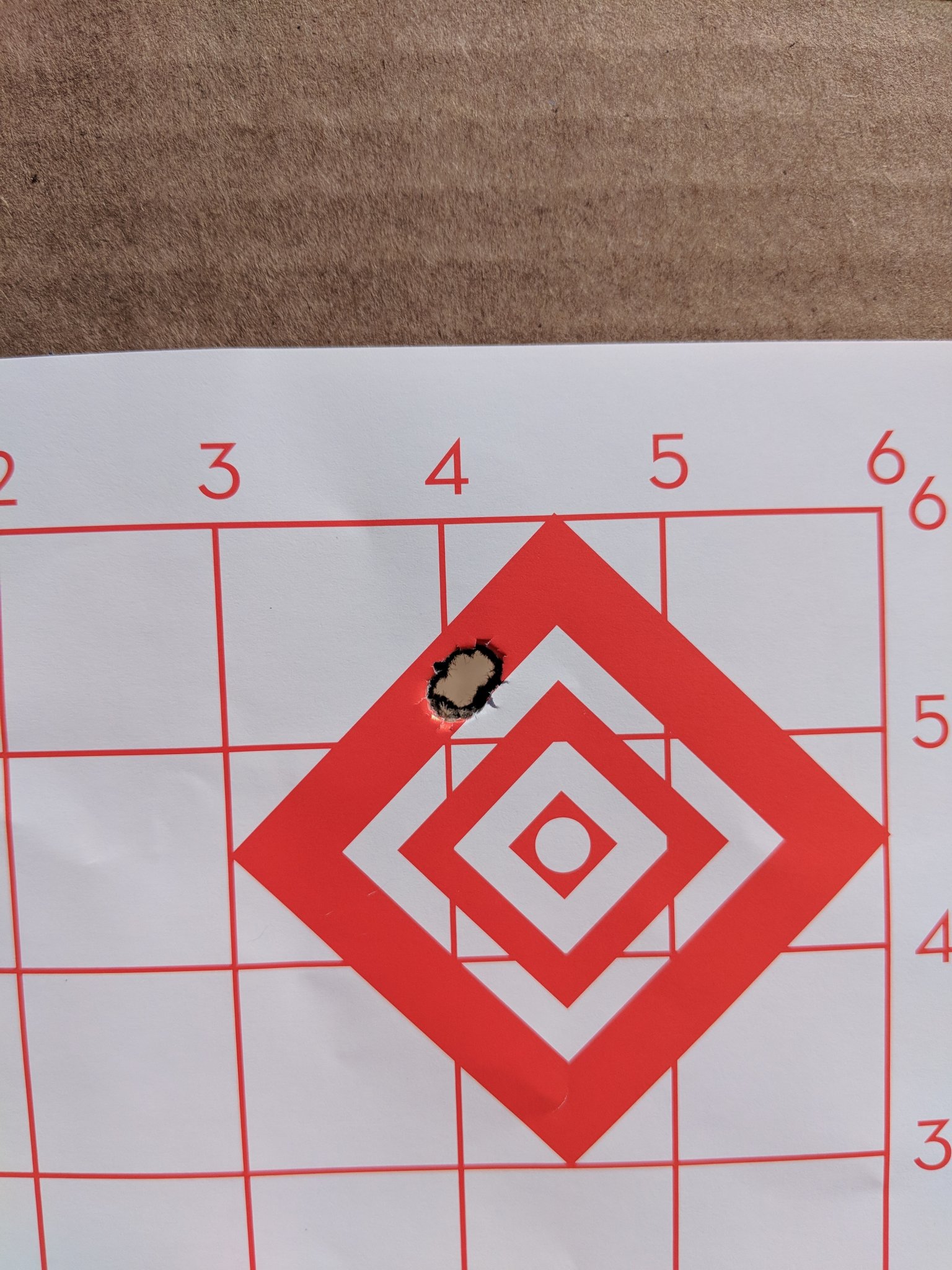

Why? 6BRA is super easy to fire form. That's one of the main reasons why people choose it over the other 6BR variants. I don't create false shoulders or jam bullets. I literally load up the FF loads with a charge of 29.5 H4895, load a 105 Berger Hybrid 5-10 thou off the lands, and go shooting.
No split necks or any other damage to brass. It shoots damn good too, this is 5 rounds at 100 yards with FF loads:
The only disadvantage to the FF loads is that you will be ~80-100 fps slower, but who cares? I wouldn't mess with a good thing.

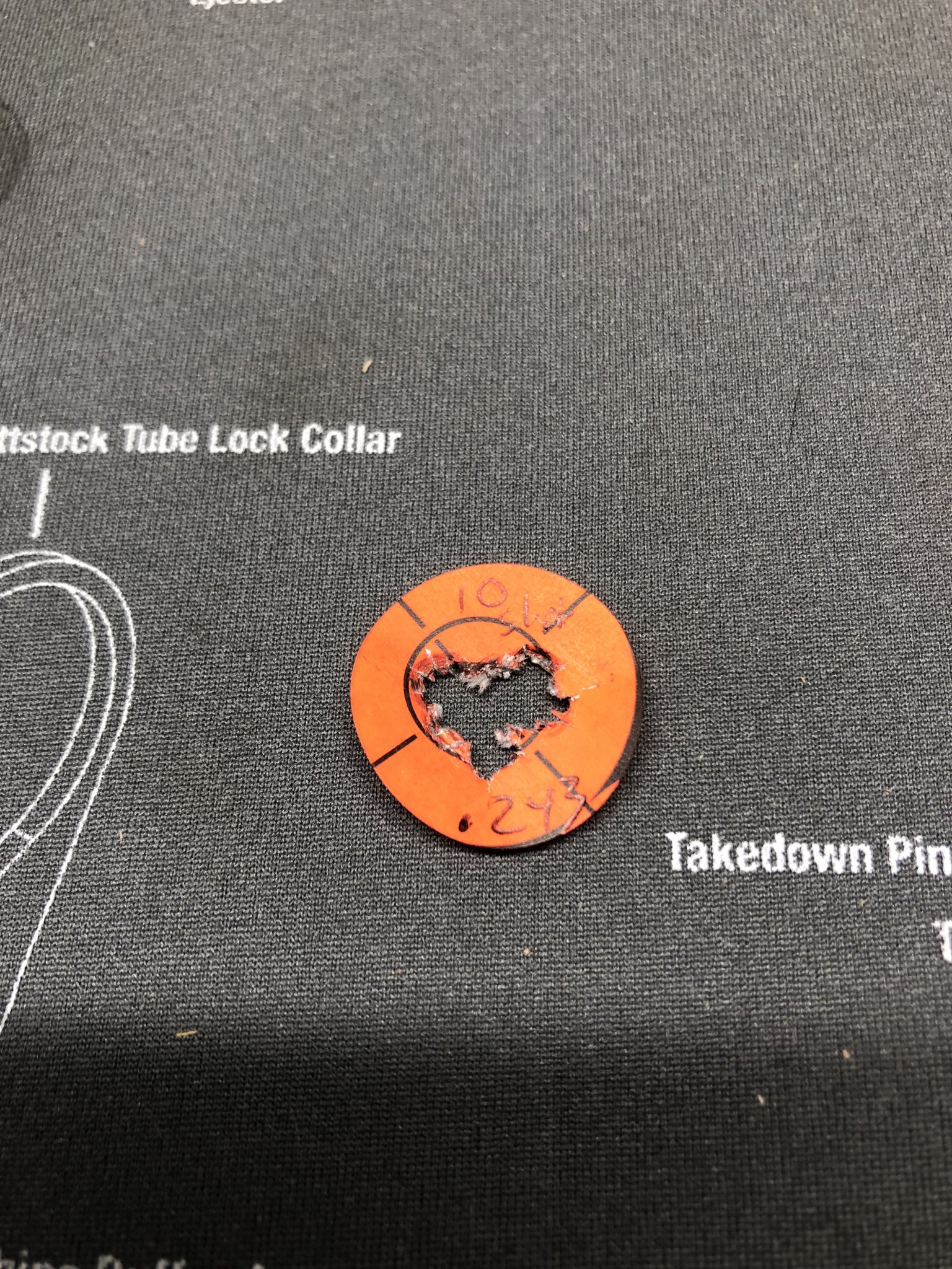

Well I finally got the gun put together and got to put some rounds down the tube, 29.5 grains of H4895 with a 105 hybrid in virgin brass is giving me 2875 out of a 27 inch barrel. And very accurate too.
