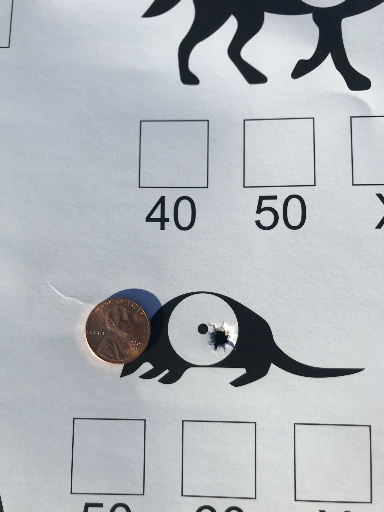

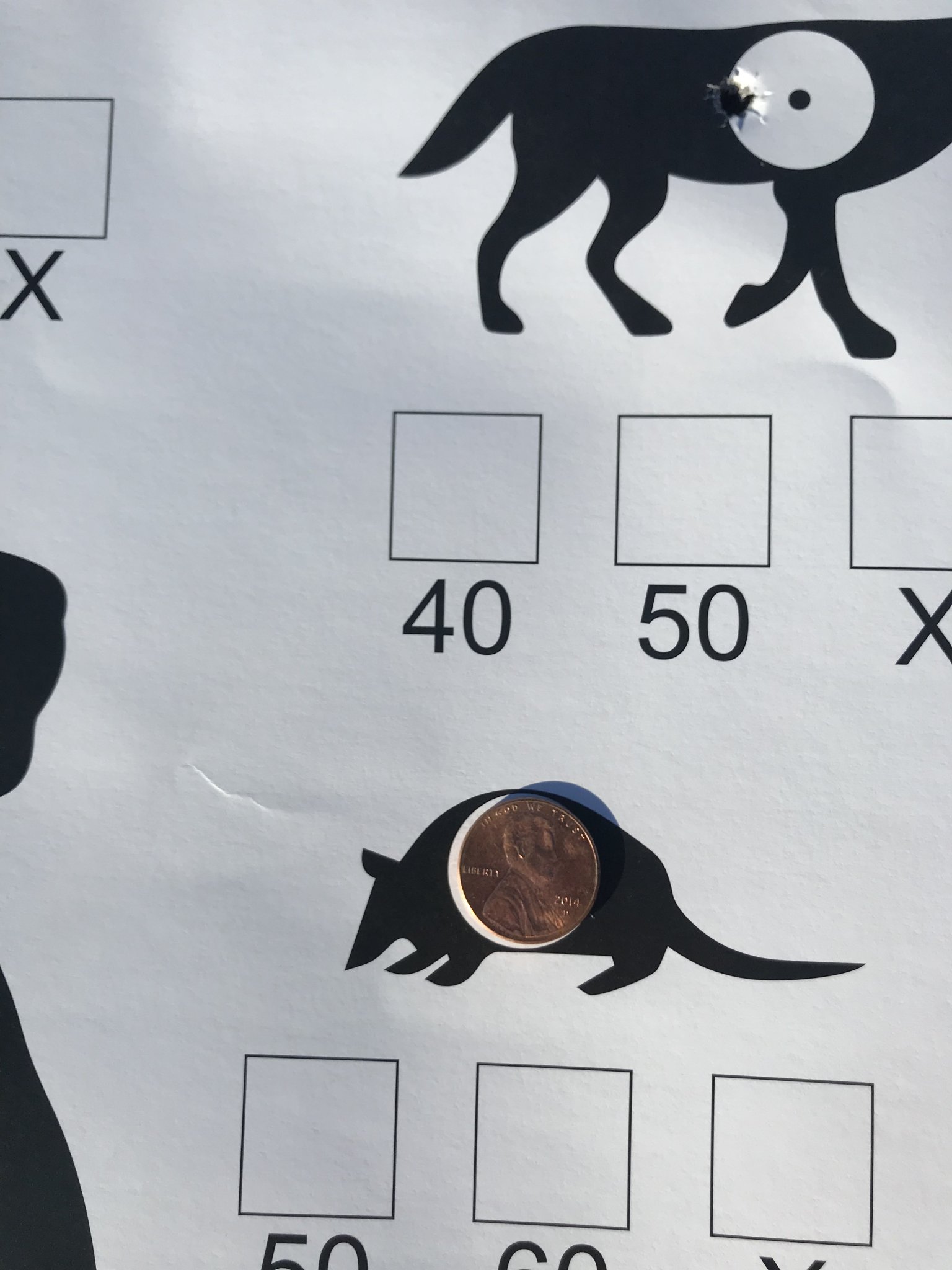

I am not sure of the velocity as I am still just screwing around fire forming. This is from a 26" Impact Precision by Stuteville that was bought pre-chambered from Impact Precision Shooting and I simply threaded it onto my Impact receiver.
The attached target is just a fun little "varmint match" target that dad and I shoot at 200 yards off a bipod, rear bag and bench. We have fun with it. These are shots 64-73 down the new barrel. Penny in picture is for "bulls eye" reference.
There was no "science" to this load, just took 6BR load data. My father also shoots a straight 6BR so I was able to piggy back off of him also.

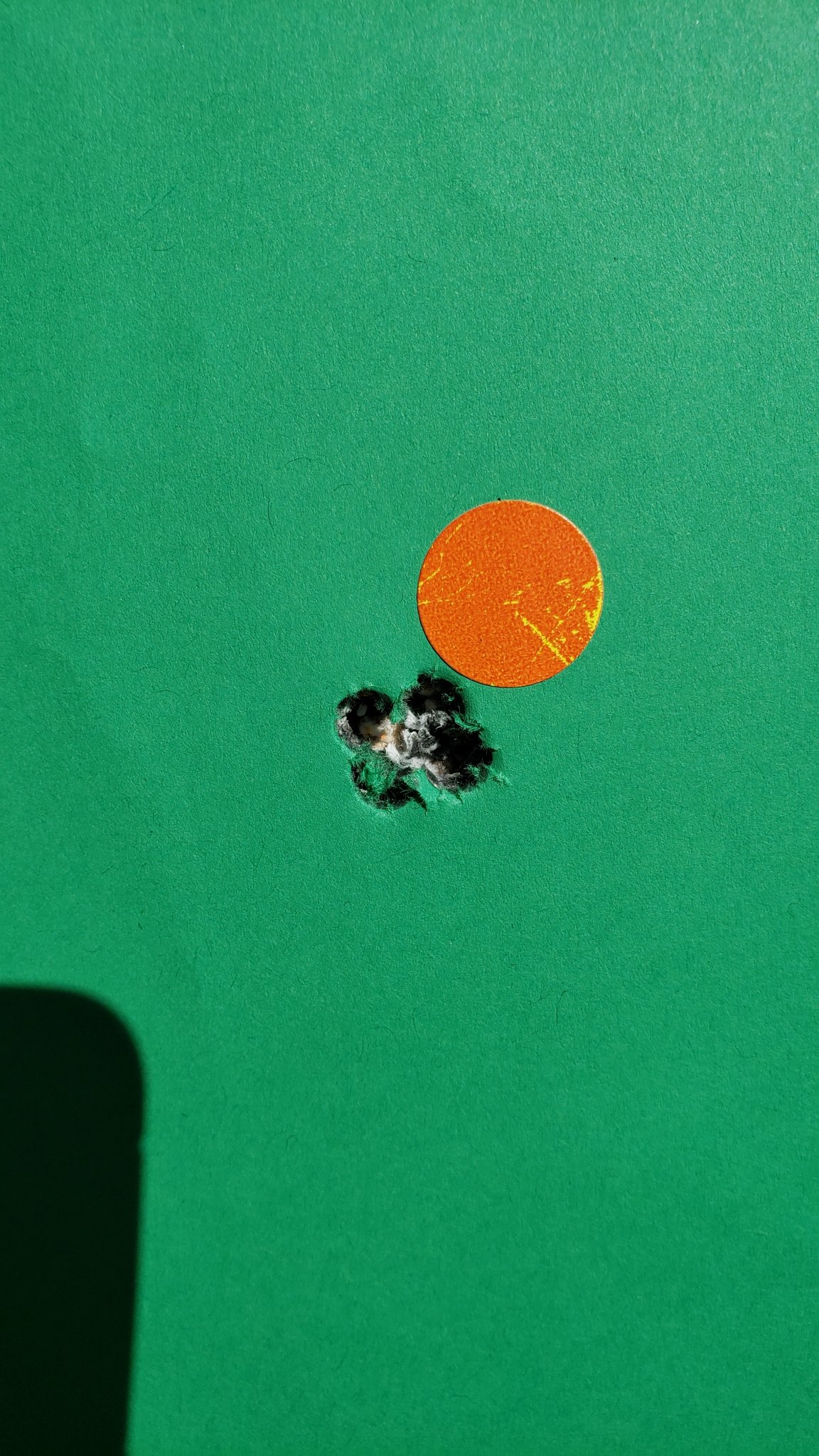

Anyone experienced mych fluctuations in lot of h4895?
I’m at 31 gr getting 2930fps. Most of the guys I know are at 30.4-30.6 gr running same speeds. Wondering if I had slow lot or just slower barrel.
