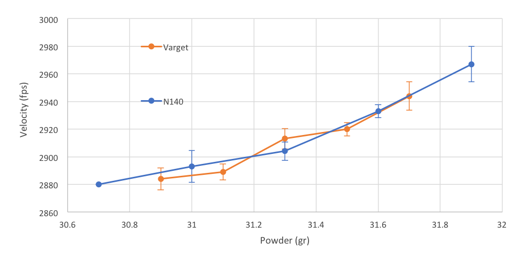

Varget and N140 have worked great with 105 hybrids for me, and had identical velocities. The Varget was more temperature sensitive in what I tested, which surprised me, and I've heard N140 is way cleaner.
