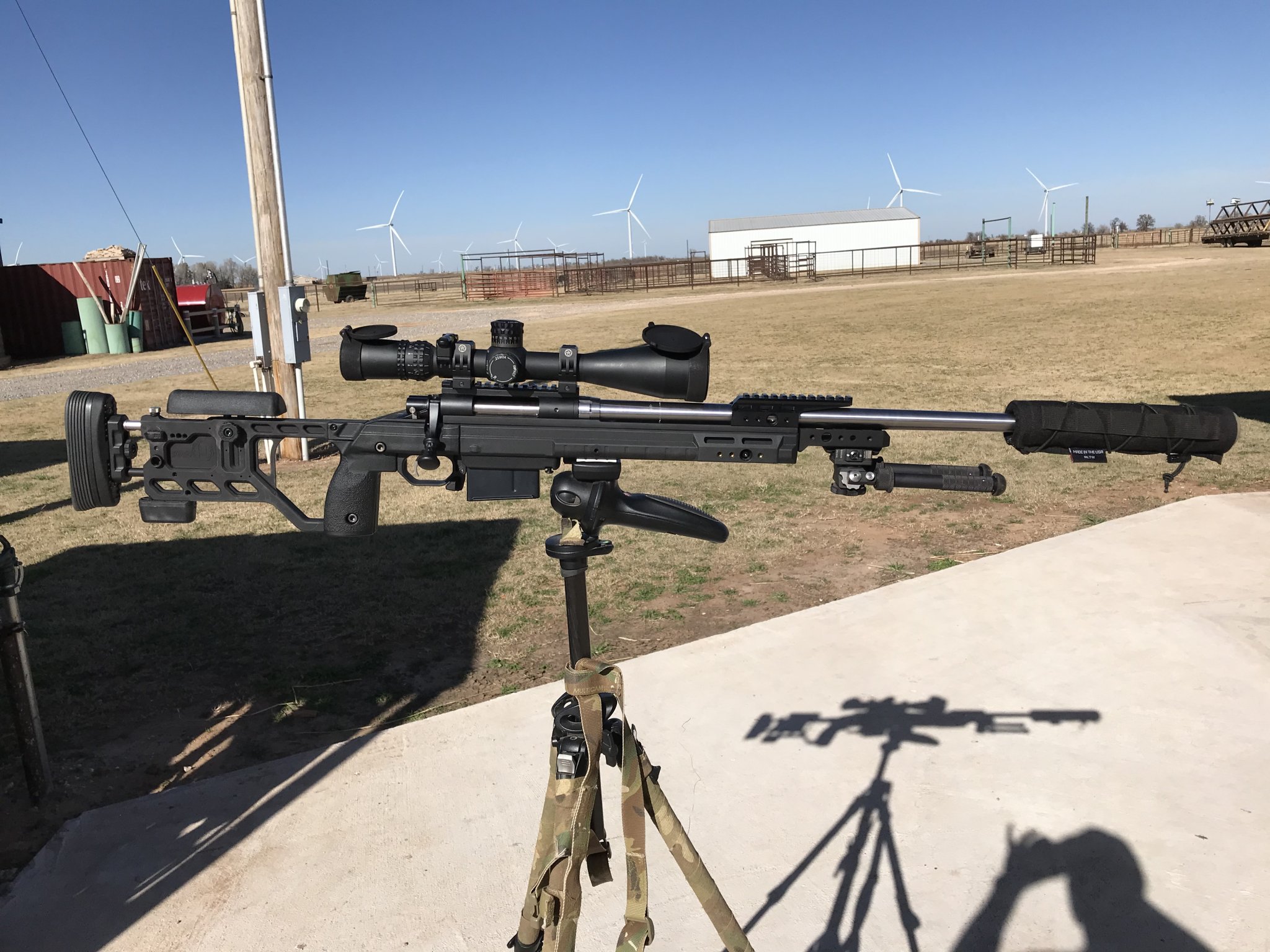

I shoot a 108 eldm at about 3050 out of my 24" proof. I have a Manners t4A with mini chassis, defiance deviant action, athlon cronus scope, ckye pod, TBAC 7" suppressor. The whole thing weighs about 12.5 lbs. It's a nicely balance rifle and not too heavy to carry around. I have actually gotten a couple cow elk with mine, did just fine. Probably not the gun you want if you have a hard to draw tag in your pocket however. If I did anything to mine for the competitions I shoot I would actually add a little more weight to it.
