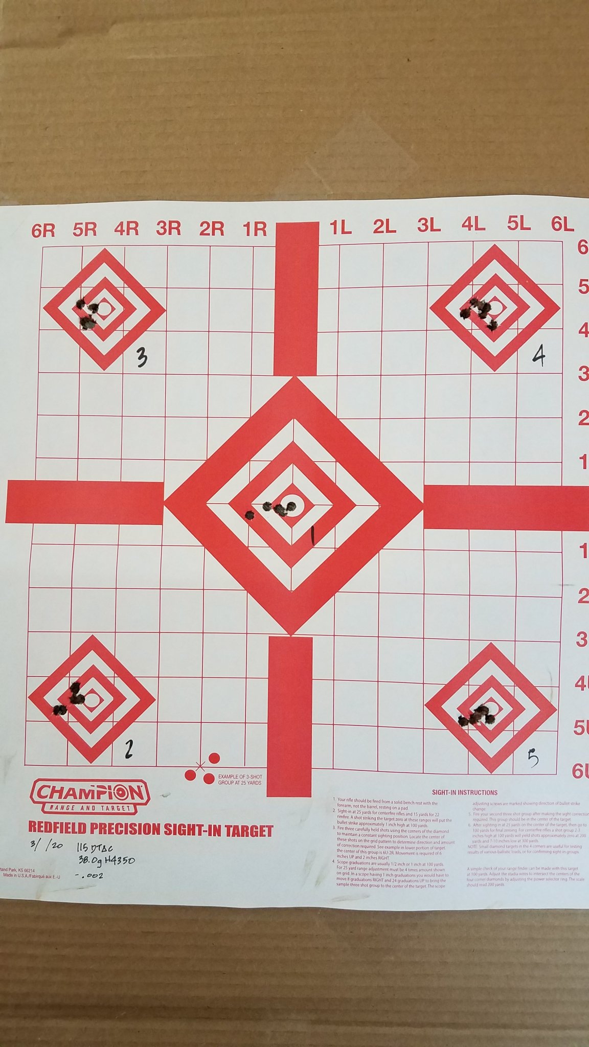

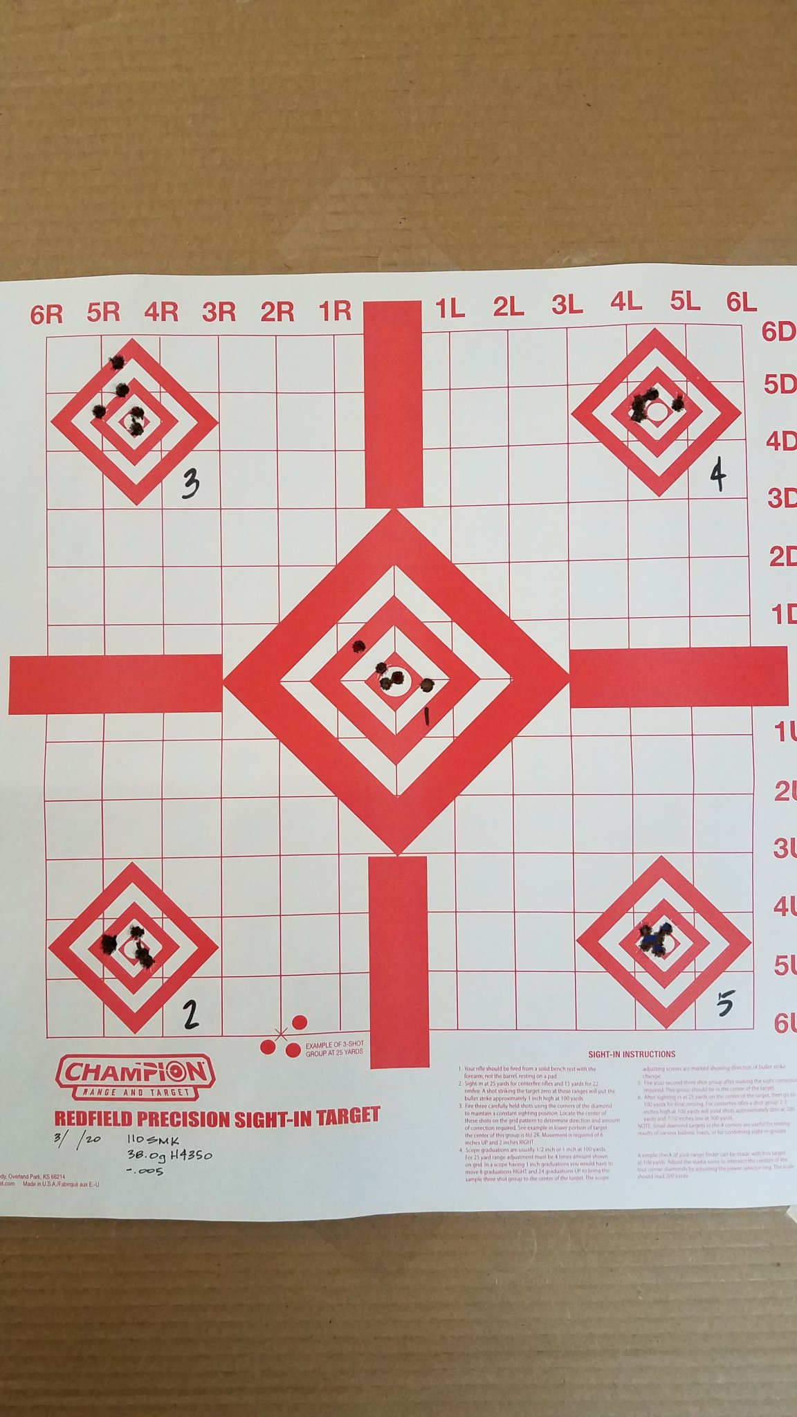

Working on some loads and seating for 110SMK's right now. RPR barrel (1:7.7)
Have also been testing 115DTAC's as well. They ran good in my last RPR barrel.
Updates to follow.
Just got back.
RPR 6 Creed
Low round factory barrel (recently installed)
38.0g H4350
Starline brass
Federal GM210M Large Rifle Match

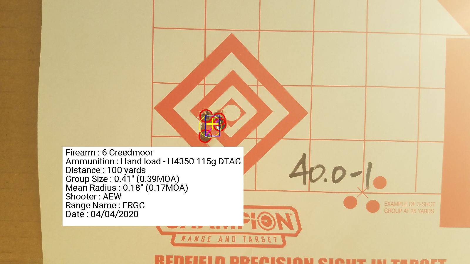

Shot both 115 DTAC's and 110 SMK's
5 sets of 5 shot groups
115's: 2812fps (avg.)
110's: 2831fps (avg.)
Increased jump from touch to about .002-.005 jump. Much improved.
