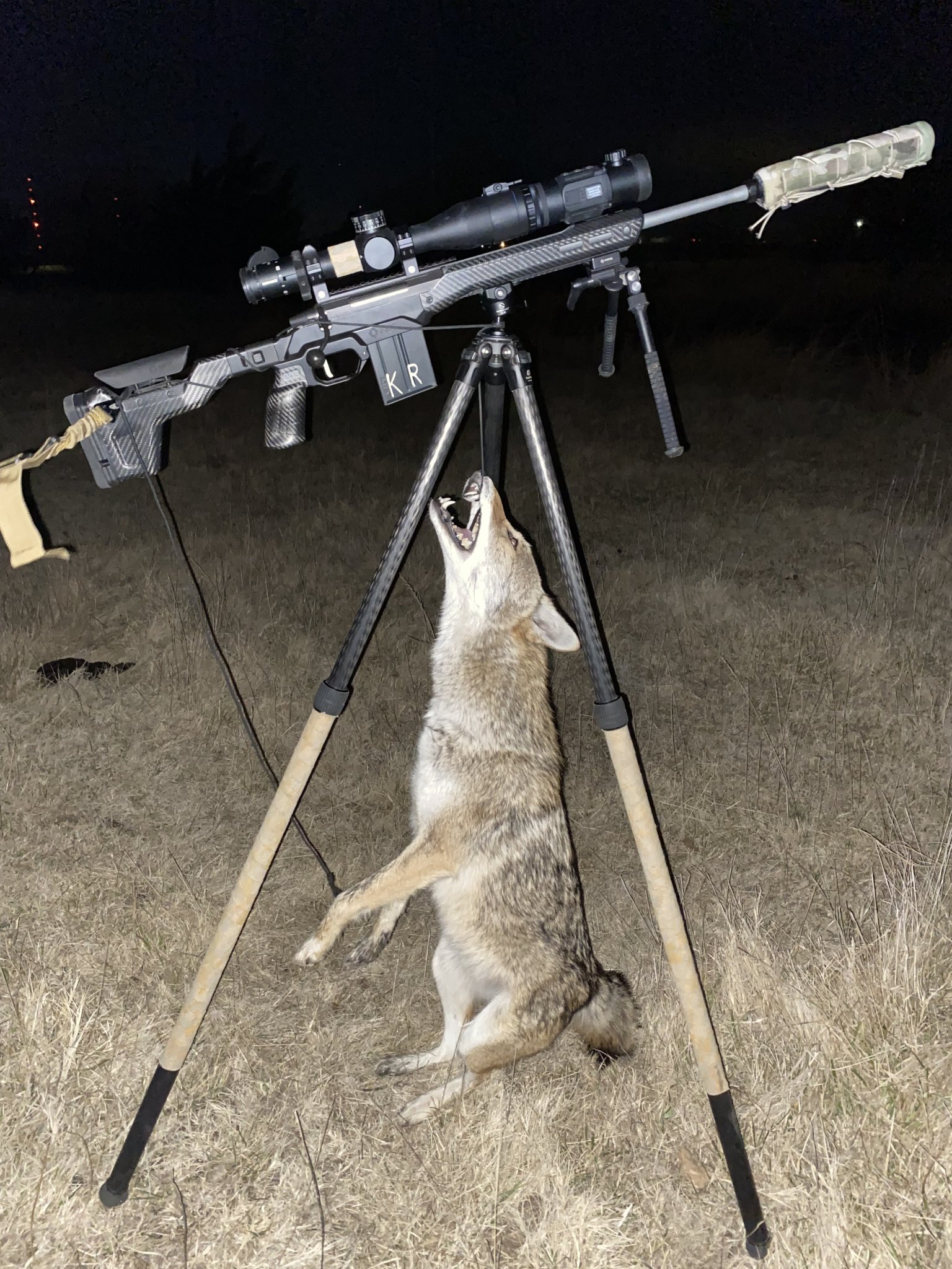

Just to add another data point my 24 inch CF Proof with Prime 107 SMK's averages 3014 fps.Had a 16.5 6creed, 105 hunting vld@2750. Worked well on some pest tag does out to 796yd. My 2 20" 6creeds are pushing 105hybrids at 2920ish.

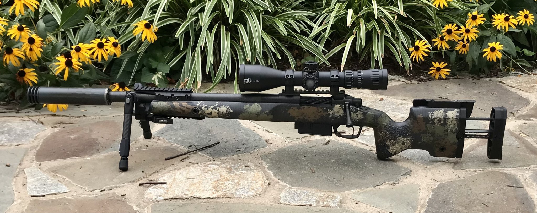

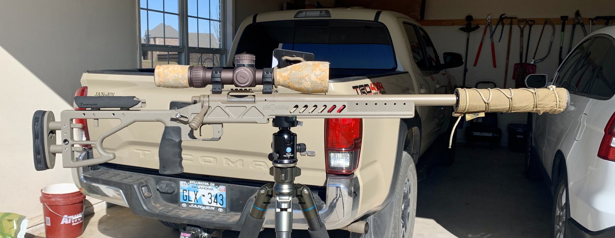

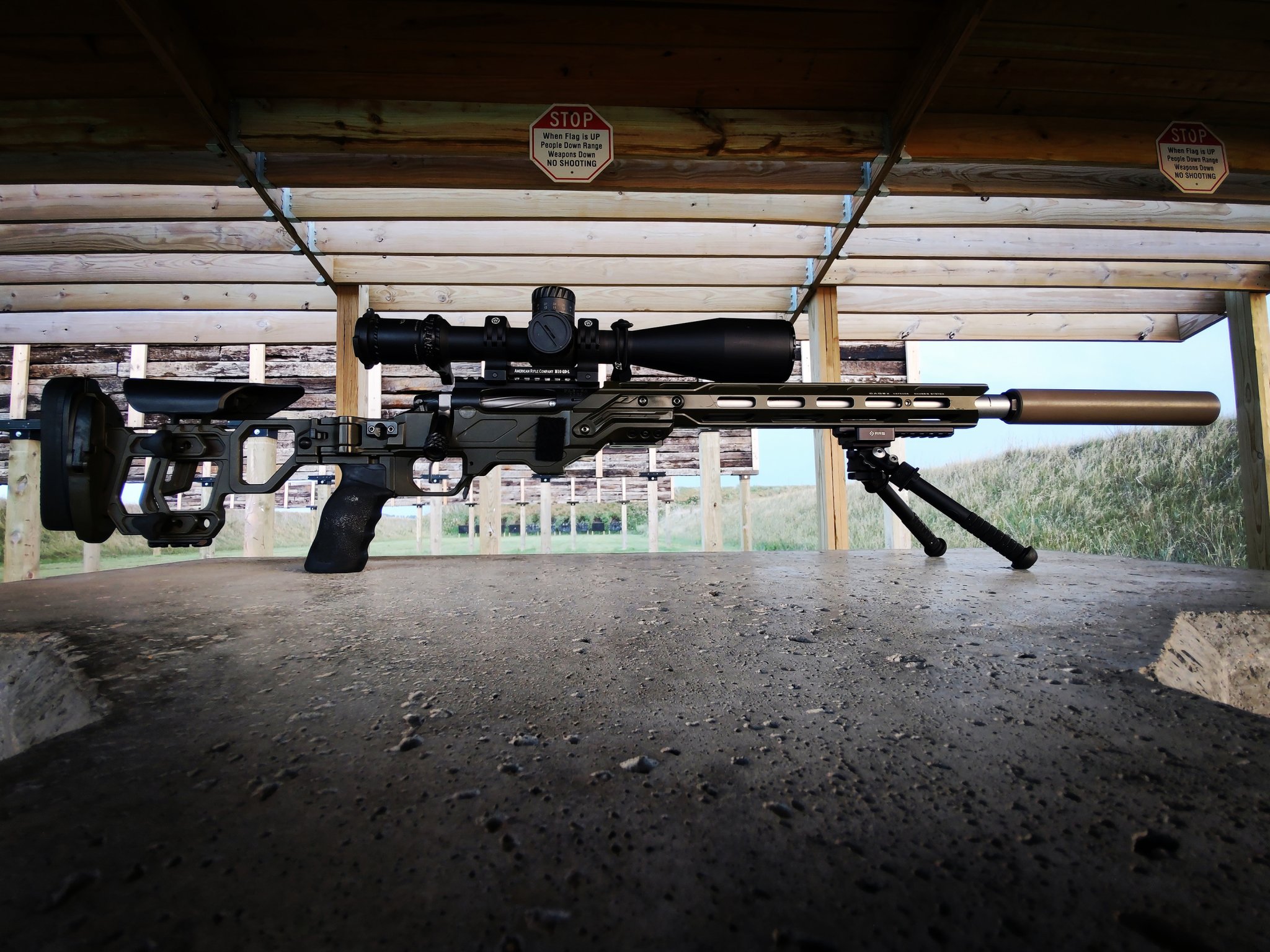

Weight?6MM CM Proof 16.5 with Silencerco Omega and Prime 107 grain SMK is running avg 2740fps with 100 rounds down the pipe.

7lbs 13 oz for the stock with Badger NV bridge, anTi action with Defiance LW pic rail, Proof CF 16.5 6cm barrel, and trigger tech Diamond.Weight?

what scope is that?6MM CM Proof 16.5 with Silencerco Omega and Prime 107 grain SMK is running avg 2740fps with 100 rounds down the pipe.

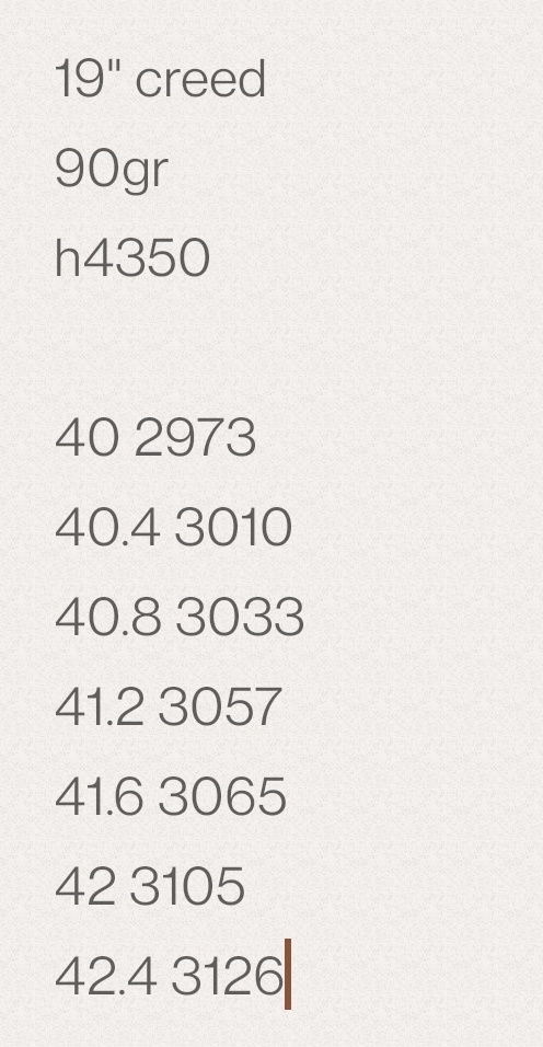

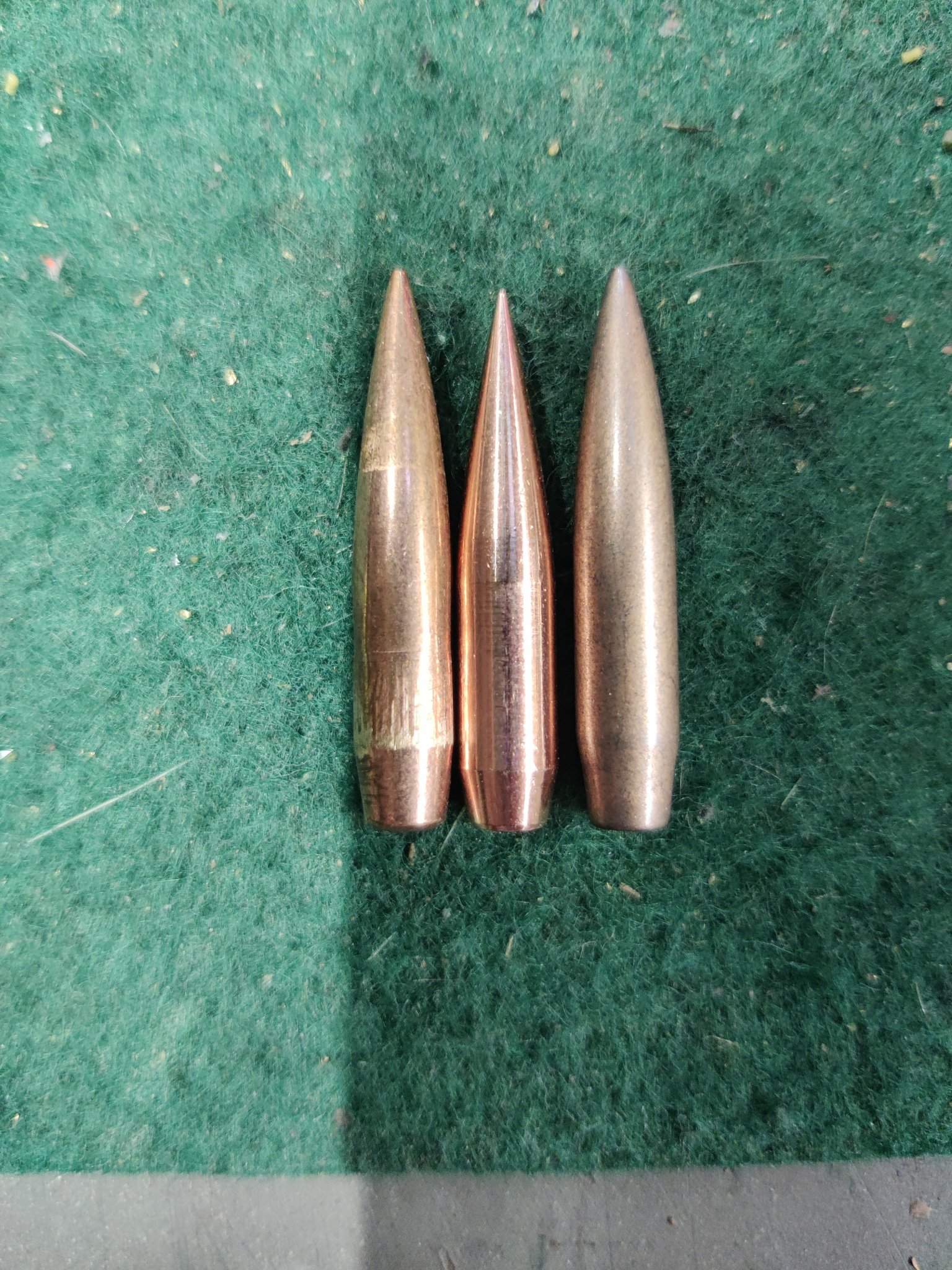

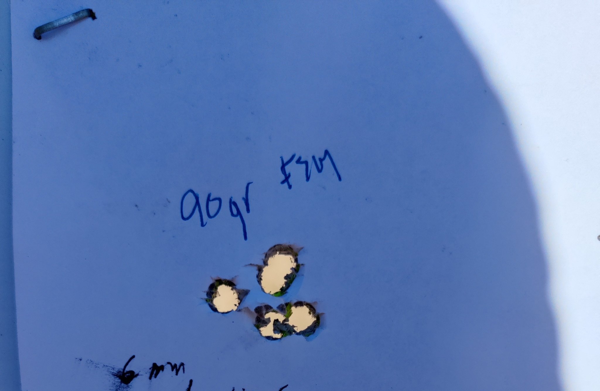

Seems like some solid performance.Got my barrel back, cut to 19". I have some new bullets from fort Scott munitions I am trying out. 90gr solid coppers. Seem to be working real well. Shot them to 1k at 6k air density.
The comparison photo is a 112gr MB, 90GR FSM, and 115gr DTAC.
Settled at 3094 once the barrel sped up a bit at 41.2gr H4350.
Yeah, I want this whole thing. Can I get some details. Im a lefty and that thing is what Im looking for.6MM CM Proof 16.5 with Silencerco Omega and Prime 107 grain SMK is running avg 2740fps with 100 rounds down the pipe.

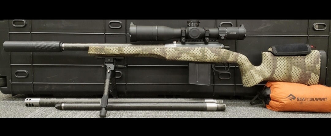

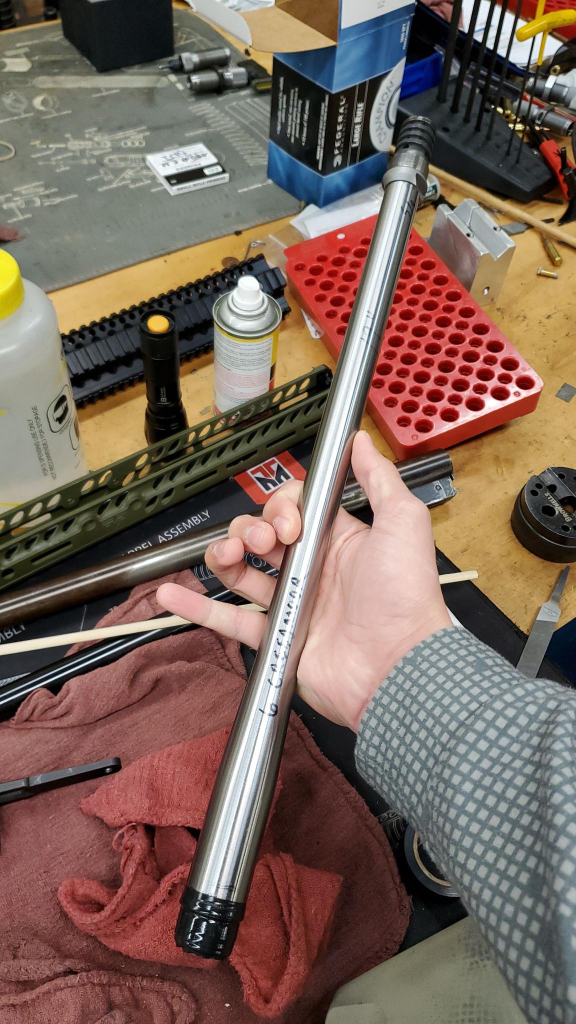

What’s the contour, and any idea on what it weighs?Just a 19" barrel cut up. I'll have data in a few weeks. Reviewing the shorty thread and other threads, 2850-2900 with 110+ gr seems quite possible. Should be a handy package
