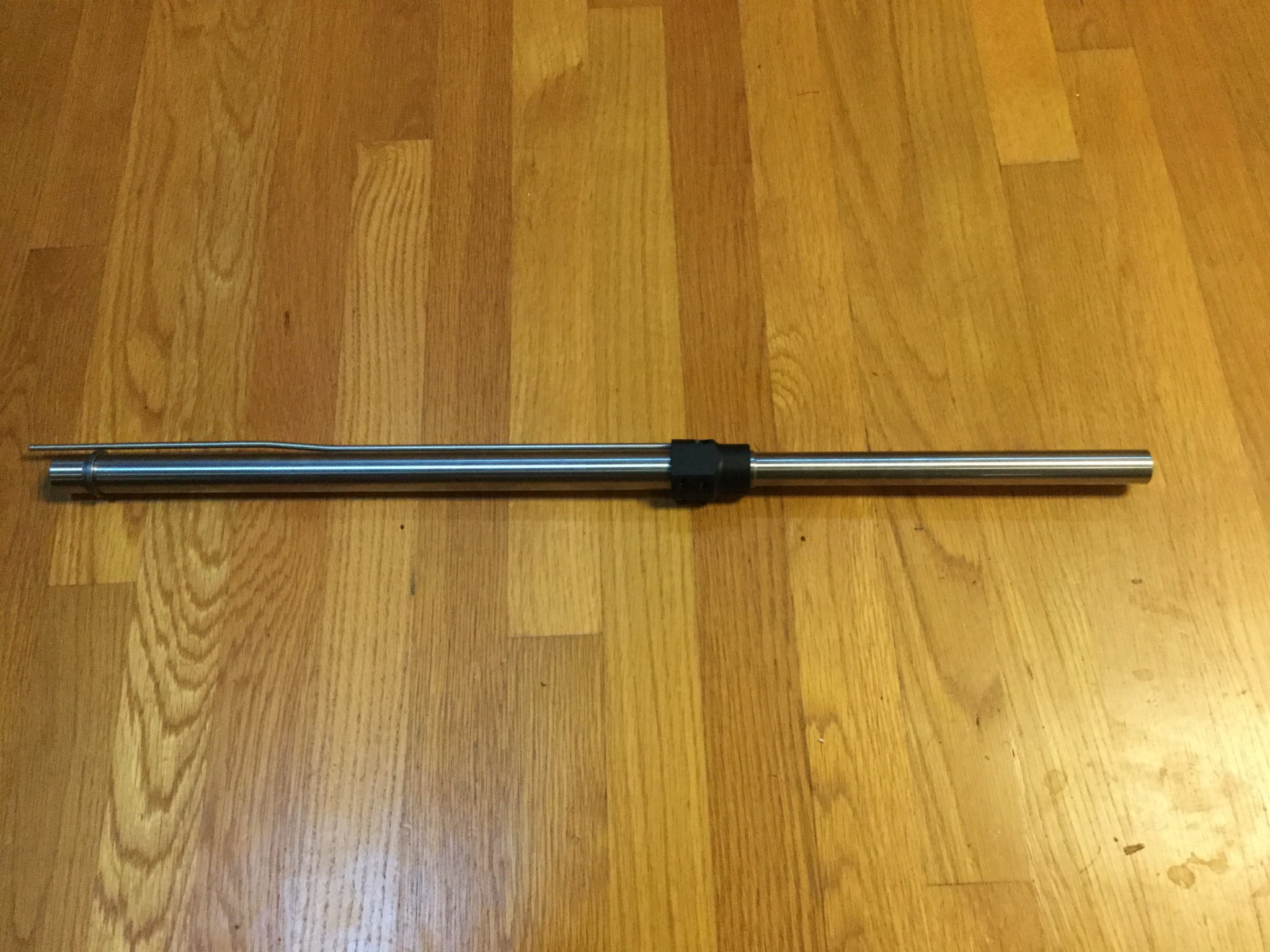

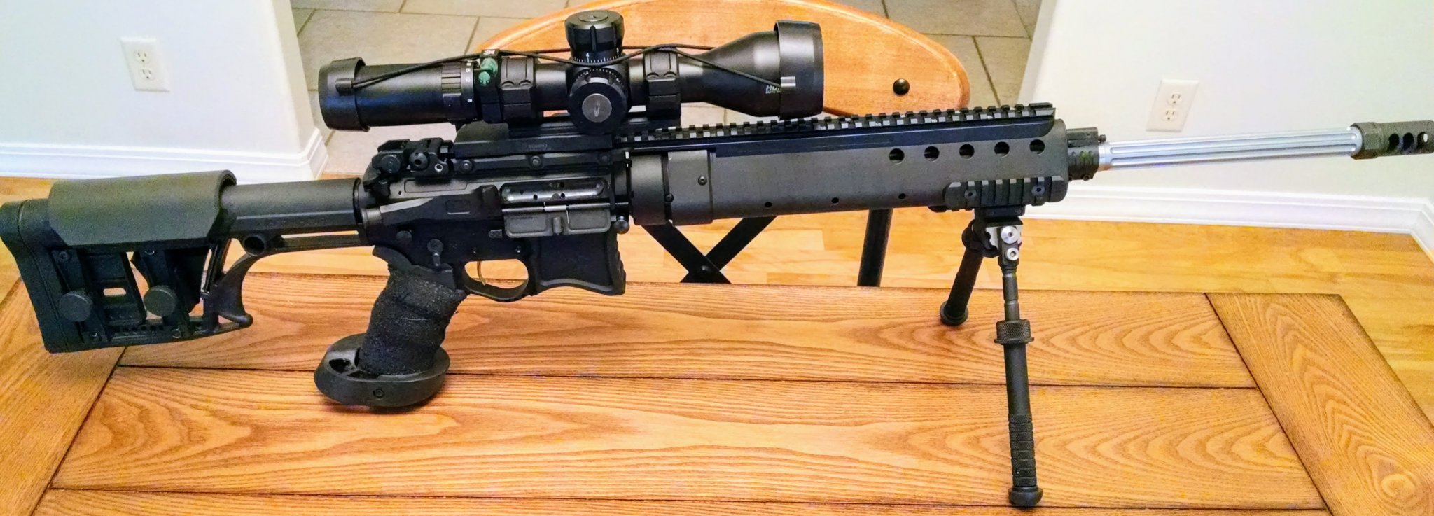

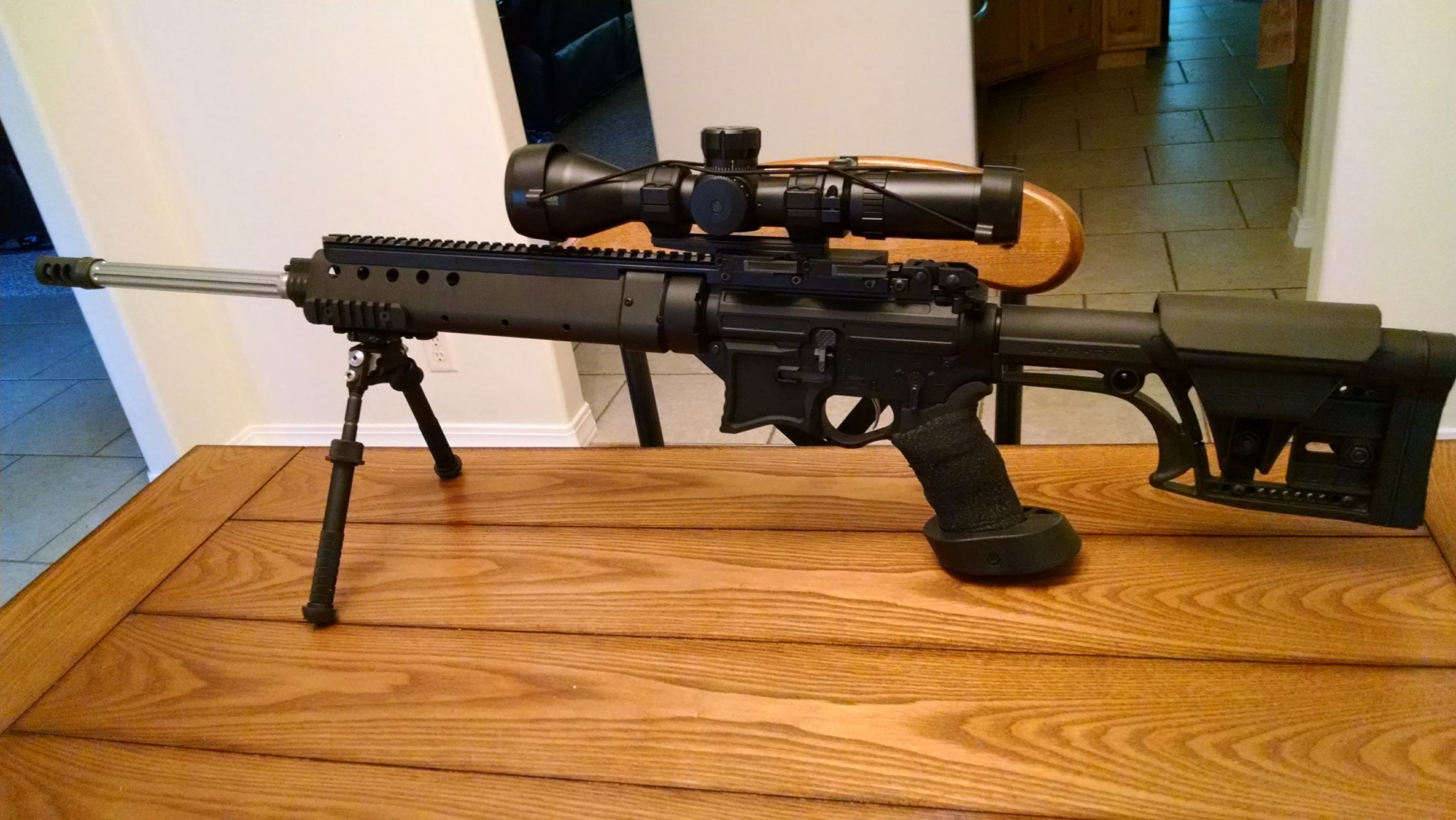

Well, here is my next project. The 22 Grendel didn’t shoot up to my expectations. It’s ok, I went out on a limb and ventured into experimental territory. I gave it a whirl, didn’t like the results, so we are trying a new gig. 6 FR from Lee Wells. 24” 8 twist Bartlein. 936 from the gas block on. I got the whole kit, dies etc. The only thing I don’t like, is I requested a threaded muzzle. I’m sure it’s just an oversight on his part. The barrel is pretty heavy, and the FR is not a big cartridge, so I don’t think I’m really worried about it not having a brake on it. My life is crazy right now, and I’ve got to pull the other rifle down for the new build, so it may be a little while, but I expect to give you guys the full story when I get her running. Have fun out there!
I emailed him about the muzzle, and he got back to me pretty quick to send it back and he would take care of it. It’s boxed up and ready to go. I’m usually ready to jump on a project hard once I have the parts, but right now it’s not hurting me one bit to have a little delay. Looking forward to this one.

This one is a 24” varmint chamber. He said it would be better since it was mag fed. It is a +2gas system. Looking forward to it. Anyone have load data that has worked out well for them? I have AR Comp, CFE 223, and Varget on hand, but I am willing to try others.
