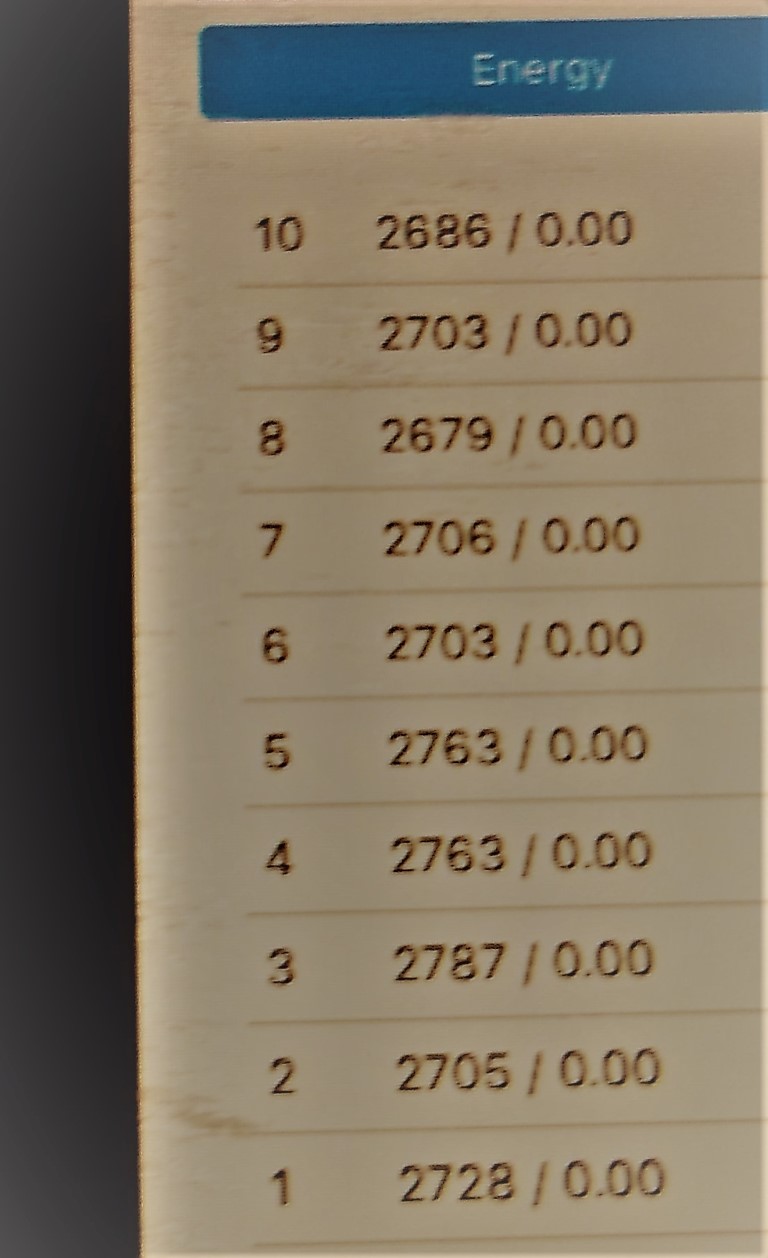

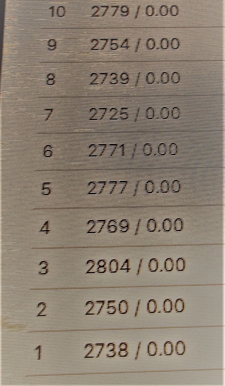

    This was shot yesterday on a new Faxon 18" 6mm ARC barrel, I know the SD is high but it is a new barrel. These were 105gn Nosler RDF's.
    This was not even a max load for the round, Hornady's test barrel was an 18" not 24" so the number reflect the 18" barrel on their site.

    I have been playing with it since the beginning of July.
    Between my son and I we have three of them. My son has a Faxon 20", shoots pretty good not may rounds shot from it.
    I myself have two 18" rifles, a Faxon which is to early to tell how it shoots only 150 rounds through it.
    And I have an Odin Works match grade which shoots 1/2 MOA or better. What I will say is if you hand load your not going to find a better cartridge in this category, it is amazing.
    What I have found is the accuracy is in the 2650 to 2700FPS range, at least for the Odin barrel. I love the Nosler 105 RDF and have done a lot of testing with them, they simply blow the Hornady bullet away.
    I reload for about .35 a round, so it is very affordable to shoot, recoil is very low, scope never leaves the target you can actually see your hits.
    I have only shot out to 600 yards to date, but can hit an 8" plate repeatedly at that range. This is one accurate round if you load, and is pretty good with factory loads.

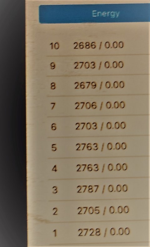

    Yesterdays data:
    18" Faxon Barrel
    29.4gn Leverevolution
    Nosler 105gn RDF
    CCI 450 magnum primer

    Question is what pressure are you running? Name doesn't add velocity, hence Ledzep's question. No doubt you are getting those velocities from your rifle, but that doesn't answer the question of what pressure are you running to get said velocity.
    I have no way to measure pressure. But if you are basing your number from Hornady's book number they are well known to be very conservative. Just look at the test barrel they used, industry standard is 24" they used an 18". You gotta ask why. I think what it come down to is finding that sweet spot where everything just works and becomes more efficient. Hence the name, it is more advanced to other rounds in it's class. I'm not trying to advocate anything, those are the numbers I am seeing and I have the proof to back it up.

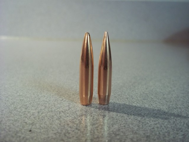

    The Hornady bullet spec is 2.200 OAL, if you load it longer than that it will jam into the lands.
    I load the Nosler at 2.215, so I am .015 longer on OAL so pressure is not a thing on my loads because they are deeper into the case. I can do this because the bullet is more slender and the ogive is a little further down the bullet. I don't load to OAL, I use a comperator and measure at the olgive. This gives me a more consistent bullet jump. Sometimes the OAL will be 2.213 sometimes it will be 2.215 it does vary a little. But the same amount of bullet will always be in the case, so pressure from one bullet to the next is consistent. My seating die also contacts the bullet at the same location that the comperator does to seat the bullet. Consistency is the key to accuracy. I just do things a little differently than most folks, but I have been doing it this way for almost 40 years.
