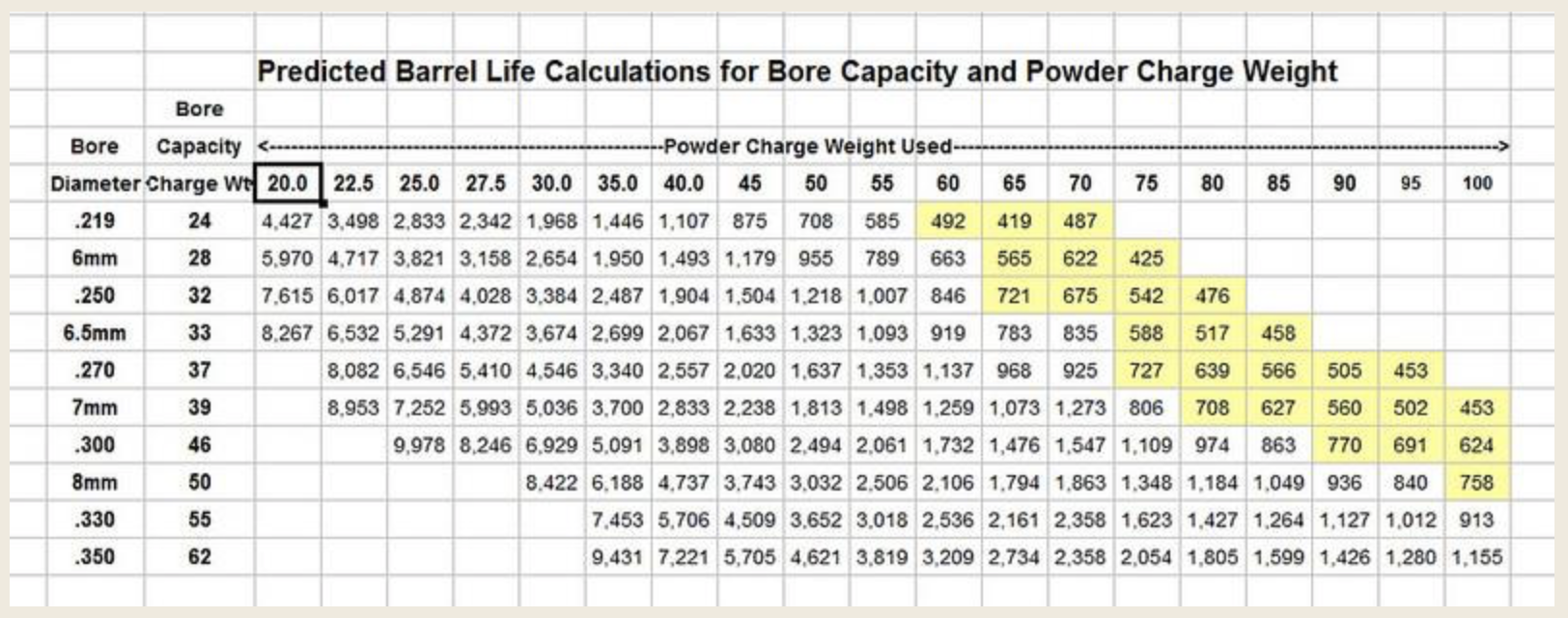

I got into the GT expecting Dasher barrel life, and cheaper Hornady brass.
I fully expect to be replacing barrels at 1900-2300 rounds.

That is effectively the same barrel life as 6CM loaded with slow powder running 105s at 2900fps out of a 26" barrel. I have all of the gear for 6GT, just need a barrel, and the cartridge pretty much makes no sense. Especially with Varget being so hard to get right now.
Plenty of other powders than varget work. H4350 will get you the same speed at lower pressure. If you go off his chart a 6BR sounds pretty good, ha ha.
