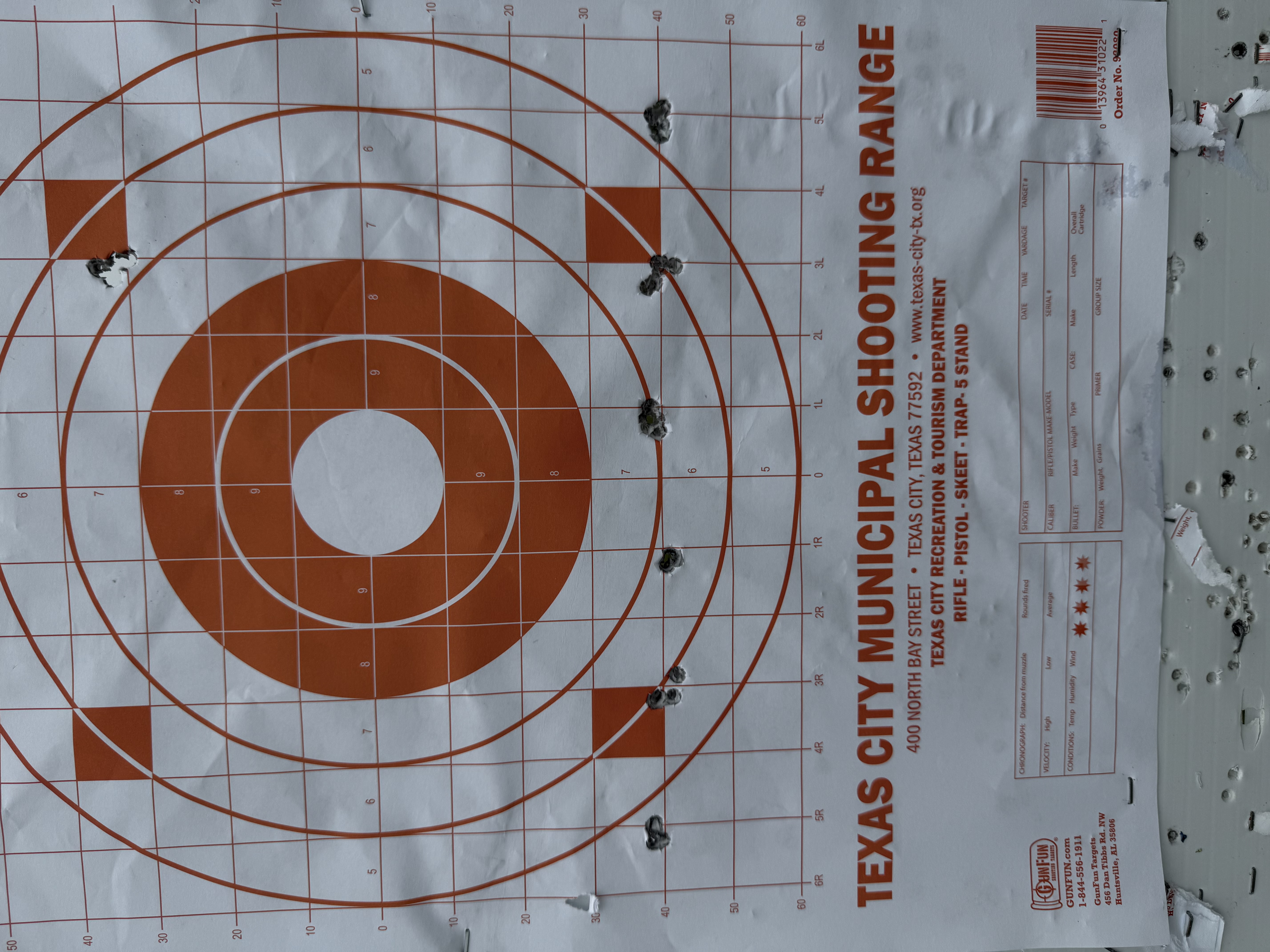

Running 2903 fps with Berger 105 Hybrids, still the rifle I depend on at matches. 2448 rounds down the tube. Just this morning, it was stacking bullets on top of each other in what really amounted to a semi-hurricane.
I have a barrel ready and waiting to replace this barrel with, but guess I’m stubborn. Give me a reason to change and it’s changed. Till then, I’m sticking with what I got.
