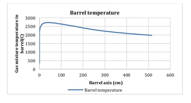

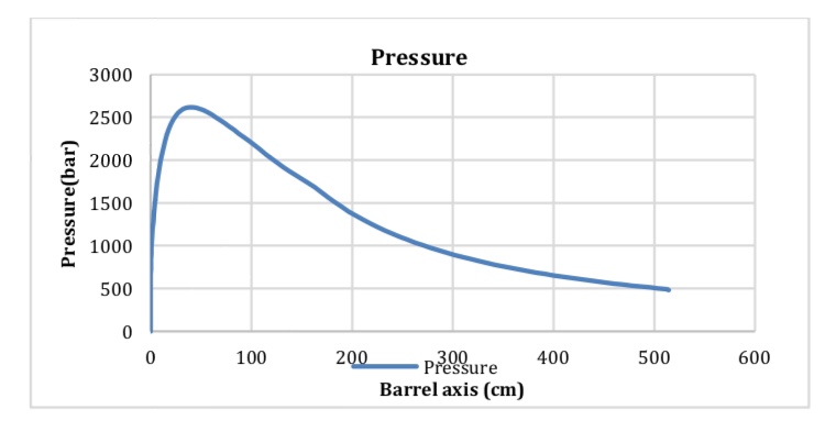

You speak with an air of authority and certainty. Setting aside whether this is simply a personality trait let’s entertain the discussion.
Burn 35 grains of loose powder with a match, sitting on the ground. It creates (for the sake of argument) 10 cubic feet of gas. Now set aside whether creating that gas in a confined space is a compressive force, you still have the counterpoint of gas expansion being a cooling force. If there is no compression, are you only left with expansion cooling, where greater total volume/pressure produces greater cooling on expansion? To me that flies in the face of logic.
The much more plain answer is that the gas created on burning is a fixed volume, and to create it in a confined space is to convert that energy into work aka compressive force. The byproduct of that compressive force is both the energy that moves the bullet and unavoidably the heat generated by compression of gasses.
If you observe powder burning in an open environment you can see that it doesn’t burn all that fast, not nearly as fast as a bullet fires. The pressure (and heat) of the confined chamber accelerates the chemical reaction of powder burning so that it happens much faster.
There are a couple observable real world phenomena that tend to support this. One is the “spike” in the rate of the pressure curve you see in some powders as you reach max pressure. The addition of a bit more pressure and heat accelerates the whole power cumbustion so that adding a small amount of powder when near max creates much more result than adding the same amount of powder does at lower pressure. If pressure was not connected to combustion temperature then you should not see this acceleration of chemical reaction (powder burning).
The second observation is how barrel life responds to reducing loads (reduced pressure). While this is a broad observation, if you back off a couple grains from max charge (say 7%) the general report is one of a greater percentage increase than the powder change alone. This is suggestive of a nonlinear process at work.
I have a hard time reconciling that pressure and heat are not interrelated.

https://apps.dtic.mil/dtic/tr/fulltext/u2/a440938.pdf
But to say that pressure doesn’t influence those temps and you know that for a fact because you’re an engineer by trade and he doesn’t does seem disingenuous.
At least I'm an engineer and have over a quarter century in the profession. How about you?
You're no engineer if you think pressure and temperature aren't correlated, considering the ideal gas law is really basic stuff taught even to high school students. You wanted data, how about having a fundamental law of nature instead?
PV = nRT
Pressure * Volume = moles of gas * universal gas constant * absolute temperature
When the pressure spikes higher, the temperatures will necessarily also spike higher than the same powder at a lower pressure. How much of an effect this increase has on barrel wear vs the increase from a hotter flame temp is less well studied, however.
