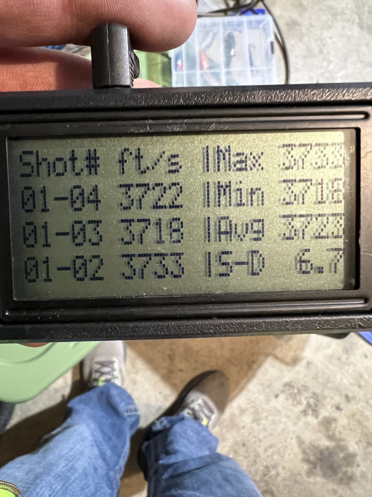

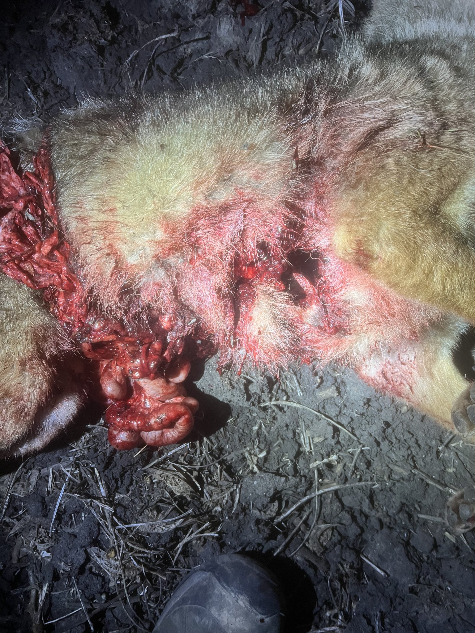

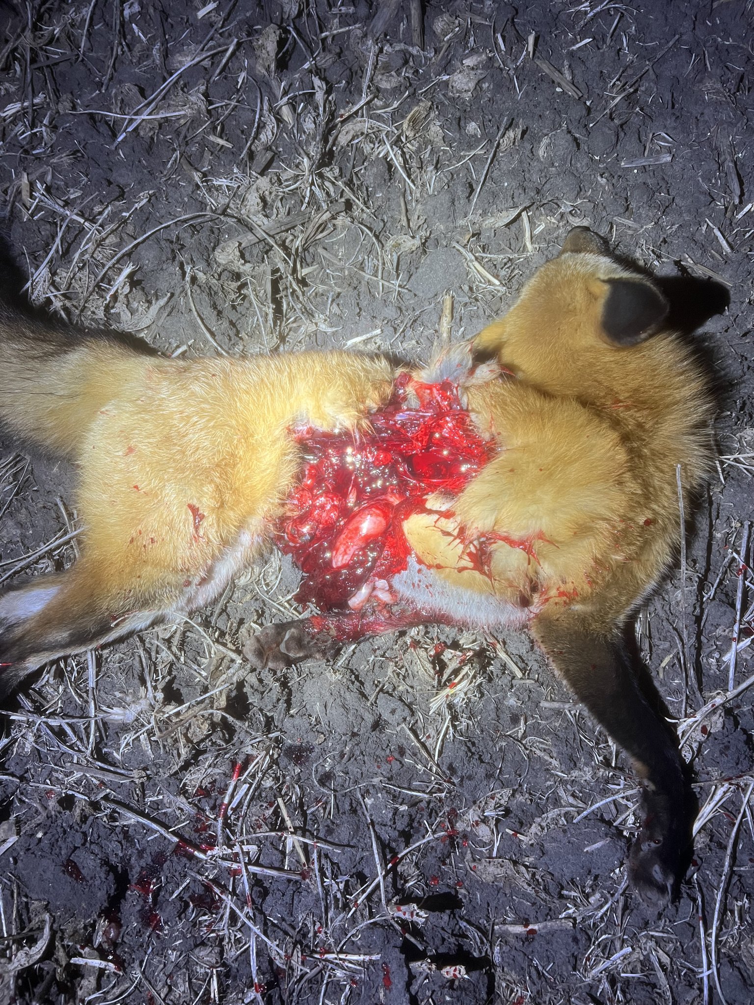

I have been using a 103 ELDx at around 3723fps with pretty destructive results. Fox was at 375 yards and coyote was around 250. Mine is a 6 PRC Ackley improved and I’m using Staball 6.5.

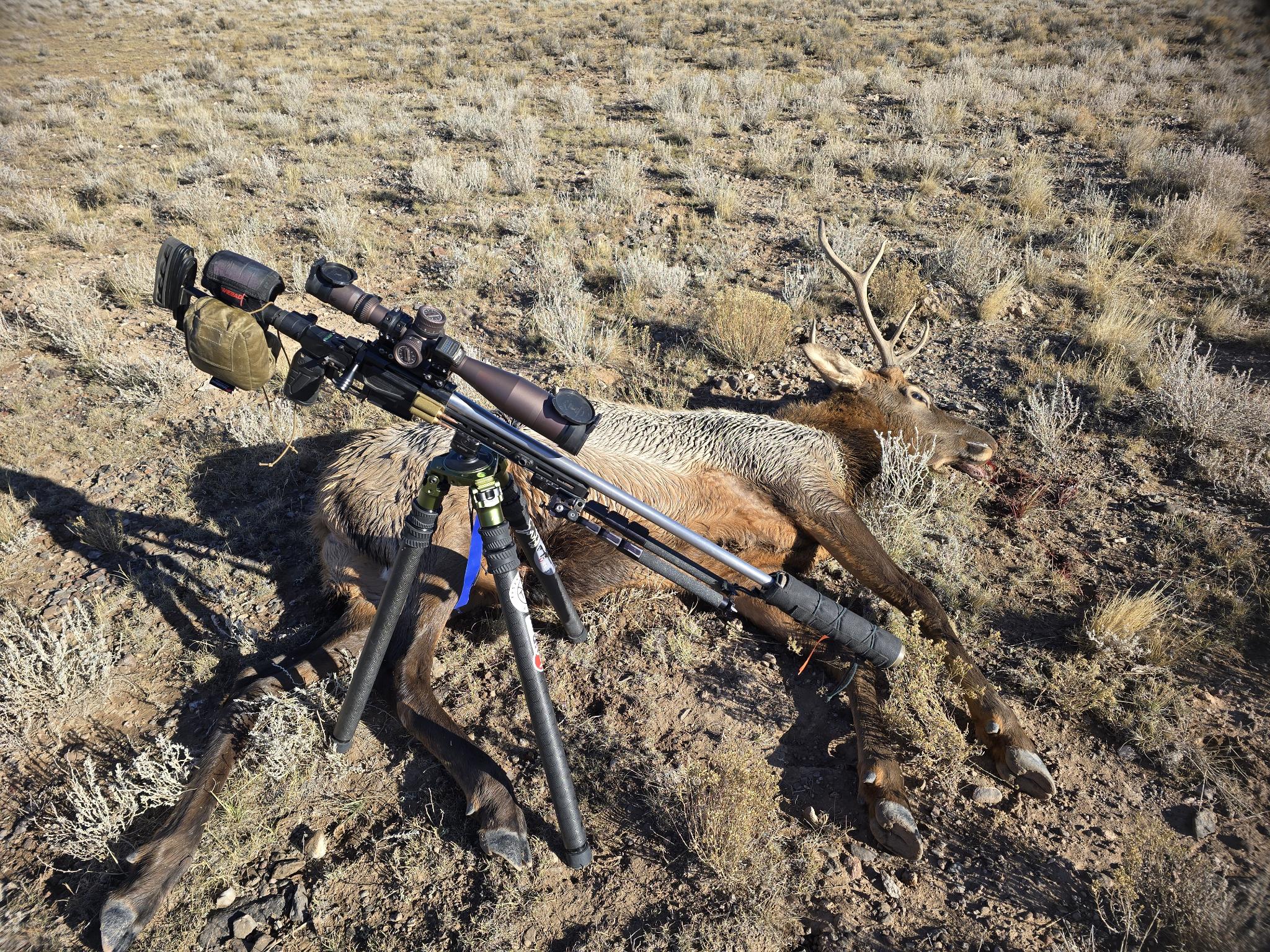

20in 7.5tw, 58gr H1000 in adg brass, 112 Barnes at 3150fps, shoots half minute. Running it bout a grain below flat primers which is 3200fps.

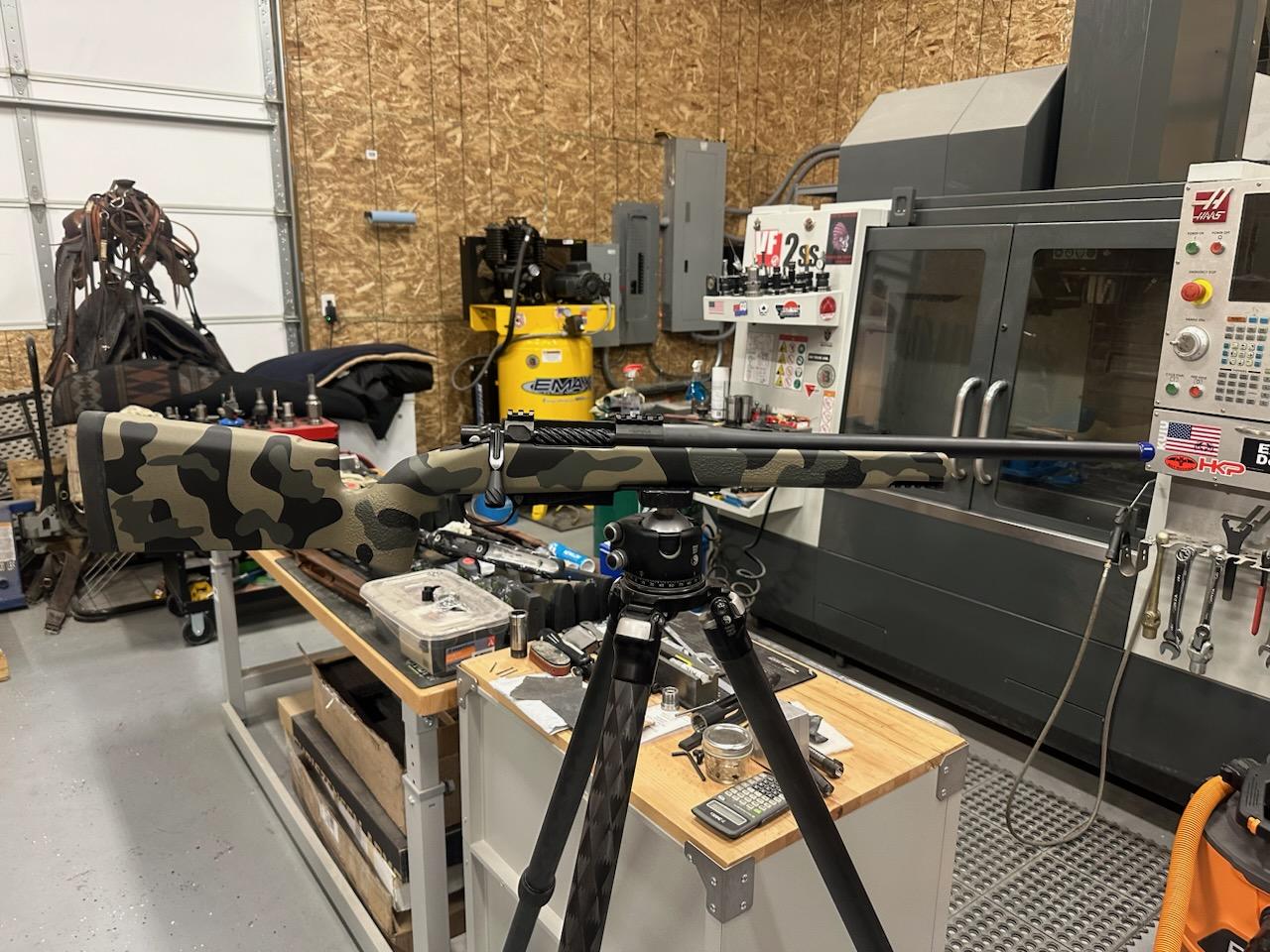

Build: bat vesper, McMillan mountain tracker LR, UM DBM, ace 20" 7.5tw light palma. Running a Triji 3-18x44 tenmile, DD Wolfhunter 6mm can, and gunwerks bipod, whole setup is 10.5#, great hunting weight.

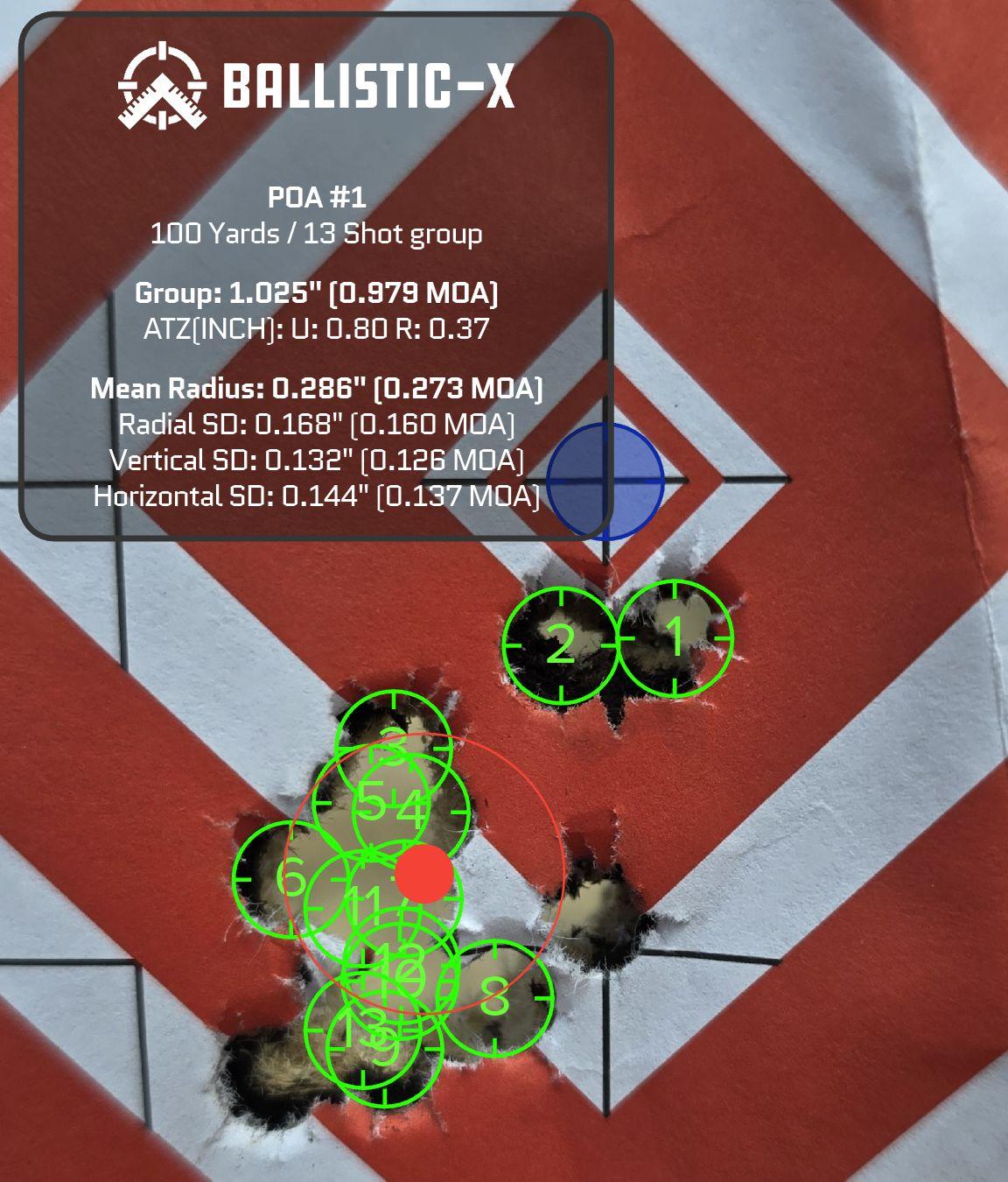

Guess I'll give an update since it's been a while. It still hammers but it felt like I was getting too many flyers with the Atips resulting in overall bigger group sizes. Not sure if that's the barrel burning out or the bullets not being able to hold up to the RPMs, so I figured I'd try some Berger LRHT 109s that I was able to find and I've wanted to try them over the Atips for a while. I like the Berger consistency and thick jacket of the target line to keep the bullets together at speed (though to be fair I haven't had any issue with the Atips in that regard). I tried the same powder of n565 and got pretty much the same results as the Atips, maybe ever so slightly better groups.
n565 with Berger 109s (wish 2 shots I pulled removed)

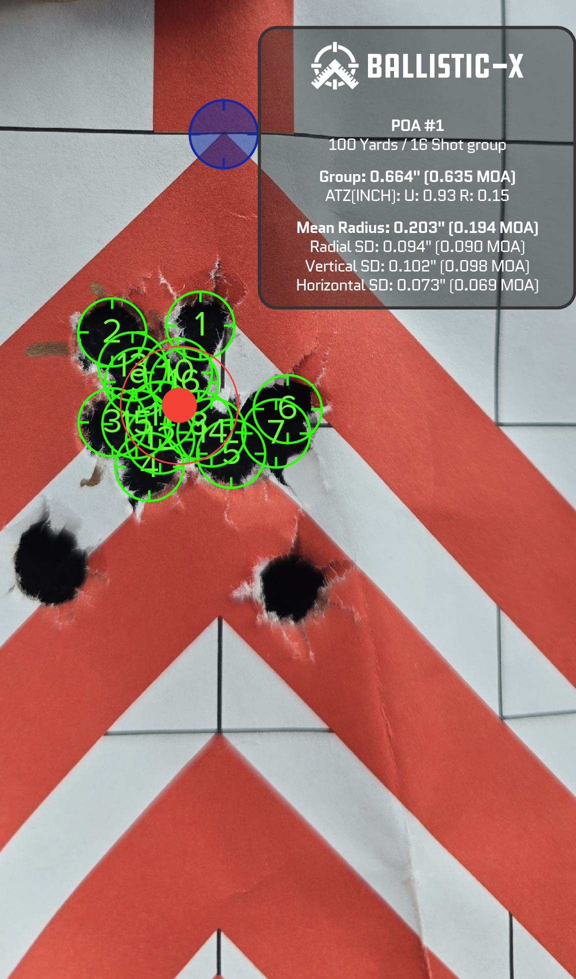

Then I figured I'd try some h1000 that a buddy had laying around and that shrunk the groups by a decent amount and it also meters really well. I also like the temperature stability of the Hodgon's because I'd easily get 75fps swings from summer to winter with n565. I prefer a load that I can keep the same all throughout the year.

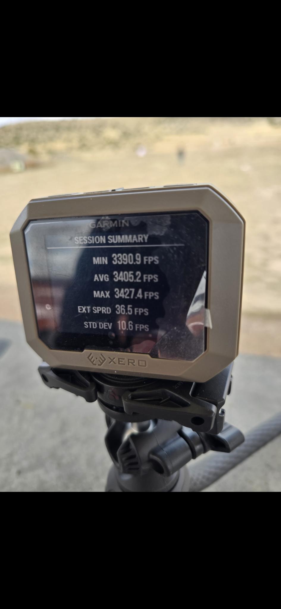

I ended up with 58.5grs of h1000 that sent the 109s at 3405 fps from my 26" barrel. Not bad at all. I also proofed the bullet at this speed at distance and made it to 800 yards without any jacket separations, that's with my 7.5 twist 5R Bartlein, for another data point.
h1000 with Berger 109s (with 2 shots I pulled removed)
Chrono data is with 20 shots
