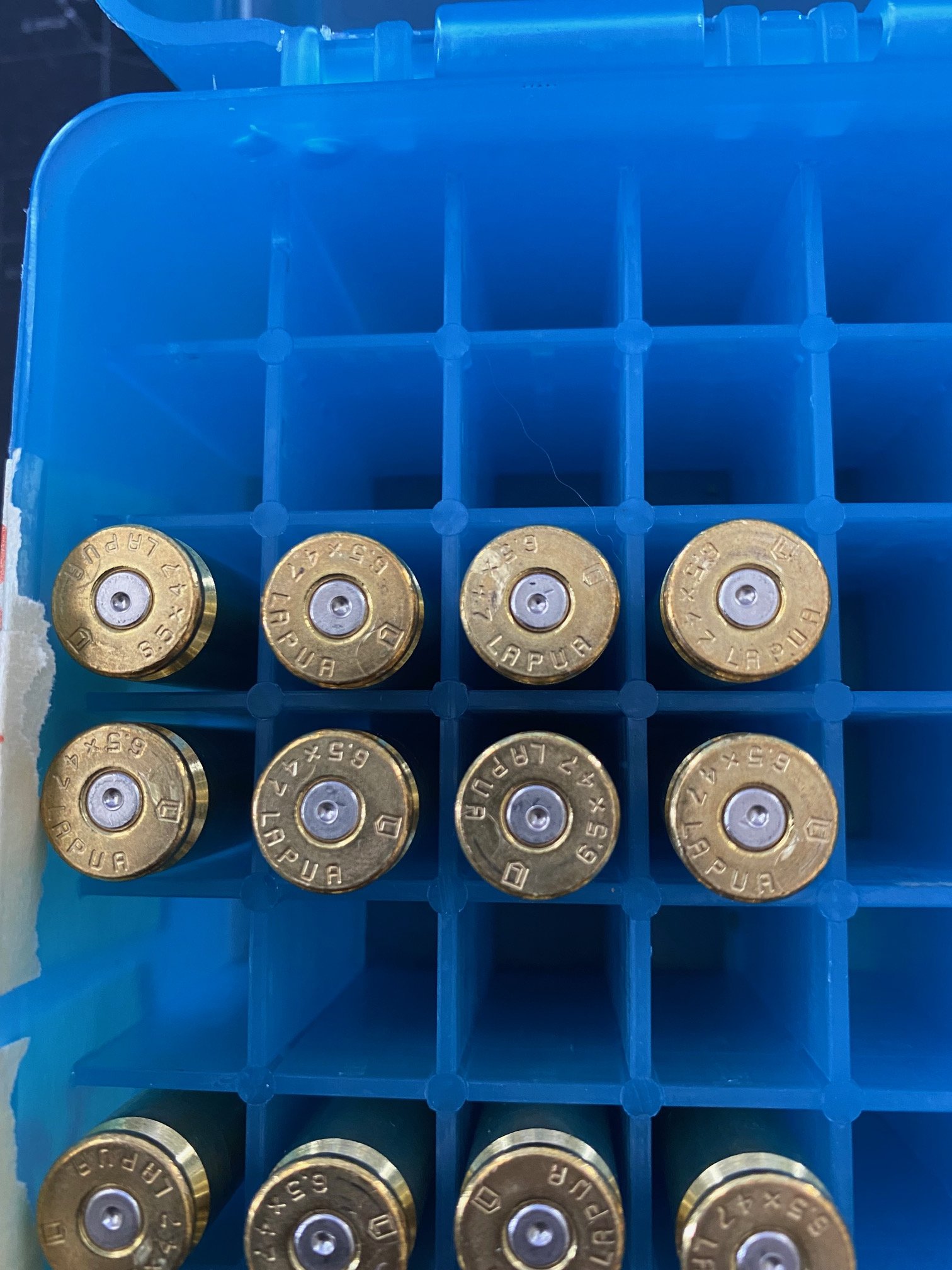

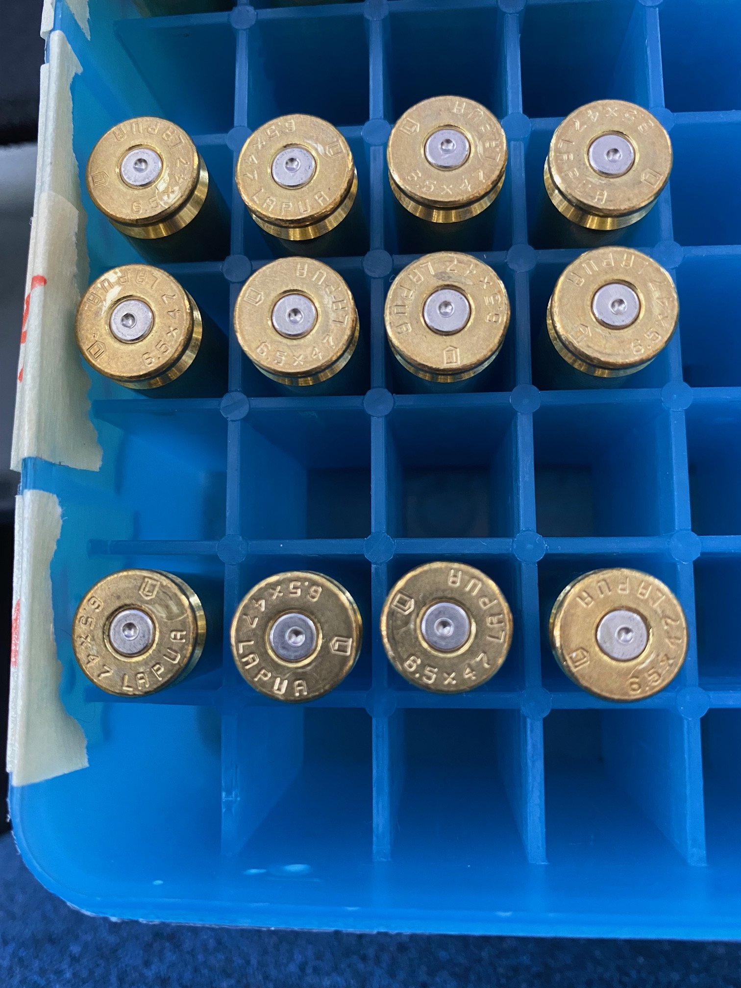

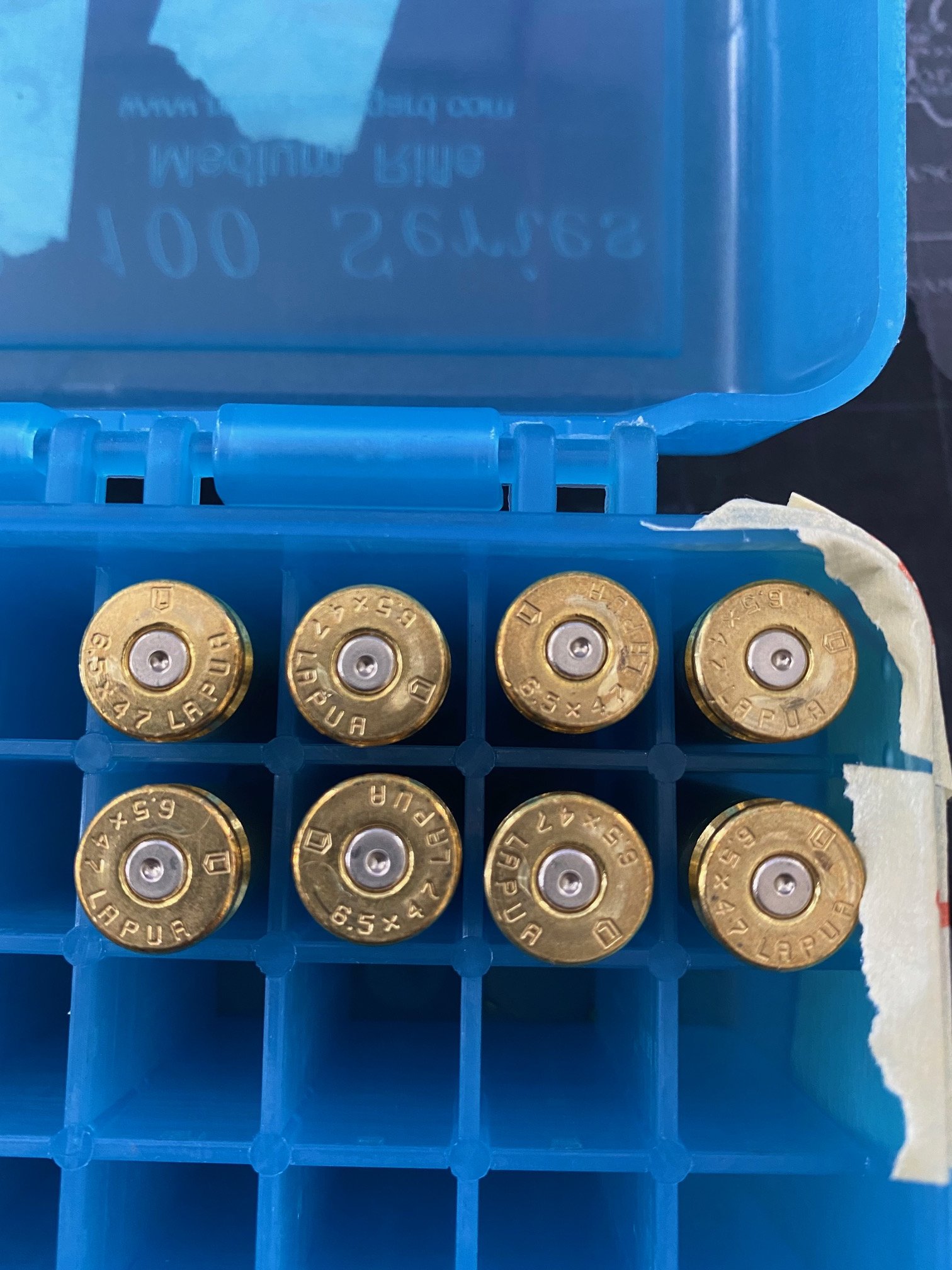

I'm new to 6x47 Lapua and 6mm in general. I'm running a Terminus Zeus action with a 26in Proof steel barrel. My concern is around the brass after being fired for the first time, and if I'm getting high pressure signs or simply not doing something properly.
All of these loads are with brand new Lapua 6.5x47 brass necked down to 6x47 using a Forster full length sizing die. I am using 105gr Berger Hybrid Target bullets, starting with 37gr of H4350 and ran .5gr increments laddered up to 40gr. I am seeing the ejector marks and scuffing on the brass. The primers are showing some flattening and puckering around the firing pin, but the velocity and charge weights seem reasonable. These are all using CCI Small Rifle primers. Am I on the right track with this load development? Should the brand new brass be showing ejector marks and scuffing, or the level of primer flattening/cratering around the firing pin?
Here are some photos of the brass - 105gr Berger Hybrid Target - H4350 - Top Row 37gr @2836fps, bottom row 37.5gr @2886fps:View attachment 7668282
105gr Berger Hybrid Target - H4350 - Top Row 38gr @2931fps, bottom row 38.5gr @2989fps:
105gr Berger Hybrid Target - H4350 - Top Row 39gr @3030fps, middle row 39.5gr @3071fps, bottom 40gr @3113fps
I run a Terminus Zeus also in 6 creed and it marks up brass in the same fashion with mild loads. It’s just the edges on the ejector hole are sharp. You could buff them down a lil. I know 3 others that did same thing. Those primers aren’t even flat anyway. You’re load is fine
