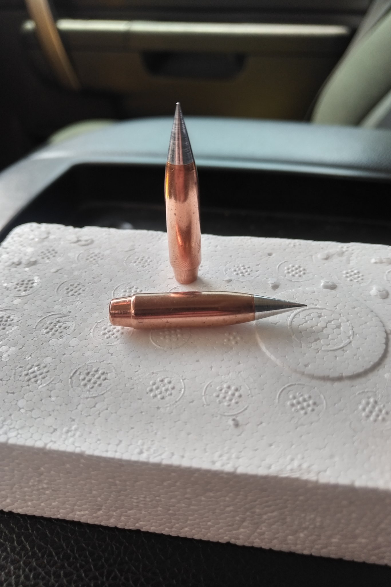

You need these fancy 7mm's
ALCO's 168gr aluminum tip. .800 G1 BC, same as the 180 ELDM

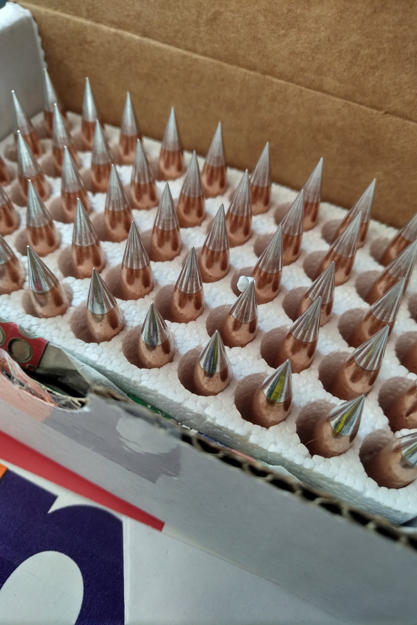

Hi,
Now ONLY if those advertised BCs matched peoples field results you would never ever hear of another bullet manufacturer except Alco.....
AB got a 26% reduction in BC from the bullet they tested. Pretty much everyone I know of has gotten anywhere from a 22%-30% reduction in BC advertised on various Alco bullets.
