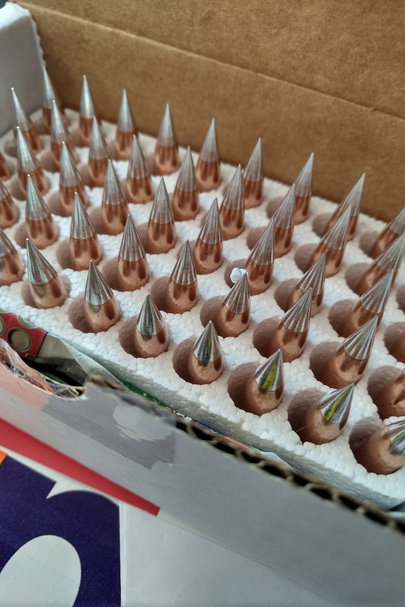

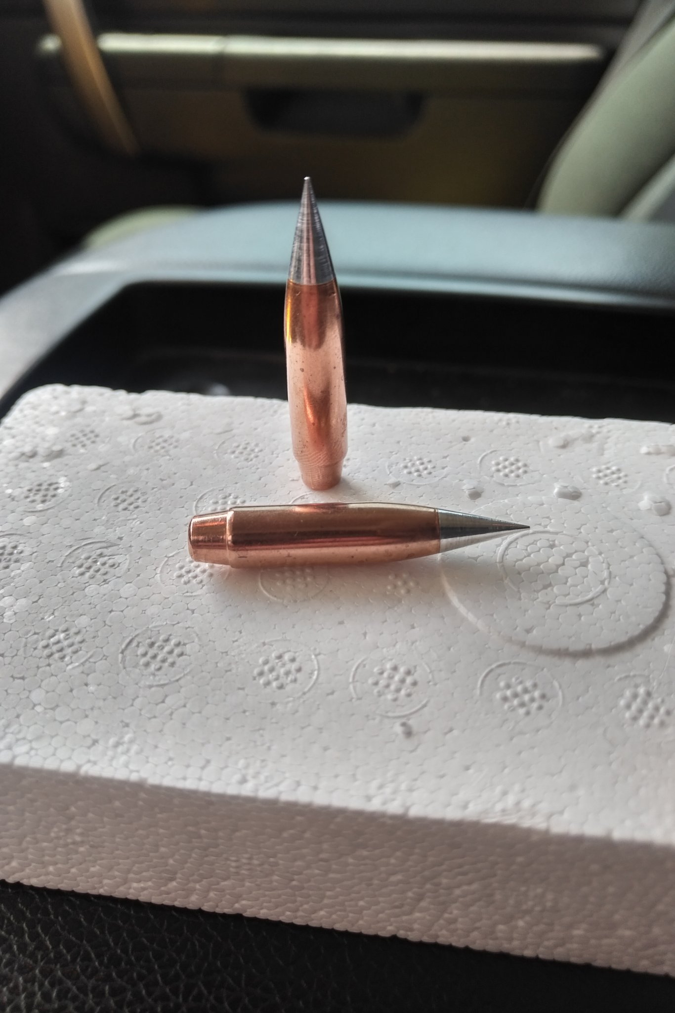

Once you shoot those alcos you will see that the bc stated is not even a dream. I have a bunch of lost river pills with overstated bc's They are not as exaggerated as the alcos but still ,050 to ,075 higher than what the drops indicated
I recently shot the Cayugas, going into it with the same mind set and was blown away. would love to see them in a hot rod caliber
I believe that I shot some warner tool stuff and it lives up to the hype. The over inflated bc's of the early 2000's and before have been weeded out for the most part. Every year someone posts up those friggin alcos with their bs numbers and the soft heads don't even look at the form factor and restate the bs number. If they shot them at 308-300 winny velocites .5-.520 in a 10tw. I have lost rivers which are as close as can be in form factor and dimensions and they state .560-.575(I'd have to look on the 165/8s} and I've never had them shoot as well in the wind as the 175smk. I still have a bunch of them in multiple calibers. 270 30, 338 and 375 or 416(again not sure)
