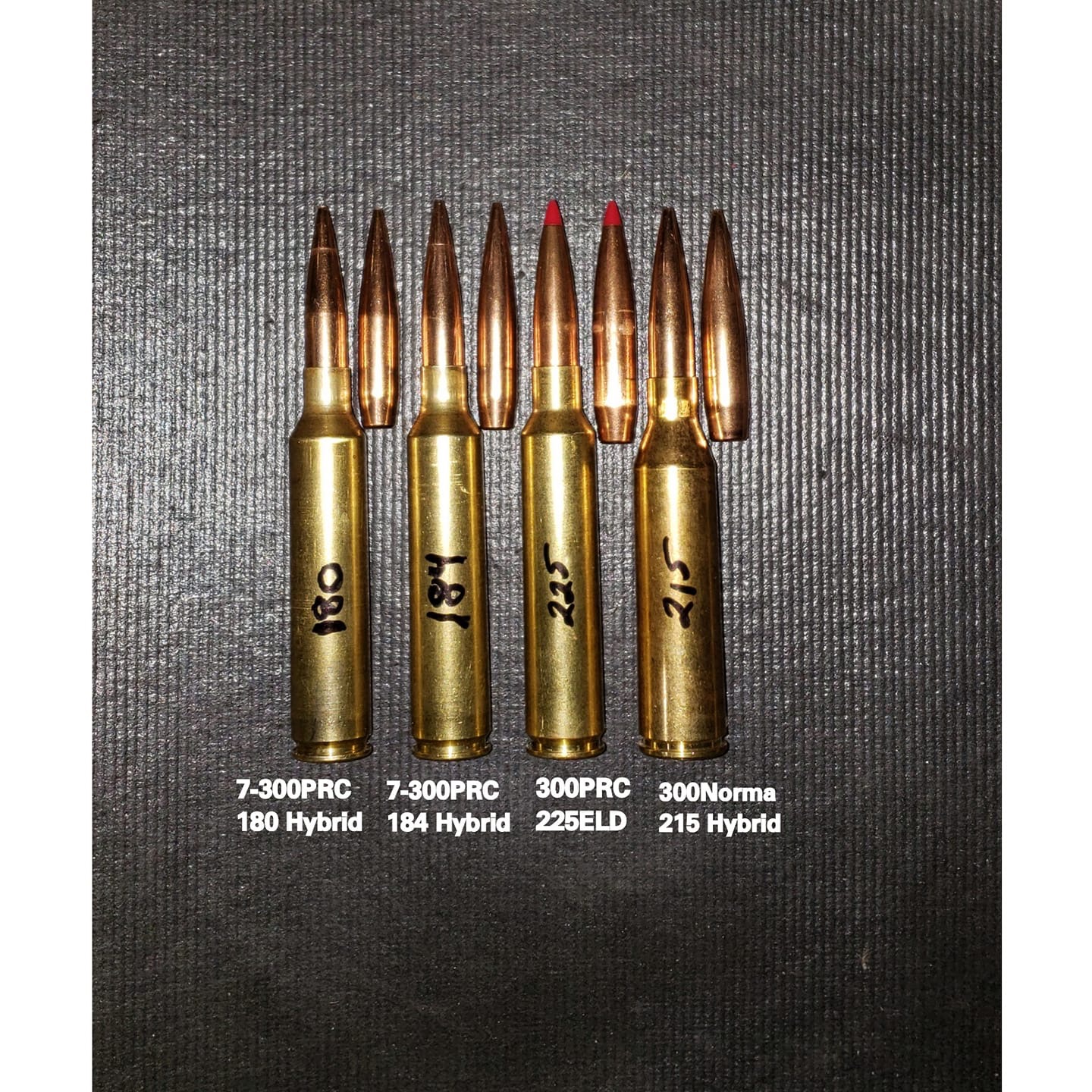

Why not go with 7-300PRC?
Note not my photo, took it from a friends FB post.
Reactions: BearNaked
Want a short action. I have a 28 Nosler in a long action.
Makes sense. I'd say then try the 7-6.5 PRC. Shouldn't be hard to find a smith with a 6.5 PRC reamer and a a 7mm neck/throttling reamer to try the caliber without having to pay to get a custom reamer. Finding 6.5 PRC hornady brass should be way easier than the saum or SS brass.
