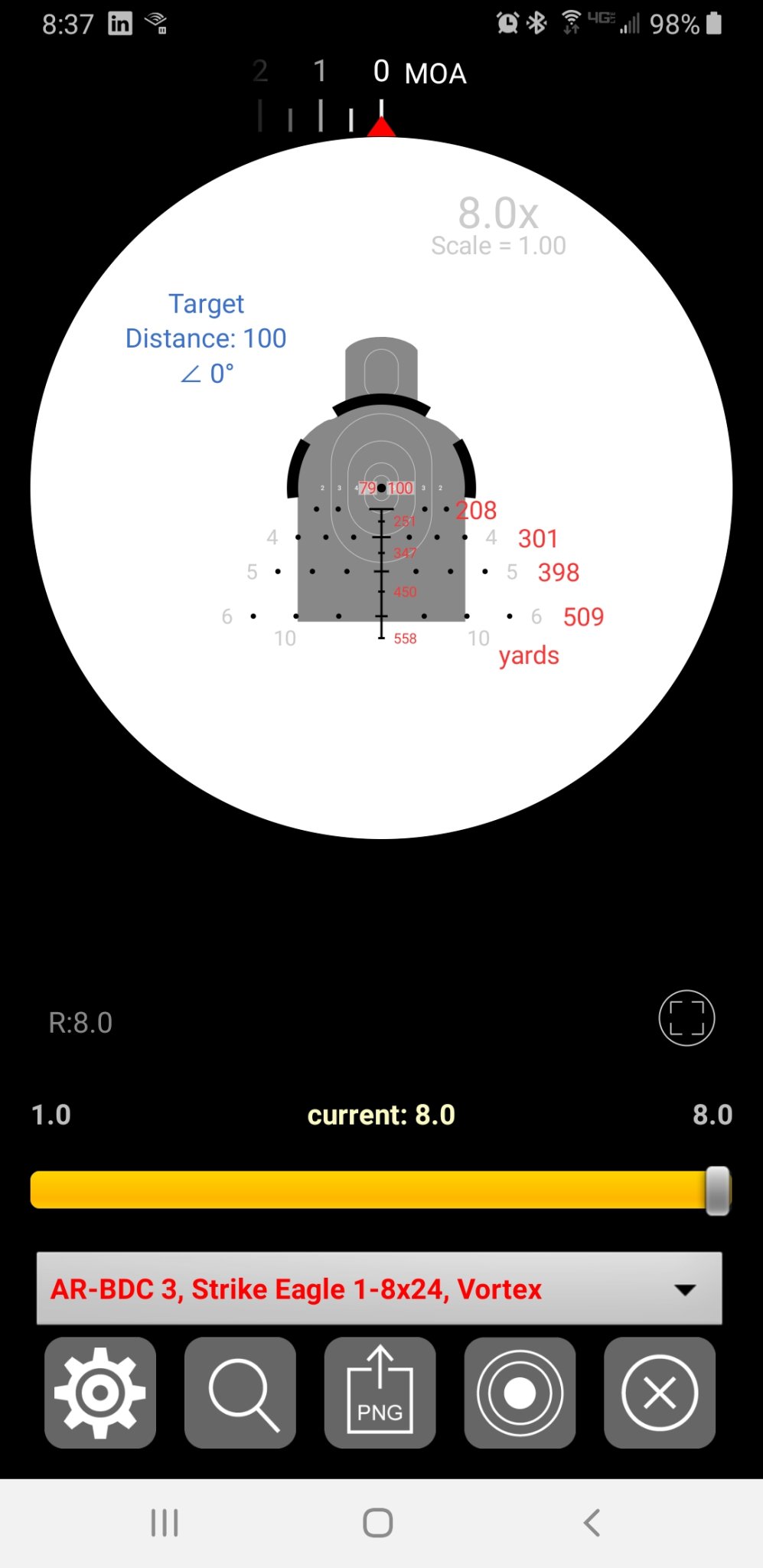

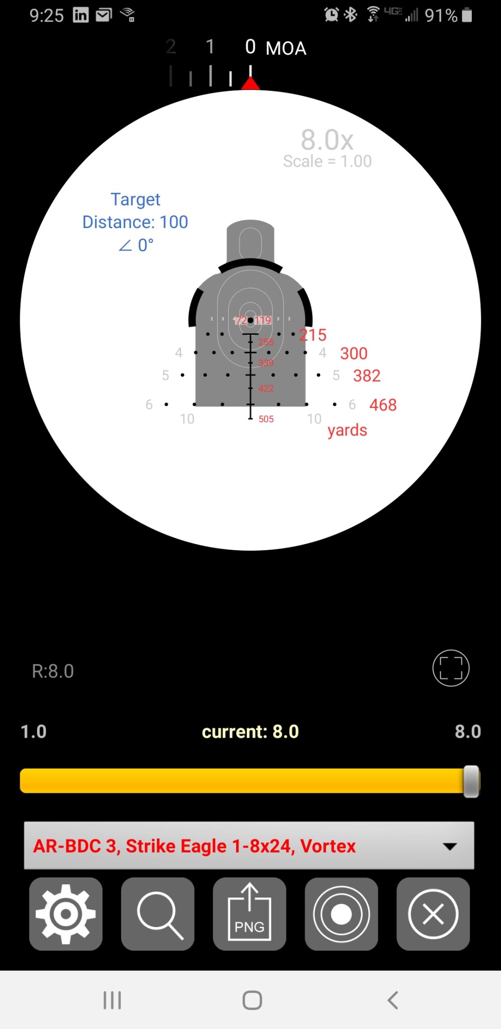

If you have Strelok Pro or simular apps you can play with different reticles and loads. I use BDC reticles off caliber all the time. This is 6.5 Grendel SBR on Vortex Strike Eagle AR-BDC3
