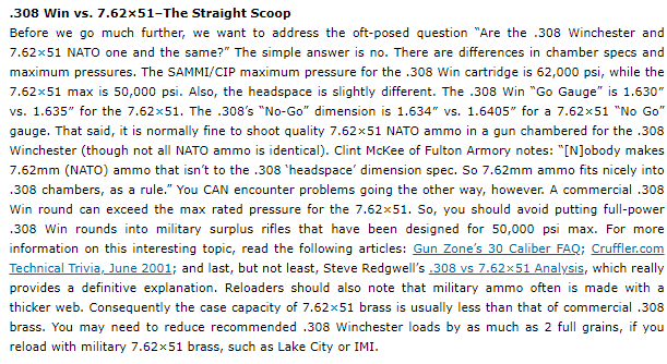

There are slight differences between 7.62 NATO and 308 WIN.
The Service Rifle loads are for the older NATO rifles that use a thicker case and lower pressure than the commercial 308 WIN.
If you are running a modern bolt rifle that is marked 308 WIN, then you can use the regular bolt gun data that is typically shown for a 24" 1:12 bbl.
https://www.accurateshooter.com/cartridge-guides/308win/
Reactions: straightshooter1
I hope @RegionRat won't be offended but the cartridge guide is not totally correct. For instance the pressures 50,000 PSI and 62,000 PSI are not equivalent. The 50,000 is actually CUP (copper unit of pressure) while the 62,000 is PSI as measured by transducer at a different location. But the pressures are different. The Service rifle data is meant to conform to the requirements of the M-14 Service Rifle for which the 7.62x51 NATO cartridge was developed. The rifle is semiautomatic and an upgraded design of the M-1 Garand. The key is protection of the gas operating system of the M-14. There is also a specification for port pressure as the gas port. It is important also for the M-14 to have the correct burn rate so powder selection is limited to prevent overpressure of the gas port. The differences in the chamber are mostly within the tolerances of the 308 Winchester. I'm assuming your AW is an Ai Arctic Warfare rifle which is bolt action and should be capable of handling full 308W pressure.
As for brass there is about 3 gr of H2O difference in capacity when going from Winchester brass to the military brass such as Lake City, PMC, or others which accounts for the comment on military brass. Be careful of Hodgdon data as it is based on the higher capacity Winchester brass.
