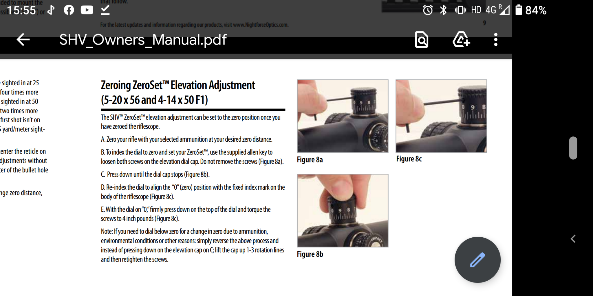

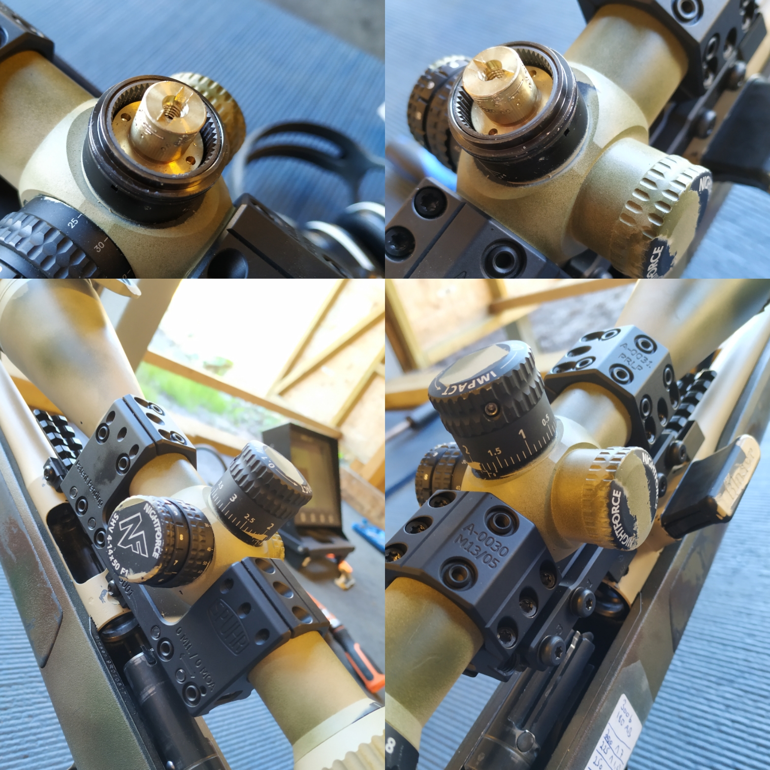

Been unable to re zero my shv 4-14*50 F1 after changing mounts.
I am 7mils high at 50meters and seem to have bottomed out the scope.
I can go 25,5mils up, but unable to go down.

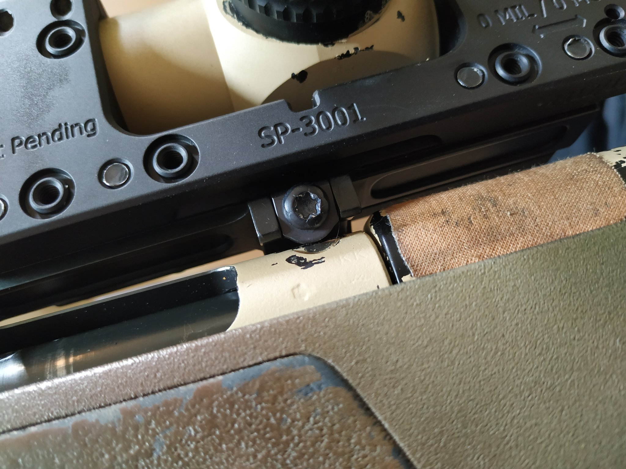

Blaser R93 22lr
Contessa zero tilt rail.
Spuhr sp 3001 no tilt.
Sk std +
When using the blaser saddle mount i was able to zero at 50m.
But could not get correct eye relief.

You only get a total of 27 Mil of adjustment. 13.5 above zero and 13.5 mil below zero. You’re getting a little over 25 mils. Either NF lied about specs or you lost over a mill someplace. Check your zero stop. Hopefully you don’t have something going on with the scope itself isn’t broken.
He's still 5+ mills off if he gets the extra 2.
Something is canted. I'd guess rings and base both have 30moa.

but you still got hold under you can try and use . and there's always using the force you could try not sure it would work but you never know you could be the first . and are you quite sure you did not mount the mount on backwards ?
