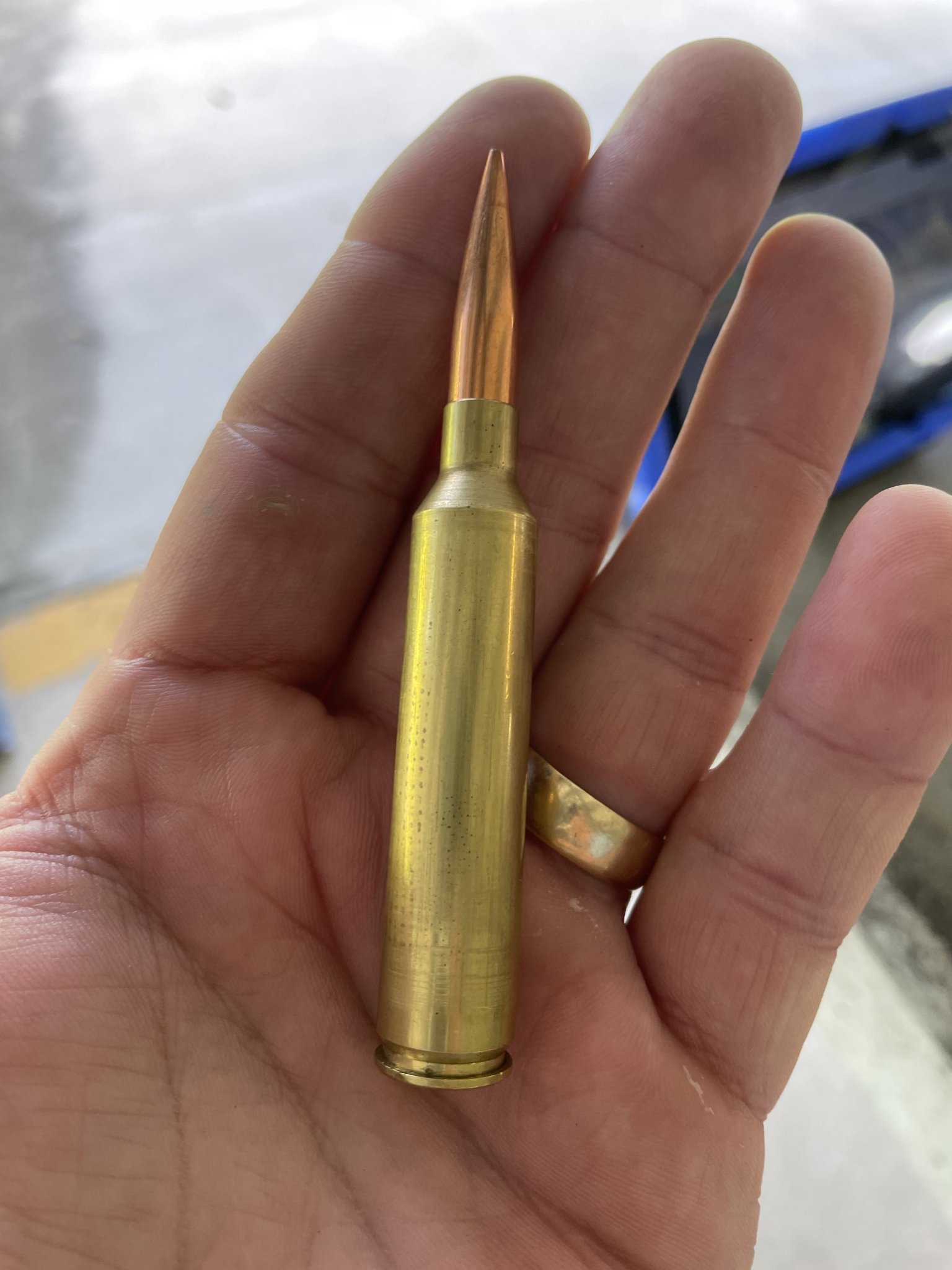

I hope they make look like this. 300 PRC brass with a 195gr Berger on a 7mm barrel
. I shot this rifle 3 weeks ago and its a laser beam at 800 yards
