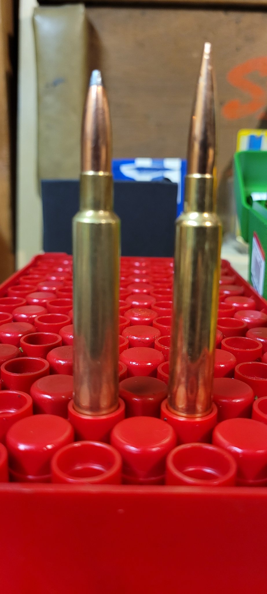

Yes but they are different, look at a reamer print. I just ran a 300 WSM small base die over some SAUM brass - it didn’t even touch the base of the case…
Reactions: FuhQ
The SAAMI cartridges reference has the info you're looking for. The only difference I can see between them is the extractor cut. Body diameter at the base is the same.
I couldn’t care less what they are based on either way, I just don’t want people thinking the two cases are interchangeable…
I never said they were interchangeable, i said they were based on the same case. Which is still true. The 300 ultra Mag is based on the same case, doesn't make it interchangeable with a SAUM. Obviously all the cases we are talking about are longer, shorter, some have different shoulder angles, different neck lengths. When I say they are based on the same cases I'm mostly referring to the base and the rim. The ultra mags, SAUM's and the WSM's have a .550 to .555 base with a rebated rim to fit in standard .534 magnum bolt face. The PRC cases don't have the rebated rim. The rim and the base are both .534 give or take a thousandth.

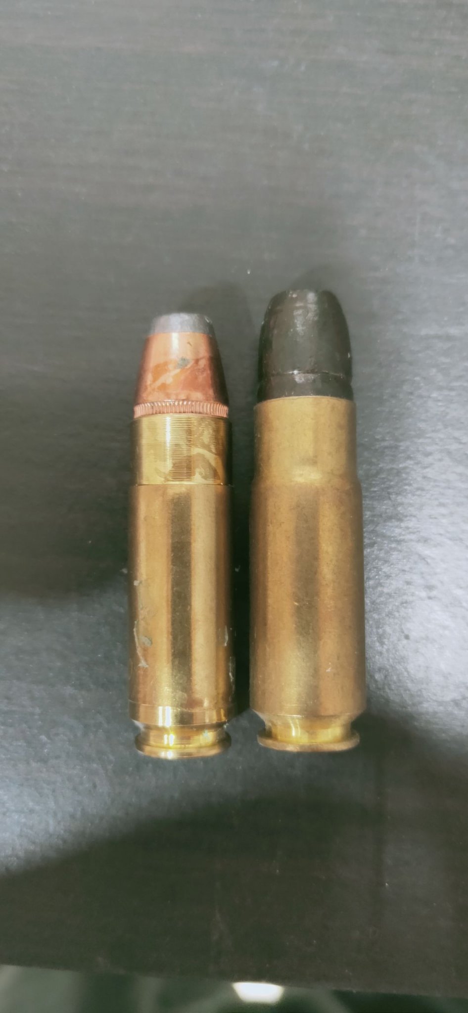

Cant find a fired one. But have done it. They are like 1150fps, 350gr. Very mild. They dont fully form until second firing or 1600+fps.
