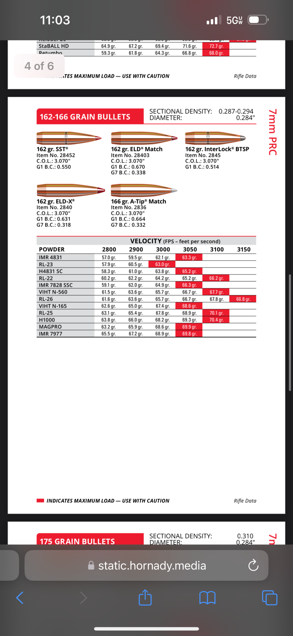

Appreciate the responses! I know hornady says max load is 66 grains which I know you can always go over but I wasn’t sure how high you can go before your crushing powder.
Keep in mind, every chamber is different and I was using standard lr primers. I think you've got some room to go up, just watch primer condition, bolt lift, and watch for ejector swipe. How many rds on barrel?
This says 69
That good to know maybe I misread at 66 so I may have enough room to work it up to a good velocity. I will jump to 66 and run 3 shot groups up from there in half grain increments to make sure I don’t develop Any pressure signs. It’s a brand new gun so 5 rounds haha
