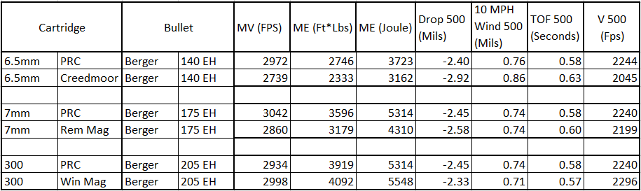

I took some of the info from the gavintoobe review and picked some comparison points for each cartridge, just for fun.
Roughly speaking, the 7 PRC looks pretty efficient on paper. Time will tell if the brass life, barrel life, recoil, etc. all work as good as the math.
It sure looks like they got the case capacity and design length set up right for a good feed and good balance for 175 - 180 class bullets.
Now if we can get all the better brass makers to jump onboard then we will get to see how it turns out. YMMV
