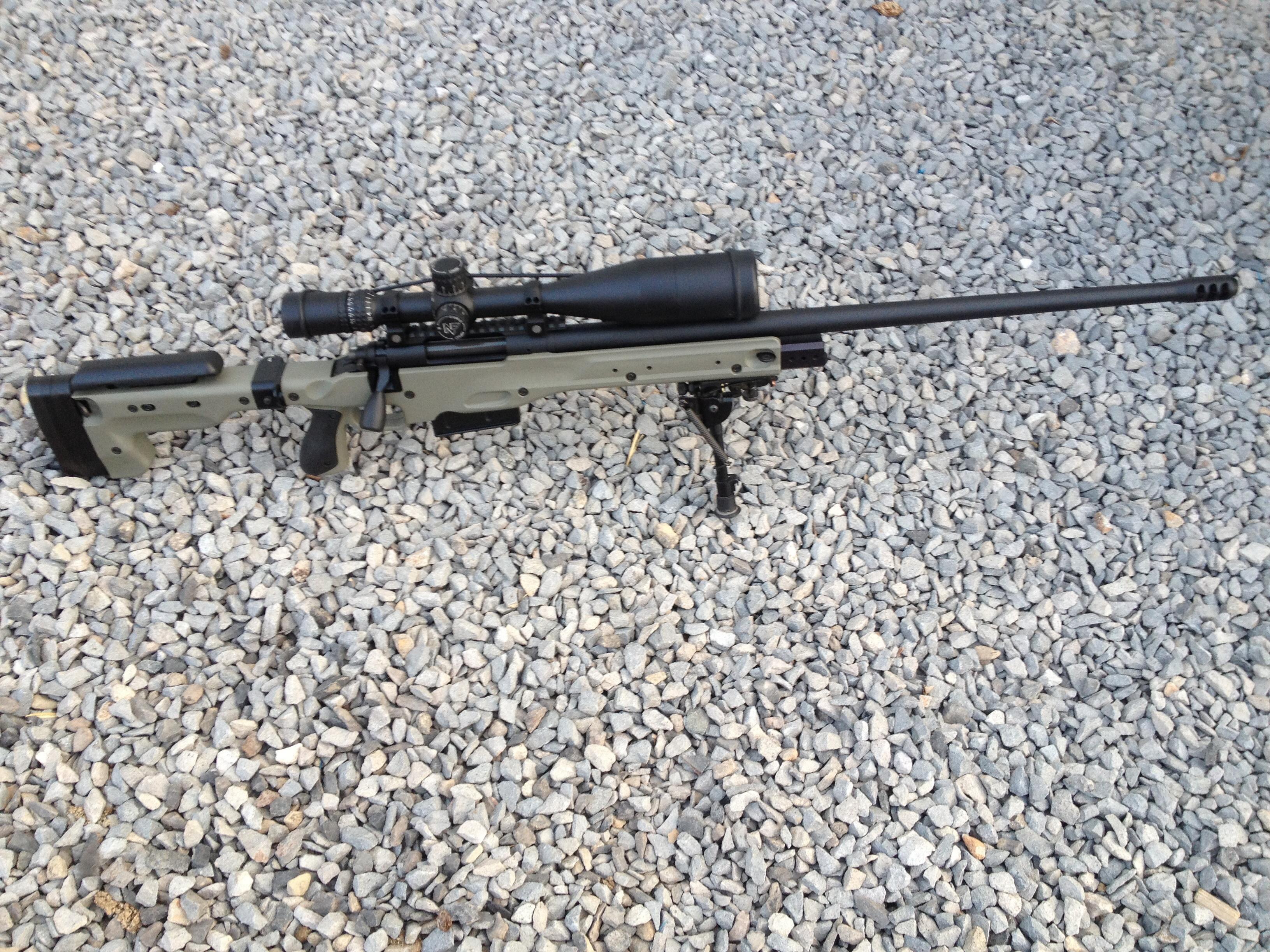

Had this one built for long range by APA.
