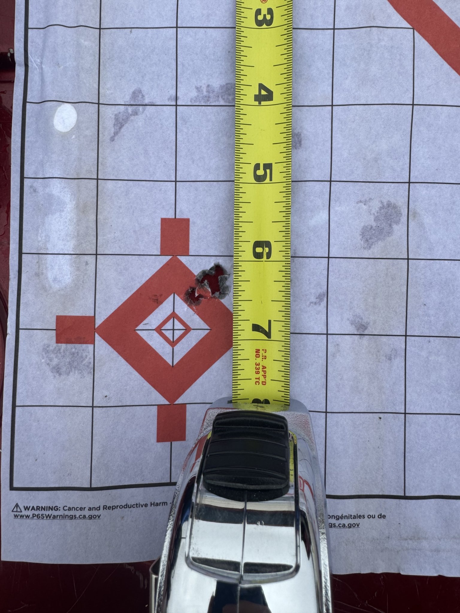

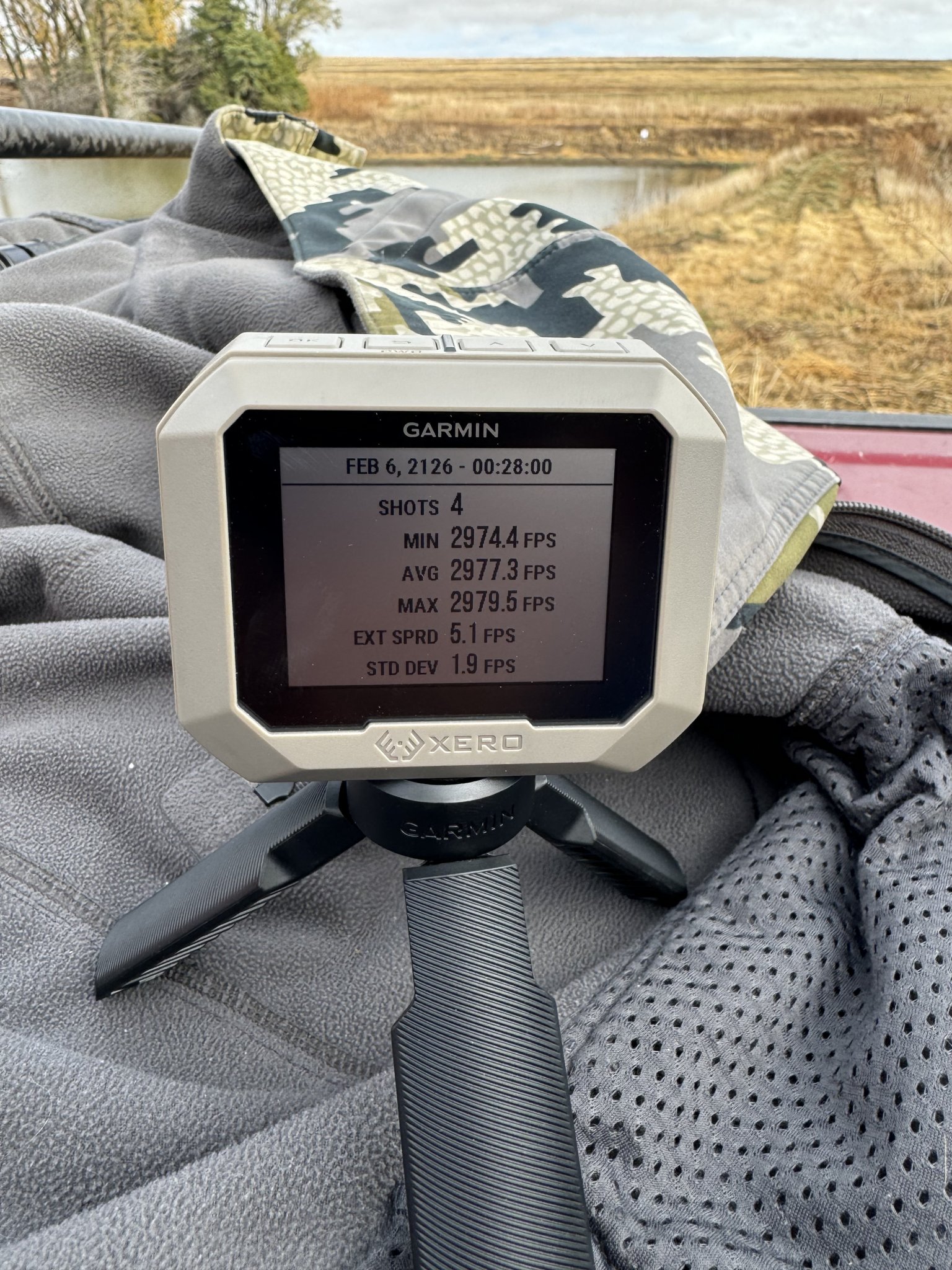

I am not positive but thinking I would go medium if I did it again. I built on a sa a few years ago mainly because I didn’t want the long and the chassis I wanted wasn’t available in medium. I am shooting 168 vld at .030 off and that is basically mag length.
I have a 7 max pushing 190 bergers just under 3000.
In a defiance anti xm action.
Xlr element 4.0 magnesium chassis
Brass dies bullets go with it if interested
Load development done with n570.
