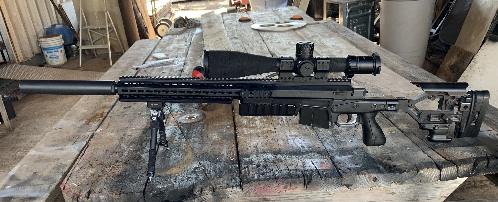

Out of factory deer thug ammo 180’s I’m getting 3064fps in my 18” barrel. I think it’s a very efficient cartridge and now my hunting caliber of choice.
