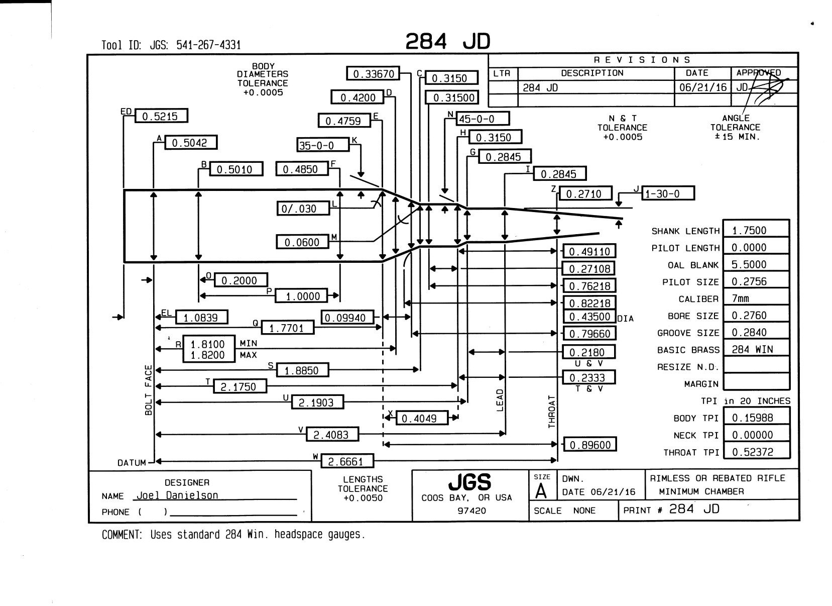

Had JGS build mine as well, and use Lapua brass. More front end work prepping the brass, but what the hell; I'm retired.

Joel, looks like your freebore is .233
Do you like this while using the 180's?
My smith has a reamer with a 220
Freebore is .2180 Your smith's .220 will be fine. The guy that waffle stomped all of us this last weekend used my reamer for his last two barrels, so his opinion is probably worth more than mine. I have found that it has been a good freebore for me on the 3 barrels I have had reamed with it.

Freebore on my JGS reamer is .317 which allows a little room for throat erosion over the life of the barrel while still seating the bullet bearing surface above the neck shoulder junction.
