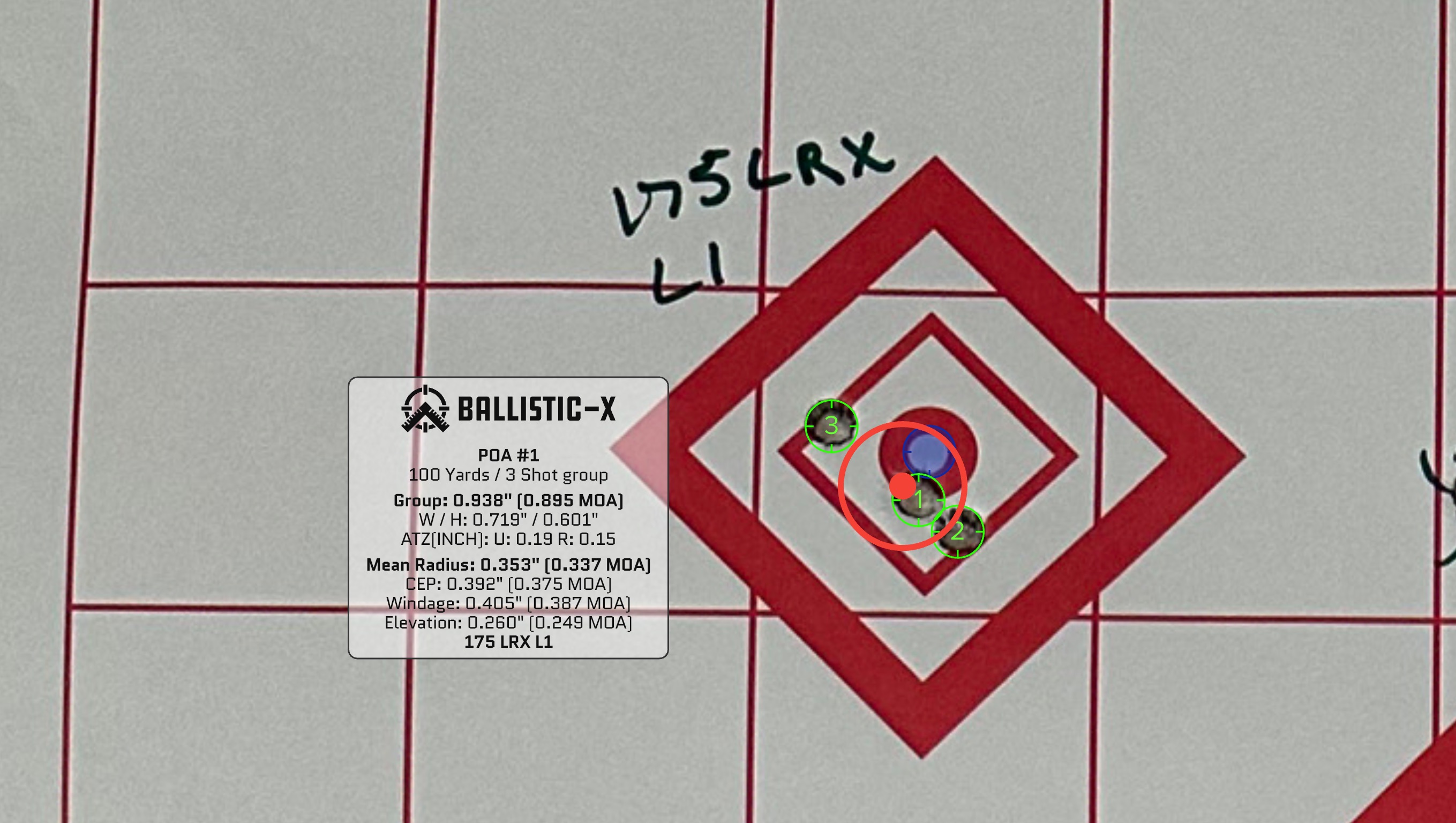

I have some 208 Amax’s I should try them just to see what it’s capable of. The 143 ELDX has shot ridiculously well in three different 6.5 CM’s I’ve shot them in and haven’t been picky load wise either. For elk hunting though, I want a stout bullet. This barrel has a “two close together, one an inch away” problem. Here’s a group I threw together with 175 LRX’s:
