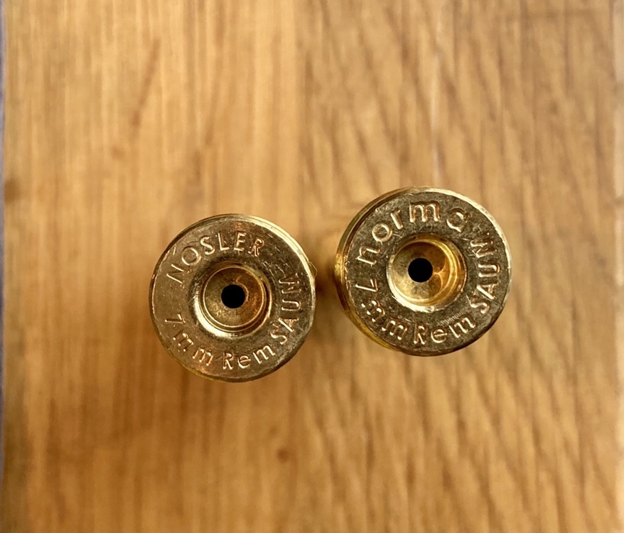

https://www.grafs.com/retail/catalog/product/productId/22561 Norma makes nosler
The cases look very similar to me, they are indistinguishable except headstamp. Same shade of brass even the depth of chamfer is the same. I’m not really a fan of either myself give me ADG any day.

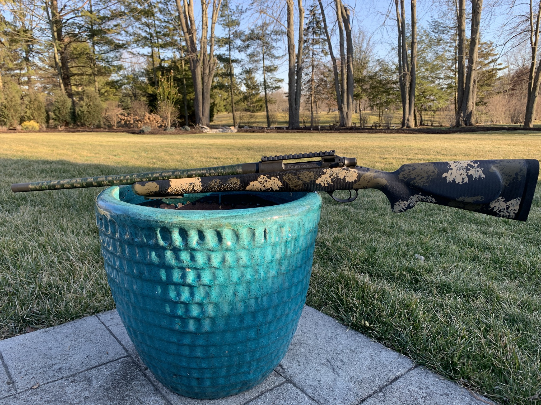

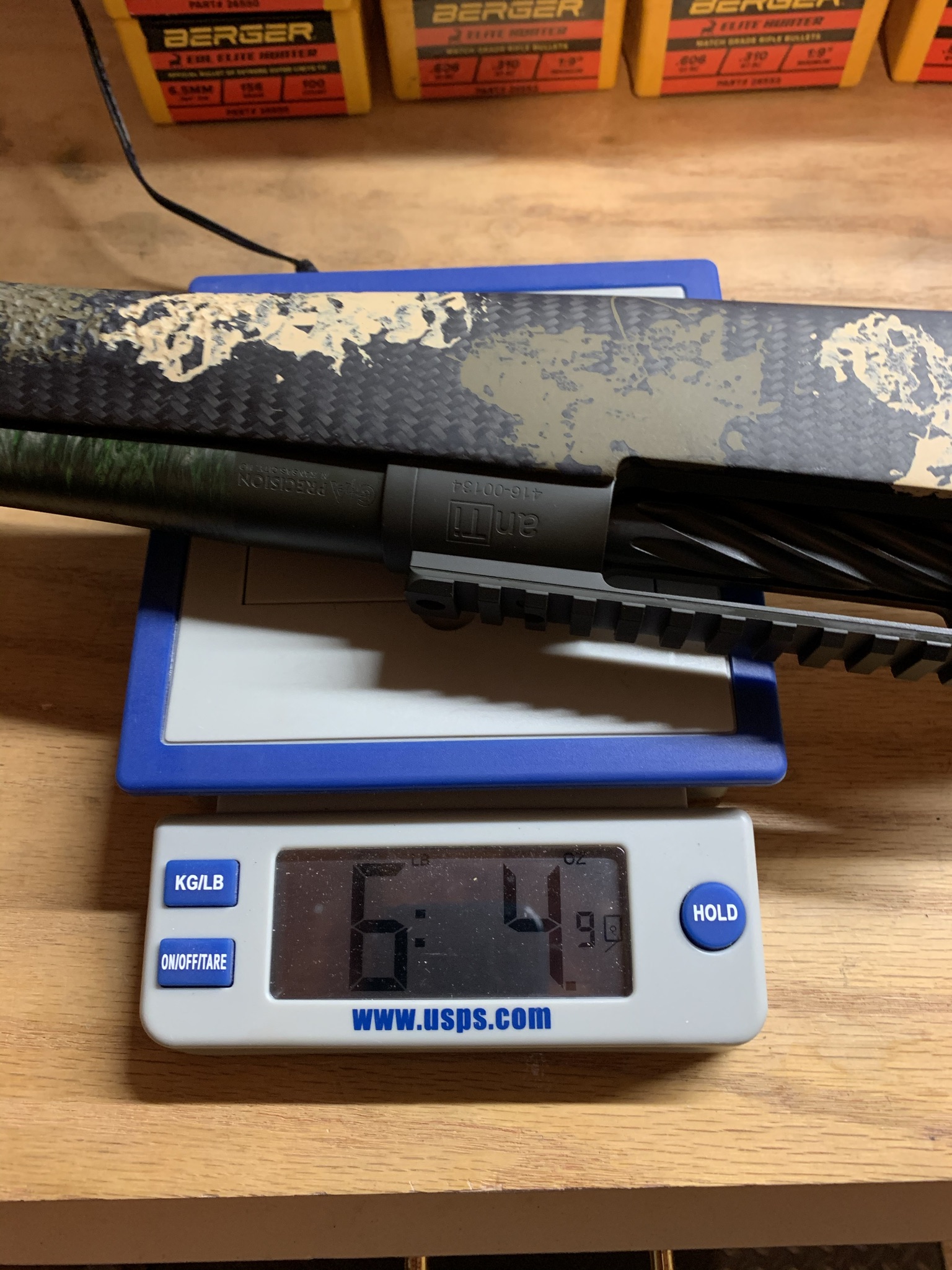

I’ve got a 22” barrel coming that I plan to use as a dedicated hunting barrel. I’ve got some 162 eldx laying around and a decent amount of H4350. It’s obviously not going to wring out the full potential of the cartridge, but what would be a good starting point?
@PFG sure
Defiance anTi XM action
anTi alloy rail
Defiance XM alloy BDL
Bartlein #4 CFW 22” 8.5 twist, asked them to shorten the shank by 1/2“ so to finish at 21.5”
threaded 5/8x24 with TBAC CB
Manners EH-SL stock
will use the ultra 7 until my Dominus gets out of jail.
load will be the 175 elite hunter over R23 in ADG brass. Tula LRM primers. Been sourcing the components since last summer and I’m ready to spend the summer getting ready for elk this fall!

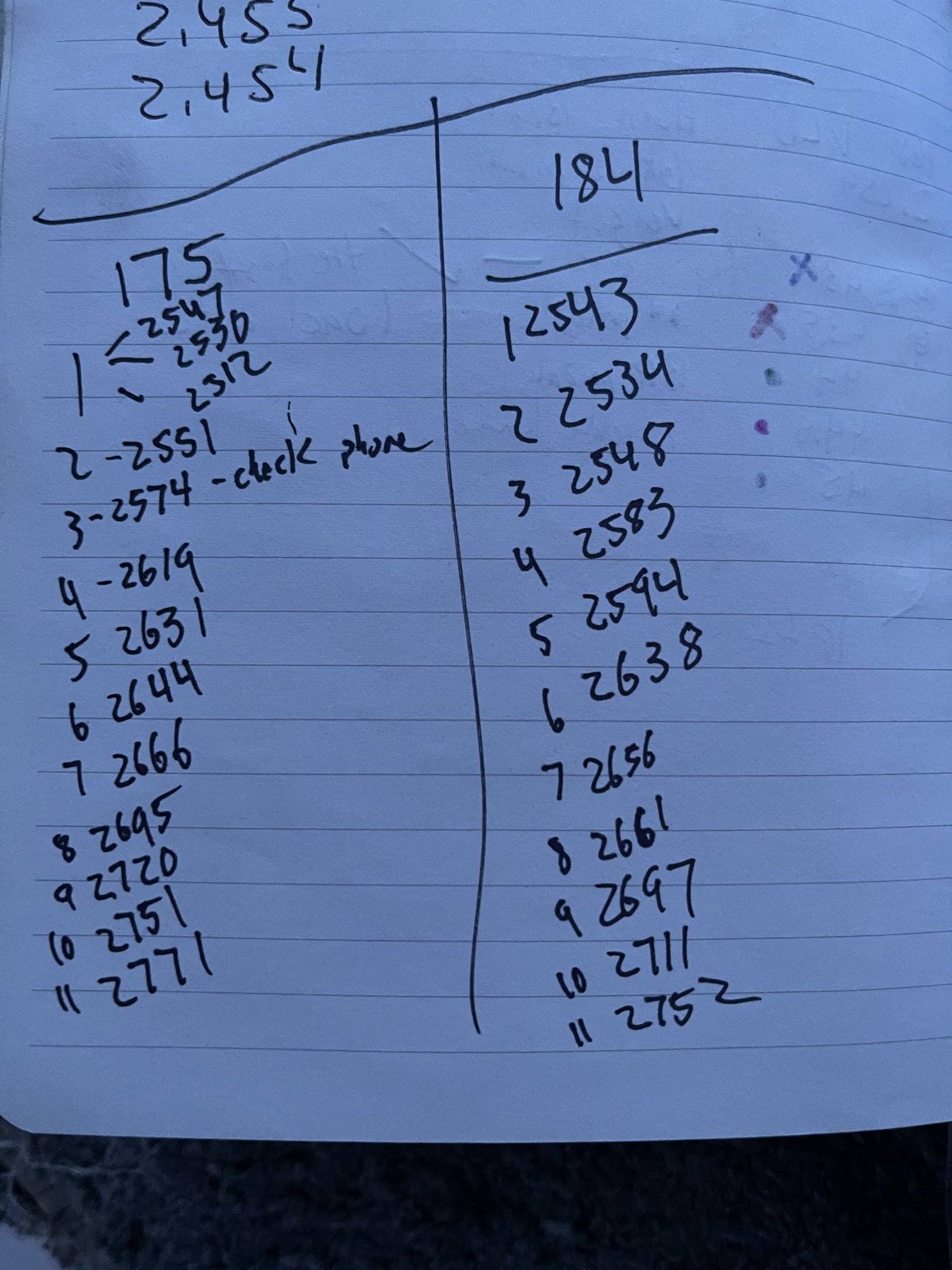

Digging this up again... anybody played with N565? I have a pile of it, N570, and RL26. 565 has been good to me in the past so that is what I’m trying first. Ran a ladder test to see where i would find pressure. 59-64 grains with 175 Berger and 184 Berger... didn’t get any signs at all. 22” barrel on a loan peak LA, .210 freebore. Figured i would start seeing something around 63 grains... nothing. Loaded 2.400 CBTO. I am sure the barrel will speed up another 70 FPS after break in but i wouldn’t mind knowing where pressure starts.

I didn’t see pressure until maybe 2840 FPS with a fresh long throated 22” hells canyon carbon with h1000 and 175 eldx
Did you ever continue on this route? I have an 8 twist 7 saum for a long action TL3 on the way. I have quite a bit of n565 and H1000, want to run the 180 eldms 175 EOL’s or the 180 bergers wondering what to start with
I started way low and worked up. Probably too low. Started at 57 grains and didn’t see a slightly heavier bolt lift until 67.5 and 2940 FPS with both 175 Berger and 184 Berger. All with N565. Depending on what freebore you go with, my case was dang near full. I think you’d be safe to start at 62 grains.

N565 is almost identical to R26 and R26 is my preferred powder for 180 and above bullets especially in a standard freebore.
In a long action especially with a longer freebore H1000 is absolutely a solid choice as well but you’ll be burning about 4-5 more grains to get similar speeds.
