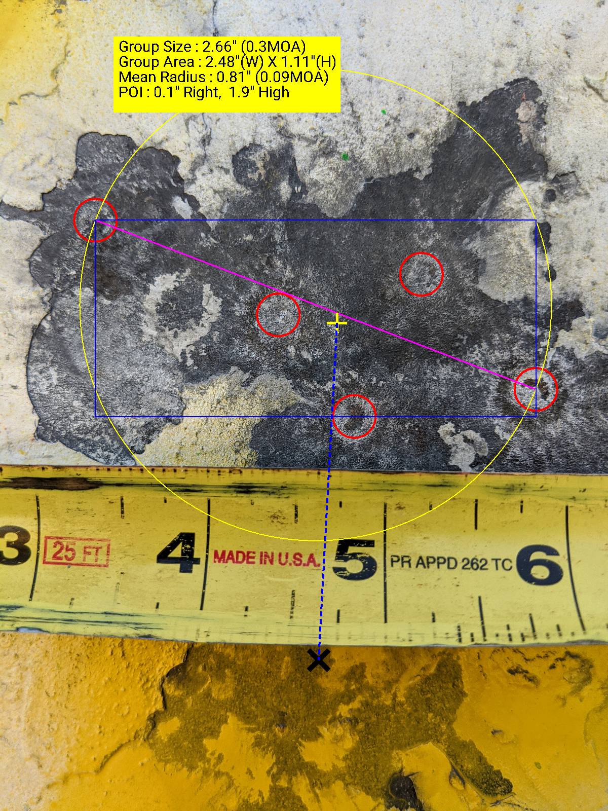

Oh and I'll add the GT barrel i got from impact is shooting
VERY well
Shot this group at
844 yd last week

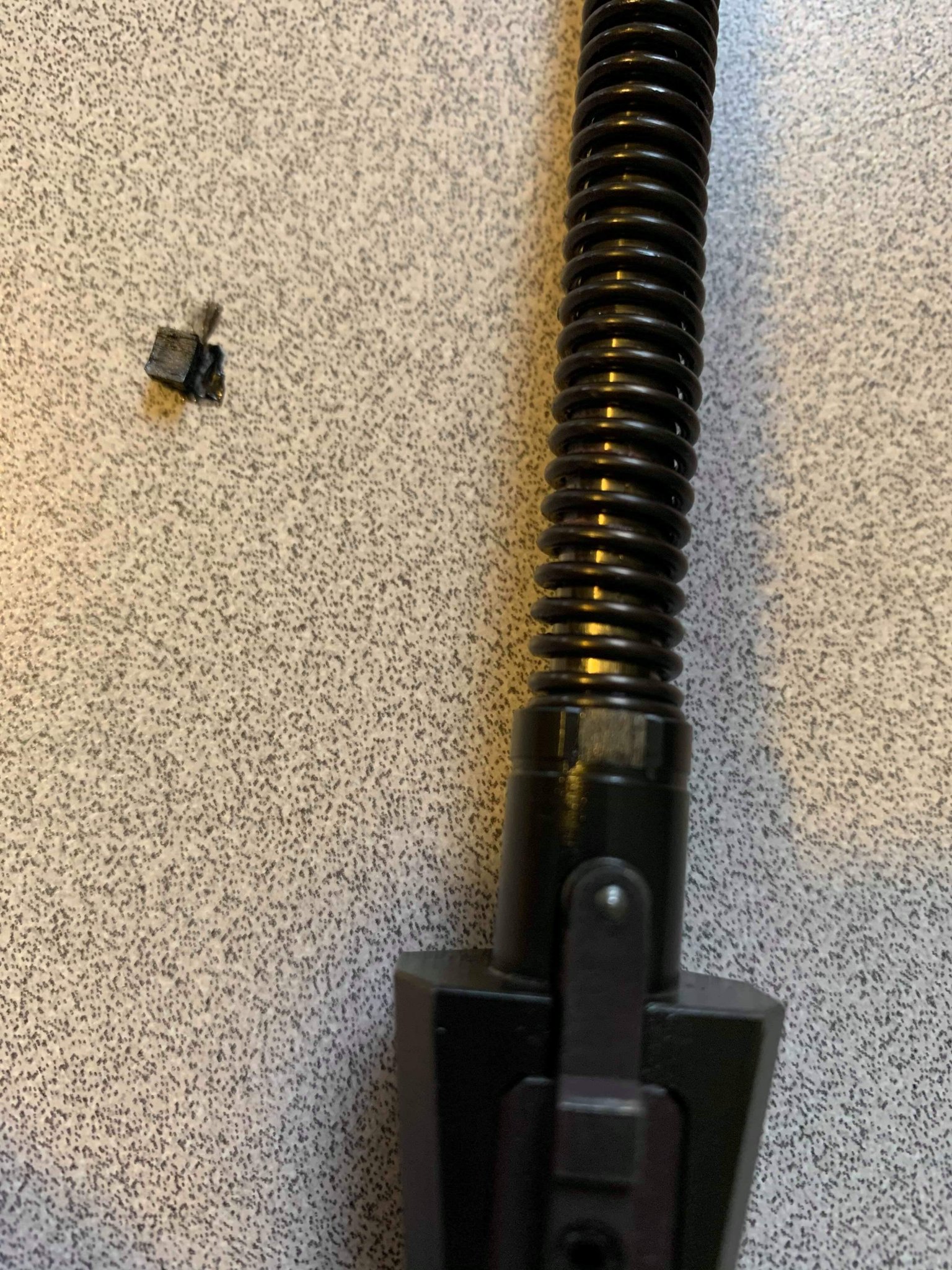

As fond of my impact as i am I'll agree that a twist lock firing pin assembly would be a plus!
Just remember when a primer ruptures, that shroud is what's between your eyeball and a firing pin being driven backwards by 60k psi of gas.
The picture is of a shroud held in (well, was anyway) by a single twist lock lug.
I'll keep my Impacts with the threaded shrouds, Thanks.
Did the lug not prevent injury? It may have been sheered off, but did the pin injure the shooter?

That single lug looks a little on the small side though, the above mentioned actions use (or used to use) pretty stout double lugs.
The shooter was fine. The lug broke under normal use. I don't know what would have happened if a primer had ruptured while it was compromised, but I can only assume it wouldn't have been good.
I'm sure there are adequate ways to design a twist lock shroud. I only brought it up to bring attention to the fact that sometimes simple and robust are indeed better than convenient, and the reasons for choosing one over the other aren't always as apparent as they may seem.
That has me feeling slightly warm and fuzzy with my threaded Nuke.
