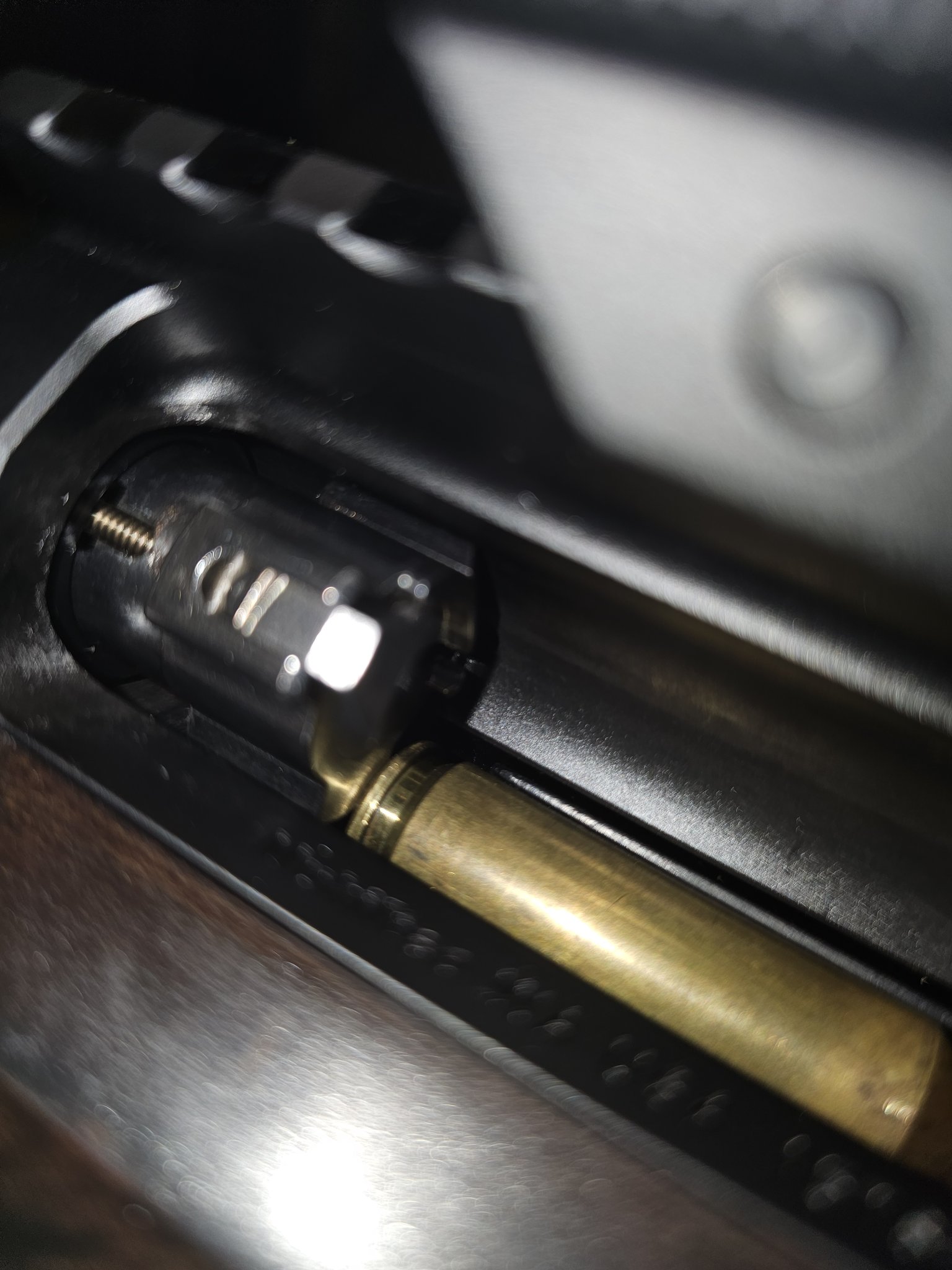

cdg pic
I think the CDG is the coolest action out right now. stupid light bolt lift after I replaced the spring.
so light it might not work, idk.
