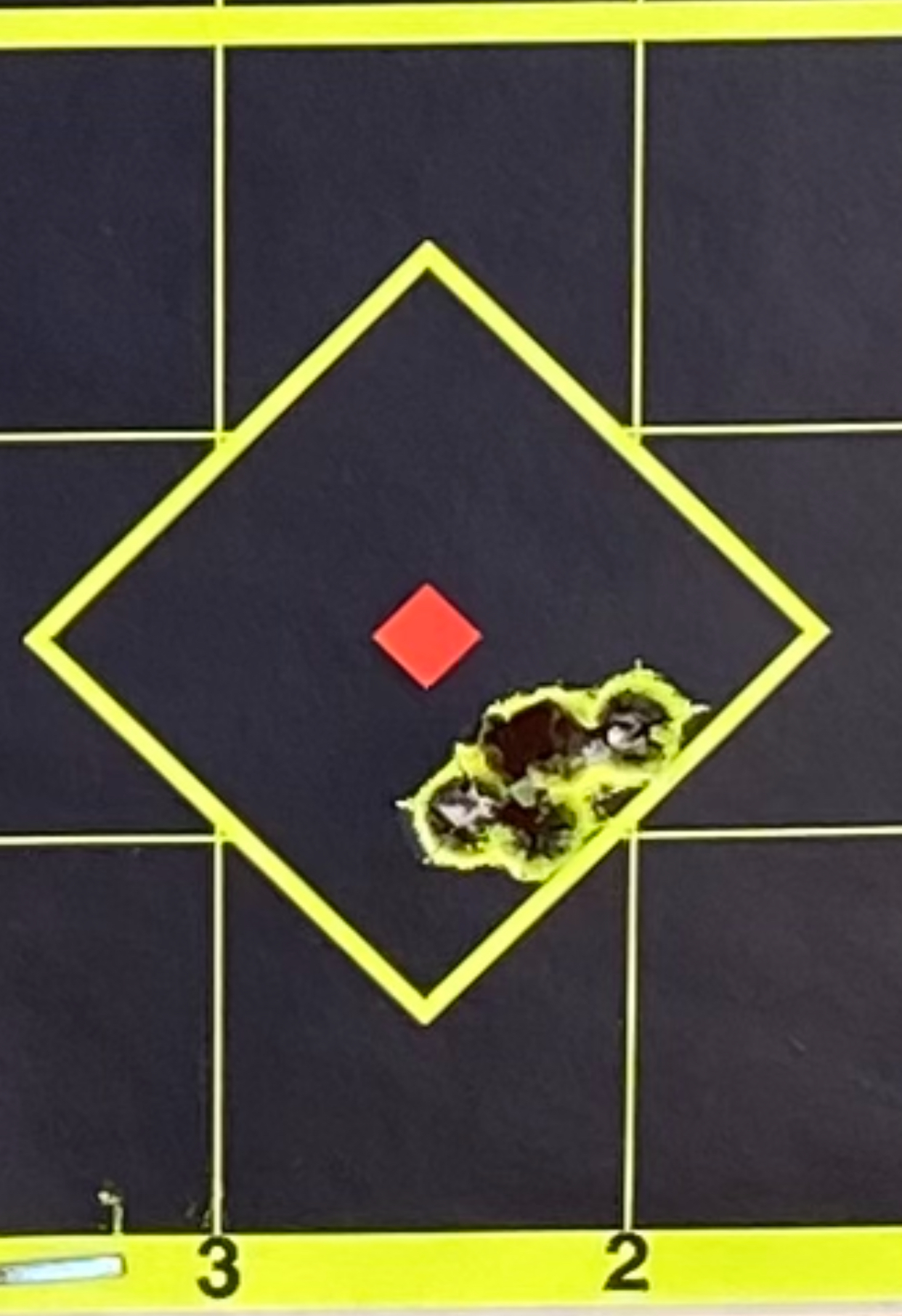

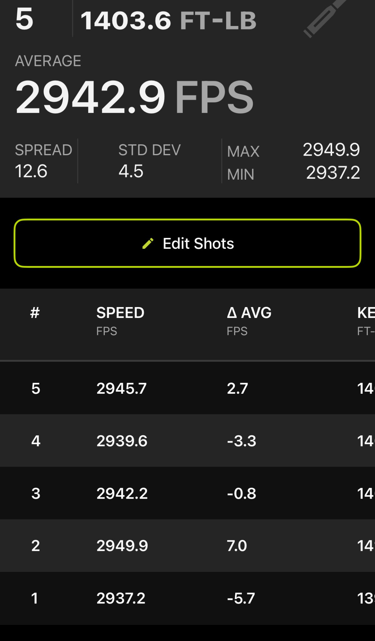

    Padom, still 1.824 CBTOL or did you find a better seating depth?
    Nope that's what shoots tight in my Ultramatch.
    These are picky bullets... they don't shoot great in every one of my AR's.
    This is what I got from a 1.826” CBTOL, 23.9 grains of ARCOMP in new LC brass with FED215M primer
