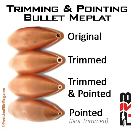

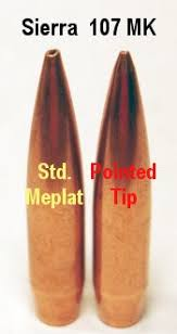

    You can try a Whidden tip uniforming and trimming tool. You gain better consistency at the cost of a little drag -- maybe requiring a quarter minute more elevation than non-uniformed bullets.

    On the modifying these bullets, I think I will be fine inside 600 yds without messing around with the tips. Great info I appreciate it!
