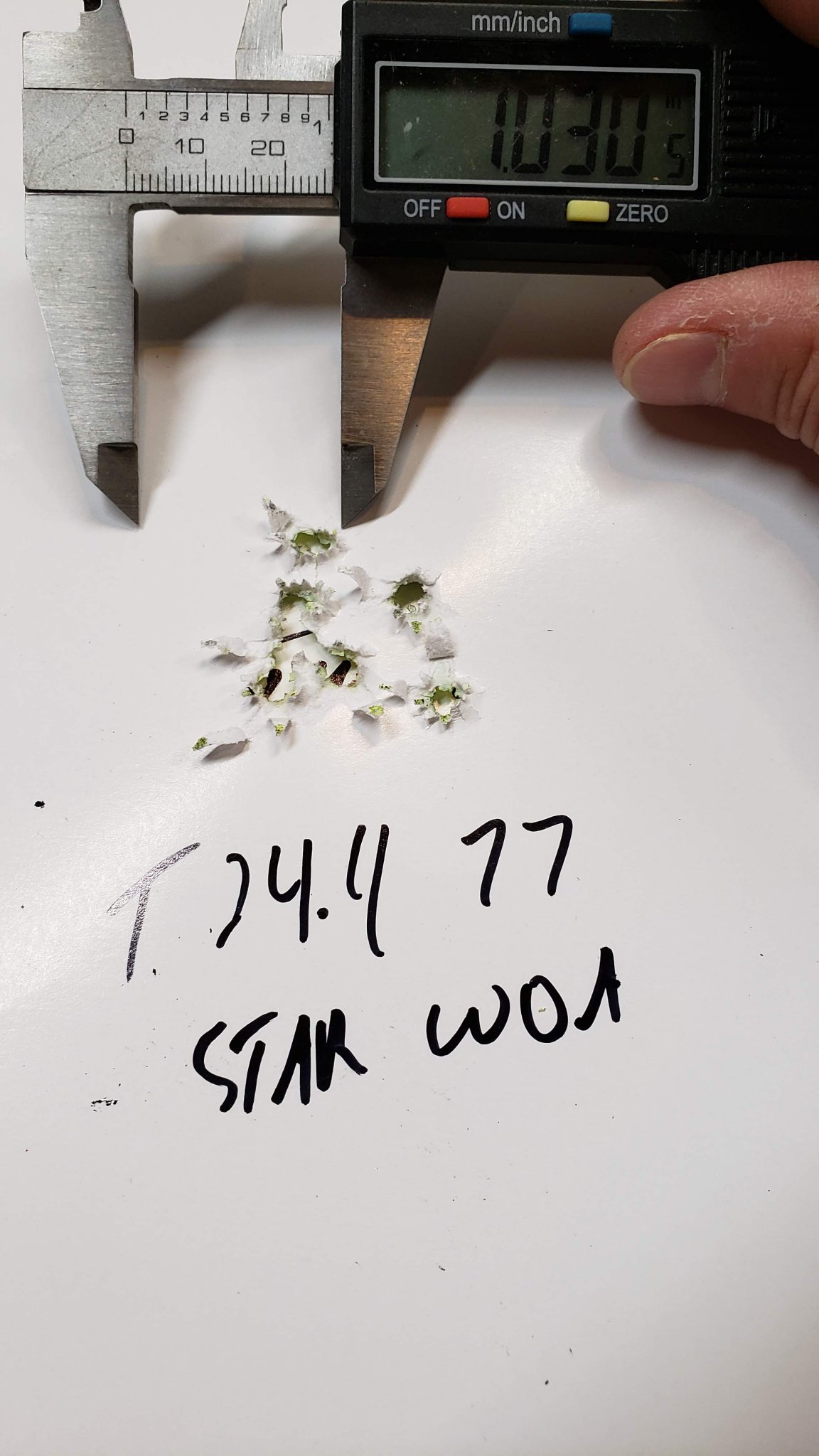

So its not an SPR/1:7 but I do have an 18" WOA 1:8 twist. My favorite 77SMK load is 24.4gr of TAC which clocks in at a MV of 2751 with an SD of 5.4. Just a hair over MOA but also probably not my best shooting
