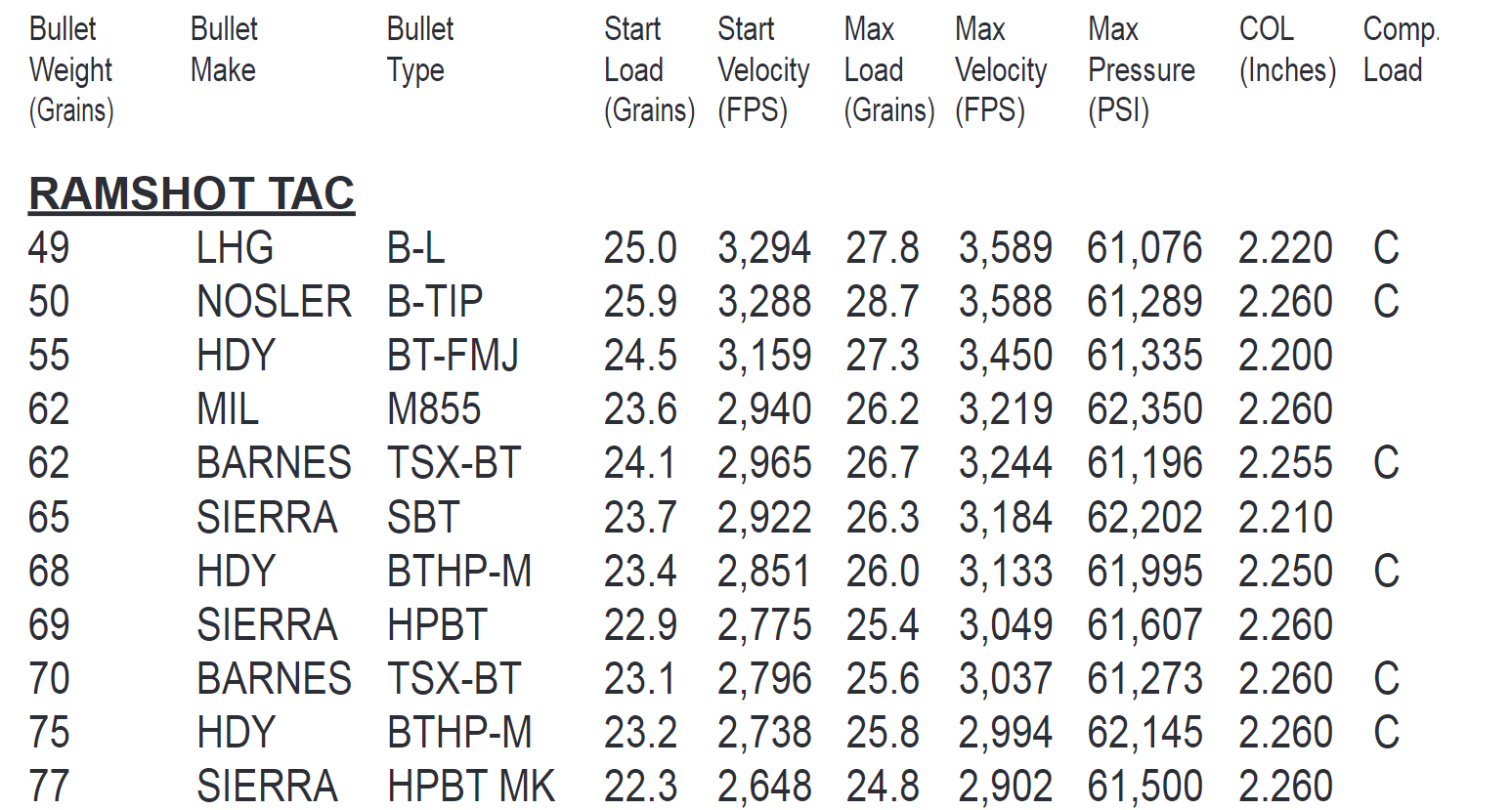

I have a 13" gun with a mid length gas. It shoots 75g HPBT at 2,691 fps. They are loaded with 24.7g of TAC being ignited with CCI41. Ramshot lists load data for 5.56 pressures and this load is well below max.
Reactions: Chicory01 and XP1K
