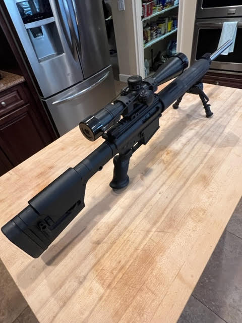

When I built my 7mm-08 AR-10 I had X-Caliber build my barrel. Not saying that McGowen is better or worse, but that's what I bought. I ordered a 20" 8 twist heavy contour starting at the receiver with a 1.150, tapering through .950 to a .750 gas block and maintaining that size through to the threads. Rifle length gas system. Shoots pretty good, but believe you me - its heavy! Would be heavy even with 2 inches of barrel cut off the end, too. Hardest part of dealing with the AR-10 build for me was the load development. Since it's no bolt gun, your charge with be effecting more of the mechanics, so your tuning not only for group size and S.D. but to make sure you can cycle reliably, too.
Reactions: TACC
Interesting, good to see someone else who's built this caliber. I think it's the ideal bullet diameter for the 308 case, pretty close ballistically to 6.5 but with more punch.
That's a fast twist what bullets are you running? Saw the 180gr eld-m that needs like 8.5" twist but wasn't sure if 180gr in a 7mm-08 is even worth it. Great bc though. I'm very curious what loads you're running.
160 gr. Sierra TMKs. I load them pretty hot - CCI BR-2's lighting 44.5 gr. of H4350 gets me to a MV of 2,698 and reliable cycling. This is a compressed load, so be very careful and work up if you decide to try it. But I stay supersonic through 1,400 yards, so that's good...
Interesting, good to see someone else who's built this caliber. I think it's the ideal bullet diameter for the 308 case, pretty close ballistically to 6.5 but with more punch.That's a fast twist what bullets are you running? Saw the 180gr eld-m that needs like 8.5" twist but wasn't sure if 180gr in a 7mm-08 is even worth it. Great bc though. I'm very curious what loads you're running.

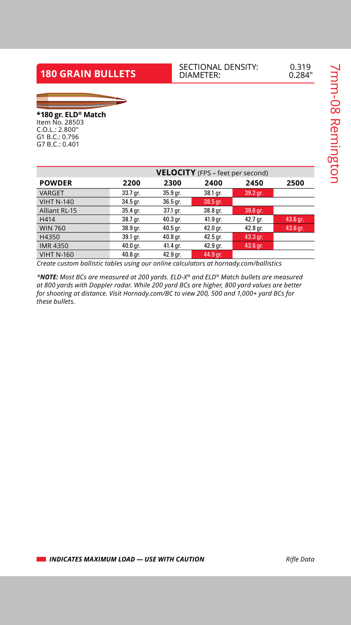

For sure, a lot of factors. Here's the Hornady data I was going off of and by my math it miiiight keep me supersonic past 1600 although there's a crap ton of drop. It just seems like very few people have even tried messing with 180s in 7mm-08.

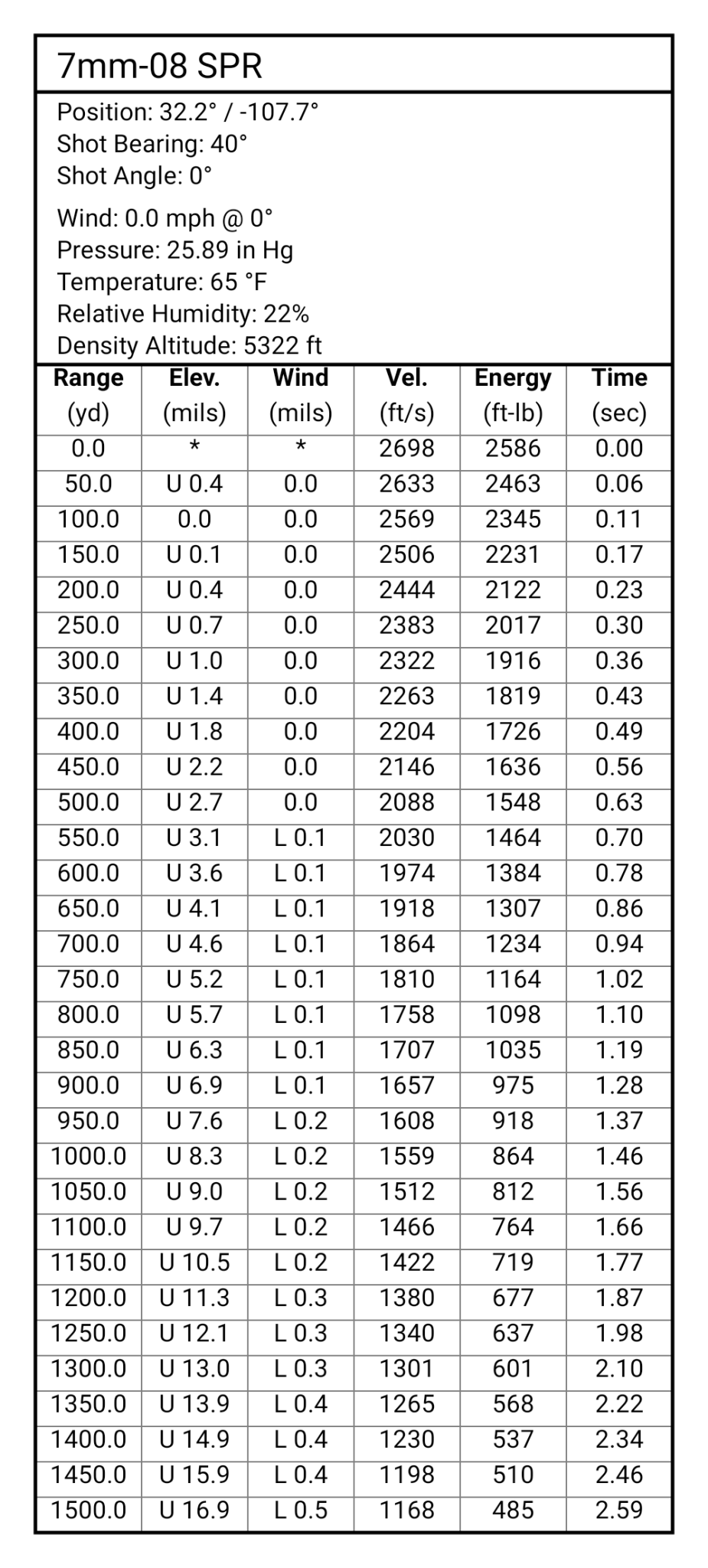

Without knowing your environmental conditions, its difficult to confirm, but it may be possible this summer when you get the barrel. I ran the numbers through 4DOF (see attached) using current weather in A place in MO where I used to live and based solely on that your 1,600 number is a bit optimistic. Currently you'll enter transonic around 1,050ft. That's assuming you get the full 2500fps MV, out of a 8.5 twist with no wind. Again, that's all assuming you have the same environmentals that I used. It could be way better.
Interesting, I'd be interested to see the data from the load you're running. I ordered the barrel by the way but it's like a 3 month production time but I'll definitely post back here when I get it done and take it out. Ordered most of the other parts I needed yesterday straight from aero they had a huge new years sale, so I'll be ready to go when I get the barrel in.

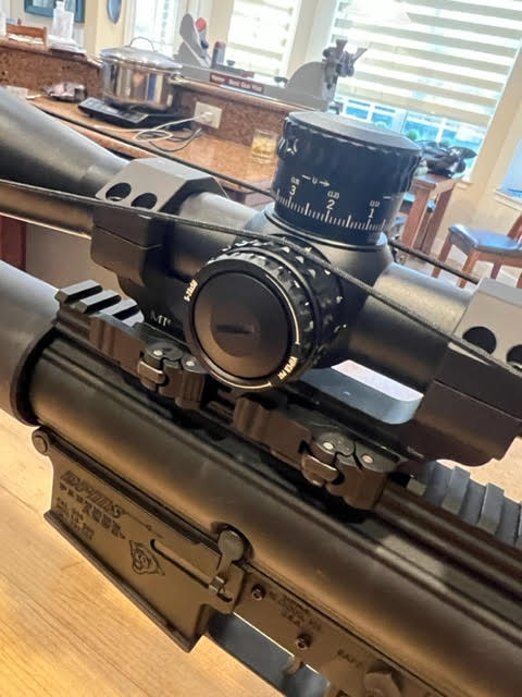

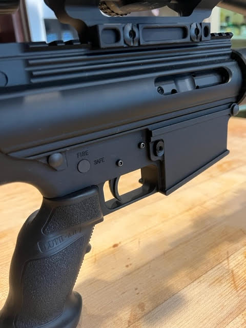

Long time lurker here but finally made an account, should've done it a long time ago lol. So I'm building an aero m5 in 7mm-08 and can't decide on barrel profile and gas block size. I've decided to go with an 18" because I want something that's not too unwieldy so I can carry it for hogs but also want to use it to play around and shoot at some steel at 1000+ yards without it stringing shots. Any suggestions? Thanks in advance!
Ps. Also, does rifle length gas usually work OK for an 18" tube? Not sure how much it being 7mm affects that, I know it's an oddball caliber in the ar world

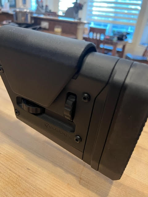

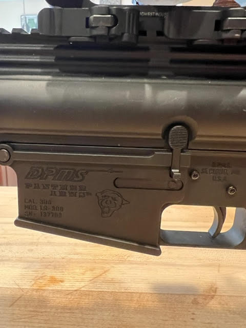

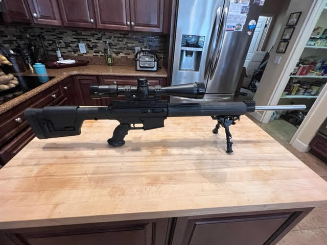

Gotta be the heaviest you can carry. for target i have a dpms gen 1 and a real one. it was subminute from the factory with 24" full bull barrel, but once setup and loaded its a 19lb gun. they did have them in 20"too, but thing is anthing not on the heavy side burns up in 10 shots, then has to cool an hour. you haven't seen stupidity than a clown that spent $14000 on an AI 6.5 and decided to havae a truly superior sniper rifle it needed some insane 2400 dollar carbon barrel, and he got six shot out of it, 3 wasted at only 300 yards.
pop for a 20" heavy, a lightweight carbine stock, and it will work. DPMS is back in the act taken over by PSA, they have the site back up although not sure if it will retain its eccentric designs, or lose its name into a budget PSA derivaive.
That rifle sure looks familiar. It's the same one posted by ebbiv/Paradox in post #13 of this thread about 9 months ago. Did you open up a new account?
Large Frame Rifle Weights
