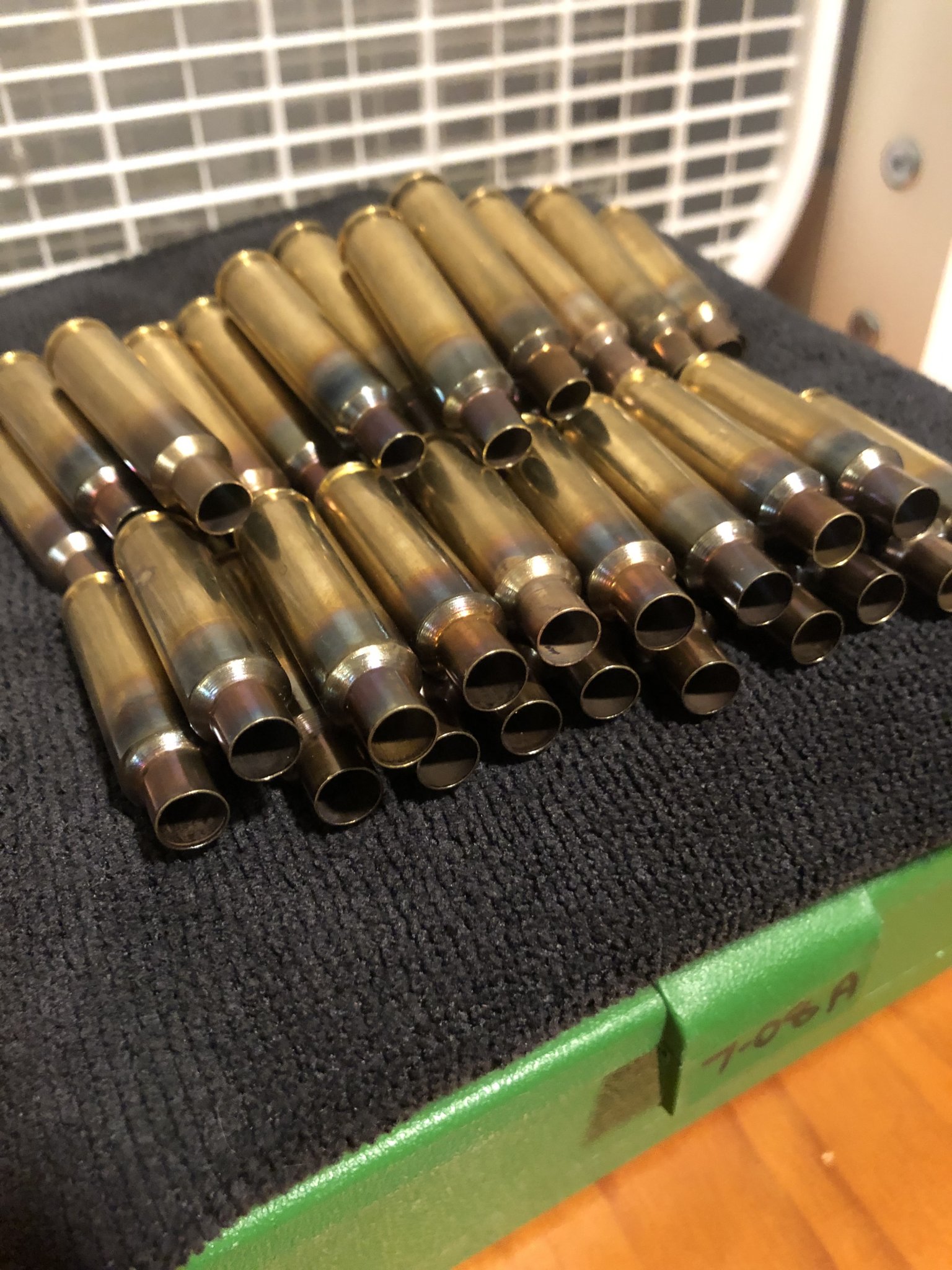

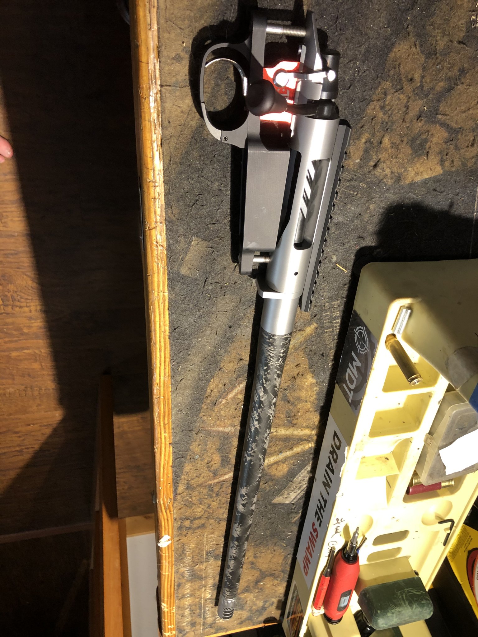

A 7-08 AI makes the -08 case go OHwwww geeezsss THANKS
20” proof pushes 162 Elds at 2750.
24” pushed 162 elds at 2875
And the new one with a 22” proof is waiting for manners to finish her handle!
My wife is on her second 7-08 ai barrel and won’t shoot any thing else. All hunting with above. Were I to play sniper in a nascar looking fire suit. I would feel the 6.5 creed a little more recoil than desired. I’d be GT or dasher slut.
View attachment 7485882View attachment 7485895View attachment 7485896
That Ackleyized 708 case just looks like a shooter
